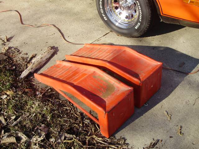

Got a surprise today, 2 actually, first one, went to get my Carburetor today from a private owner, and as if I didn't get a great deal to begin with, he tosses in 2 free ramps.

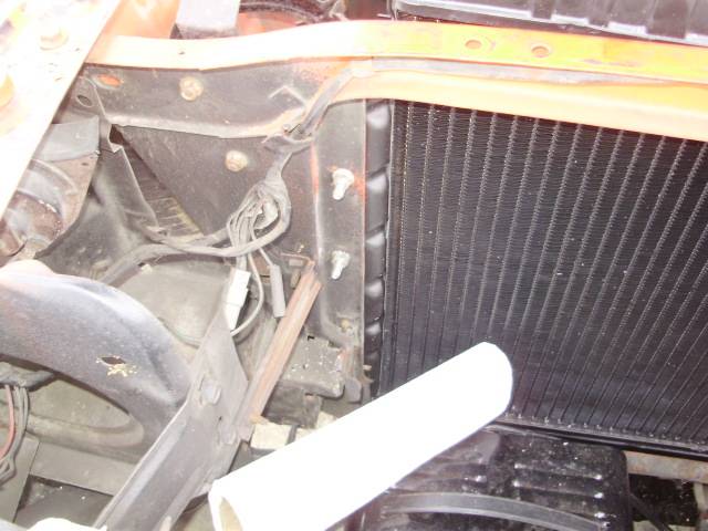

second surprise, a radiator for a 73 Charger isn't the same as one from a 72. My 72 is an AC car(currently AC delete), and the radiator new in the box, looks almost identical to mine, but, it's an inch and a half longer and the same taller, but all the paperwork clearly states for a 73 Charger, an oem radiator, not some aluminum aftermarket. No problems, I don't mind the benefits from a larger radiator, just had to modify the mounting points slightly, plenty of room, hoses tranny lines all match up nicely.
not my choice of fan(PO's doing), I have an oem one, just need to pick up a clutch assy for it.
Shroud is now a little too short, so I'll be on the hunt for one in the future, or I may mod mine.

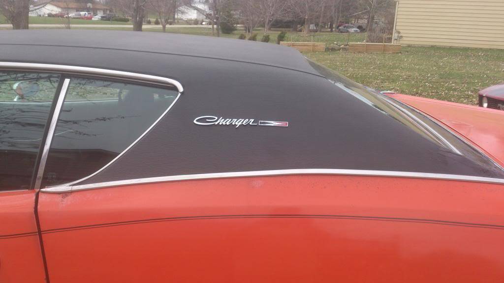

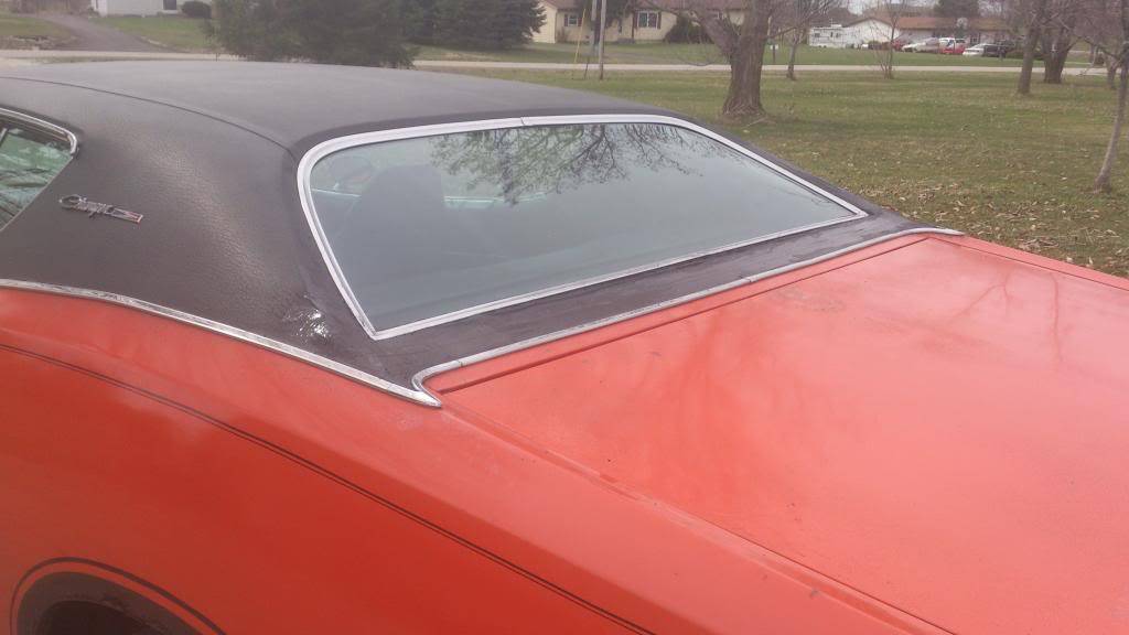

Peeled away the tape job the PO did on the rear section of vinyl roof below the rear window, the temporary job wasn't cutting it anymore...YUCK, got some work ahead of me in the near future, but, for now, needs another temporary repair, cut away the deteriorated vinyl, brushed away all the loose rust, applied black duct tape, amazingly similar to the actual vinyl roof in texture, then added a bead of black silicone to prevent water from getting in my trunk and rusting it any more. It will be repaired this summer!!!!

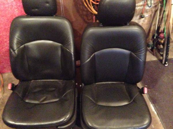

Then it will be off to the interior, need new carpet, still looking for a drivers arm rest pad(bought the wrong one) I also have some temporary seats to go in, I removing the two front buckets for repair/restoration, I"m going to re-upholster the drivers side, maybe add some foam to both seats to give them back their original shape and some more comfort, these are whats going in in the meantime;
nice damage free leather seats with drivers side a power seat, hopefully I don't get too comfy in them and put off the oem seats :)
