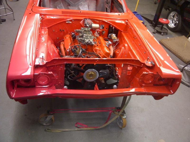

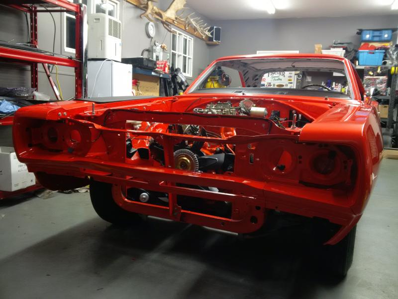

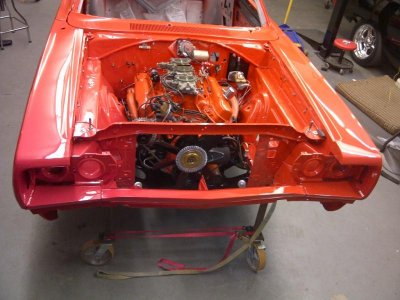

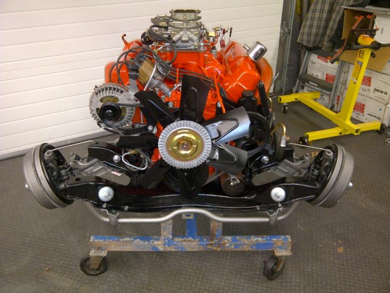

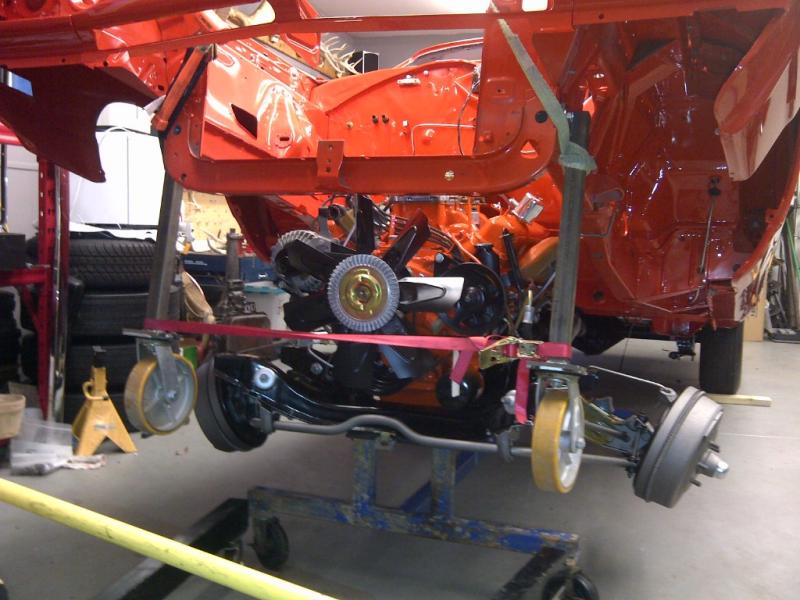

Got a little more done in the past week--have to cut me some slack on the fan clutch-- have to do till I can find a stock replacement?IMG-20131110-01176.jpgIMG-20131110-01177.jpgIMG-20131110-01178.jpgIMG-20131110-01179.jpgIMG-20131111-01189.jpg
Pretty sure the sway bars originally were in as is metal finish as I have seen on some survivor cars and nats winning A12s, maybe some one else will chime in on that as there will be other opinions but thanks for looking.
I know my backing plates and rear springs should not be black but---.

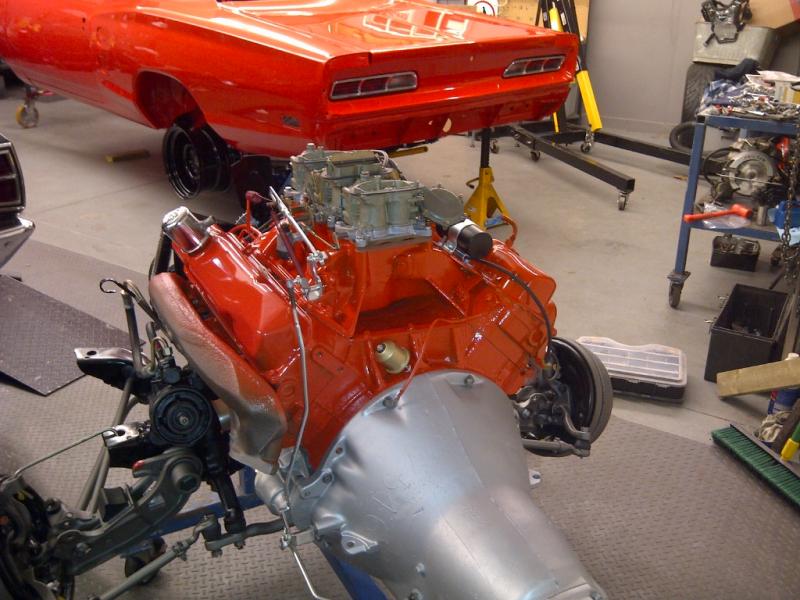

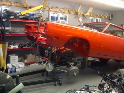

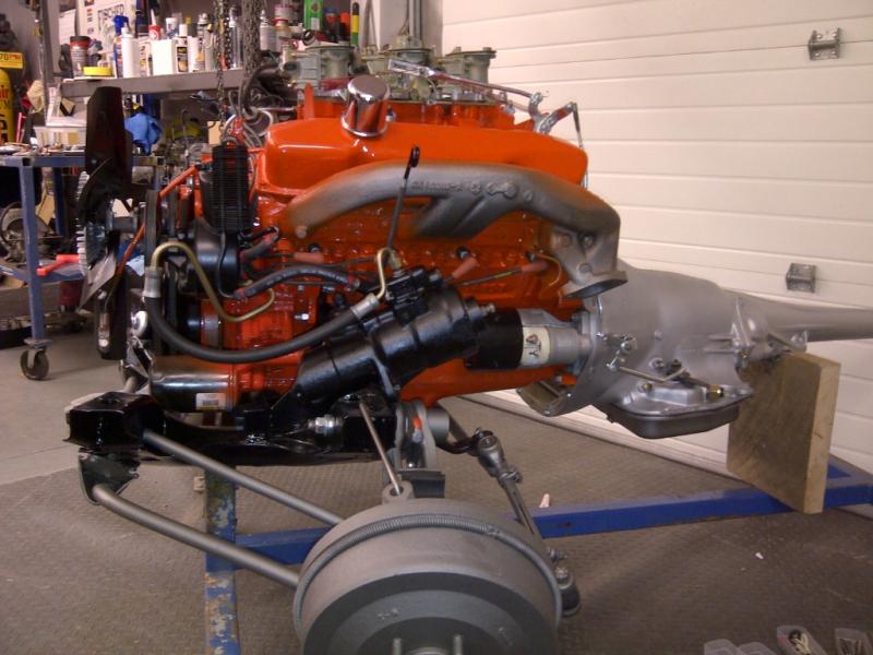

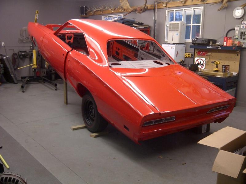

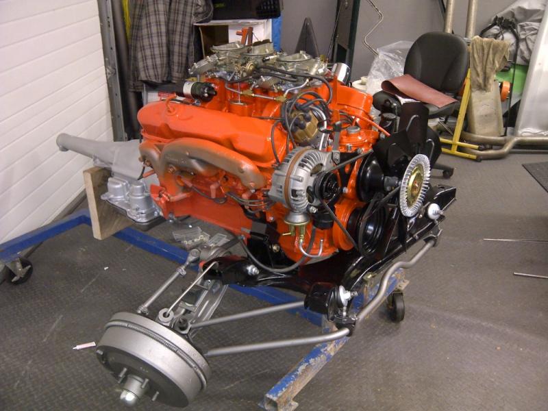

Got some more done this weekend between hunting outings---Motor is back in place wooo whooo!

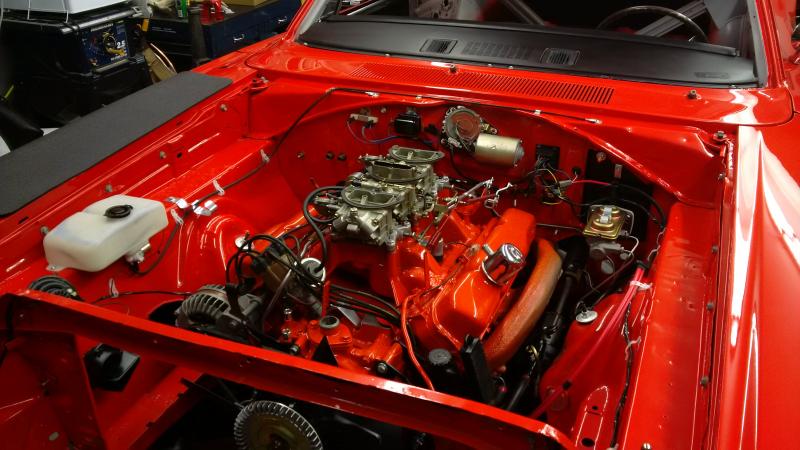

Can anybody on this site tell me where I can source a repro electronic yellow print 159 voltage regulator or maybe just a cover that could be retrofitted to an aftermarket regulator which I have a few of.053.jpg054.jpg055.jpg056.jpg

I think the strap that you used between the casters should be black.
Looks real nice Gary.
Talk to you soon: Dave
Sway Bar, links, rear springs, backing plates are all Zinc Phosphate coated...which is a dull looking flat black. Sway bar brackets are painted black.

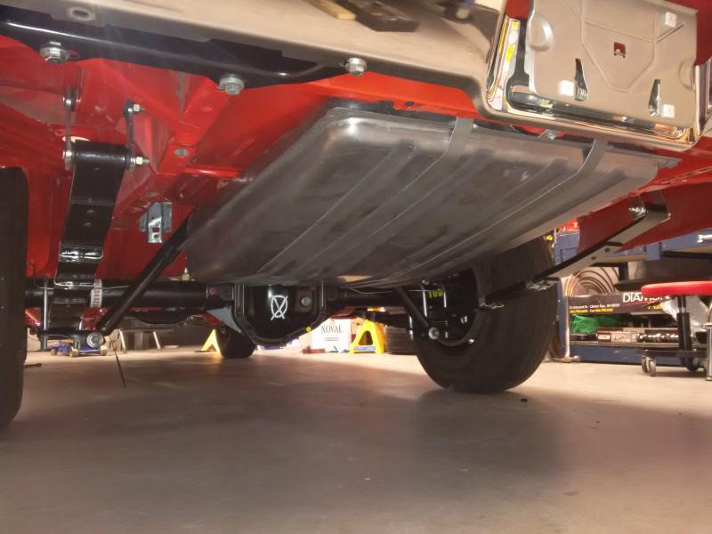

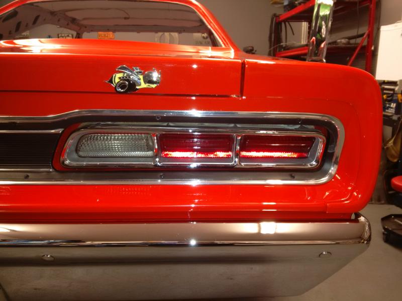

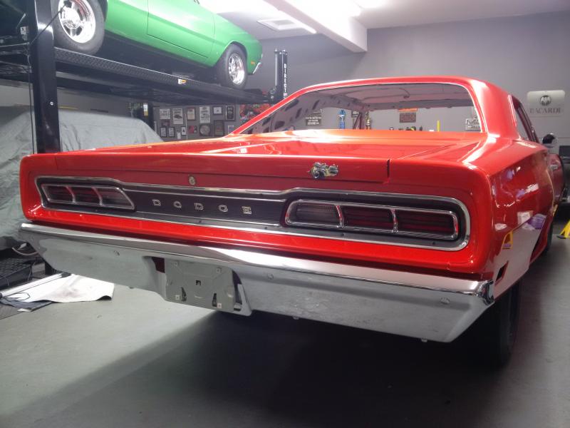

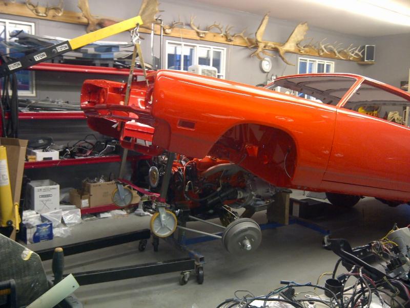

A bit more progress over the last few weeks, its sitting back on 4 wheels while I do the rest of the assy work. Hope it comes down a bit in the rear once all the parts are back on, sitting a little high right now.
I rebuilt the original springs and actually re arced some of the lazy looking leafs with a home made die and hyd arbour press hopeIMG_00000004.jpgIMG_00000005.jpgIMG_00000007.jpg I didn,t over do it
Looks great! ....back should come down once you get the bumper etc back on ...and spare in it ....and they always settle a bit after driving about 100 miles - I know mine did.

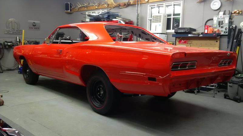

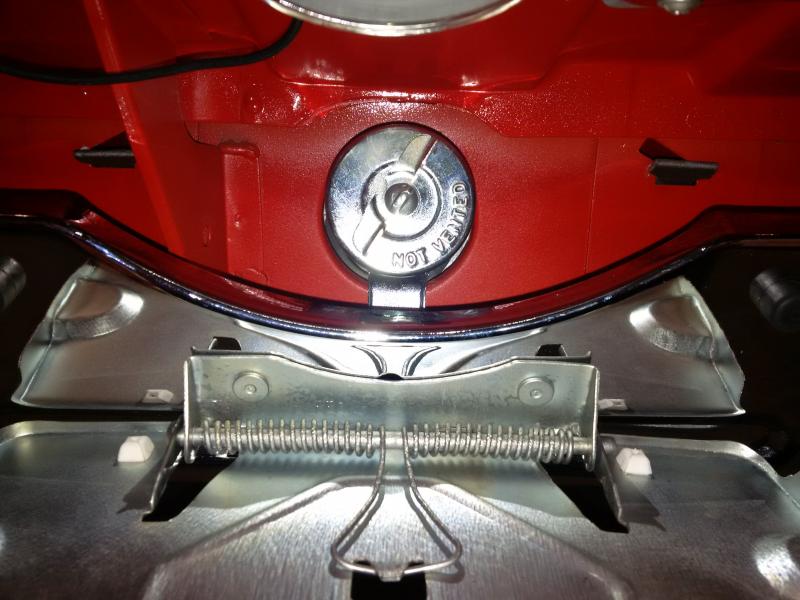

Thanks, I think it is starting to settle a little as the parts are going on--I stood in the trunk and got some motion going up & down don,t think it did anything lol-- rather be a little on the plus side than the minus to begin with--pretty much got the back end done , gotta love the look of a 69 coronet from the back!!!IMG_00000019.jpgIMG_00000038.jpgIMG_00000040.jpgIMG_00000047.jpgIMG_00000051.jpg
