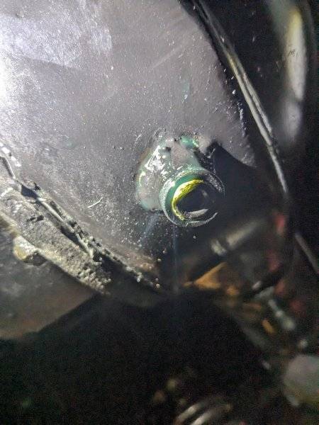

That sucks, however JB weld is your friend. You can try and reweld it but since it has lube in the cracks/holes it is going to be a pain.In other news my rear end was leaking at the new drain plug. I tried a couple of things and it's still got a slow leak. Turns out it's not the plug at all. It's the weld around the half coupling. That sucks.
I'd drain it, clean it as best you can (carb and/or brake cleaner) and then wipe it down with some acetone, then apply some JB weld and let it cure.
