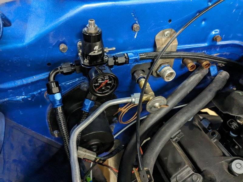

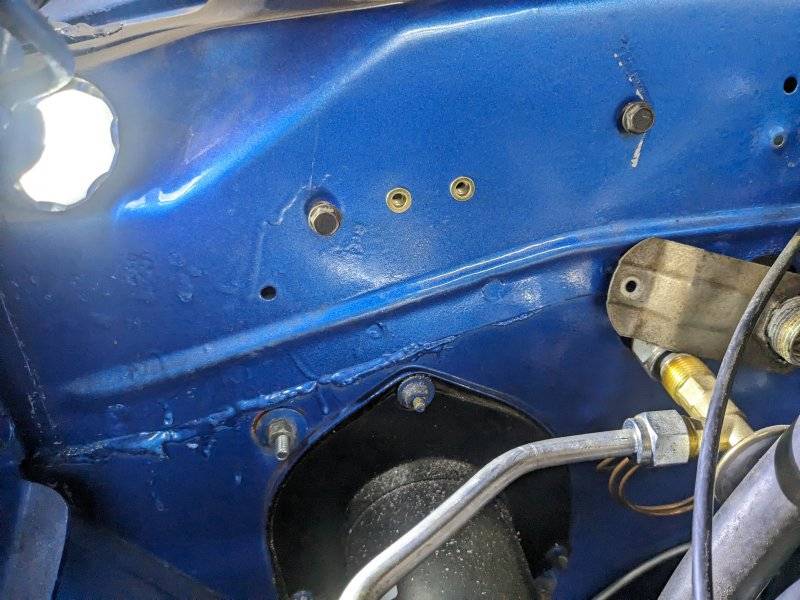

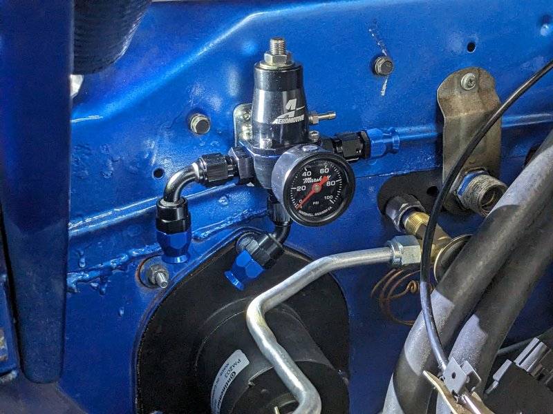

I got my fuel fittings so I went ahead and mounted my regulator. I installed a couple rivnuts in the firewall. Will be a little annoying to remove my blower motor if I need to, but at least it's just the return line that will need to be disconnected.
View attachment 1541818View attachment 1541819
Nice work, I am right behind you as I need to mount my regulator as well, most likely in pretty much exactly the same spot and I will do it in exactly the same way.

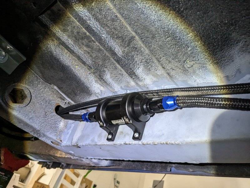

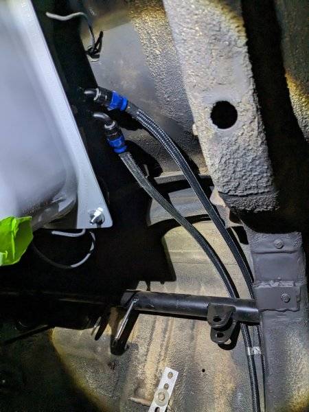

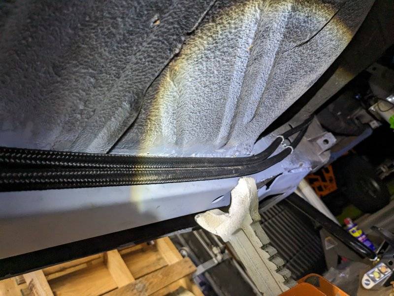

I got my fuel filter mounted and my fuel lines made. I was under the impression that hoses would be easier to make than hard lines. I'm not sure I still believe that. I still have to take them off and undercoat my frame connectors. I really need one more 45deg fitting instead of the 90 on my fuel tank, but I'll leave it for now.
I guess it is a matter of prospective, I like making the hard lines and hate doing SS braided but I have done a lot of it so I know how to. I always make the lines from my tank forward out of hard lines and then post filter go soft (usually).
Nice job either way. I am going to be mounting my filter in basically the same place as you did. Originally I was going to put my filter on the other side of the T bar cross member but I just realized it would be right next to the header and be pretty difficult to get to so now I am going to move it.
I wanted to keep the filter closer to the tank and that section of the sub-frame connector was a taller than the rest. It's also pretty easy to get to if needed. I think the nylon braid over the SS braid is what made it difficult. You really have to compress the nylon to get it through the fitting. It took a lot of trial and error to get a system down. I was lucky I had a few spare ferrules as well.
