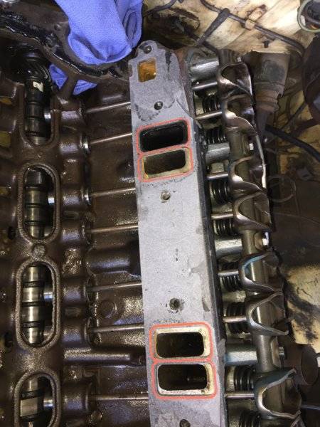

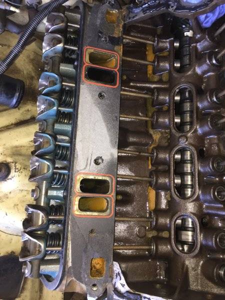

Pics on my phone aren't the best. Is the passenger side intake gasket on correct?
I think so again P3 shows them more clearly. What didn’t look correct to you?

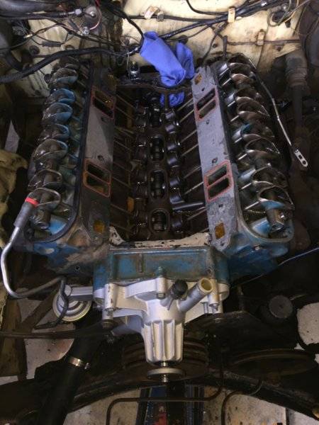

View attachment 558211 Here we go......
Oil and coolant drained. Header bolts removed but I need to get back under her to disconnect the headers from the exhaust. I have never installed or removed heads. They should pull away as one entire assembly with no further dismantling correct? Any adive here is appreciated!!
View attachment 558212 View attachment 558213
Do you have a wet/dry vac? When you pull the heads coolant will go into the cylinders. A shop vac makes it easy to suck up all coolant.
Looks good; I pulled the pic up on my large PC monitor. Sorry for the false alarm.
Good idea I will see if my old vac work with fluids. Thanks for the heads up 68!
Since everything is still together does it make sense to try and run a compression test on all the cylinders? Or does the coolant intrusion complicate the testing?
Nope. Just yank the heads. They might take a little persuasion to break free. Wooden hammer handle stuck in an intake port and give a little yank. Usually enough to crack em loose

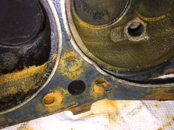

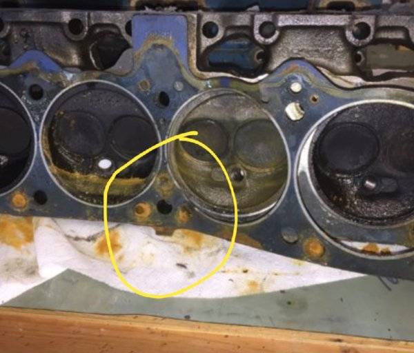

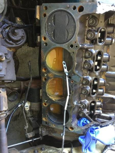

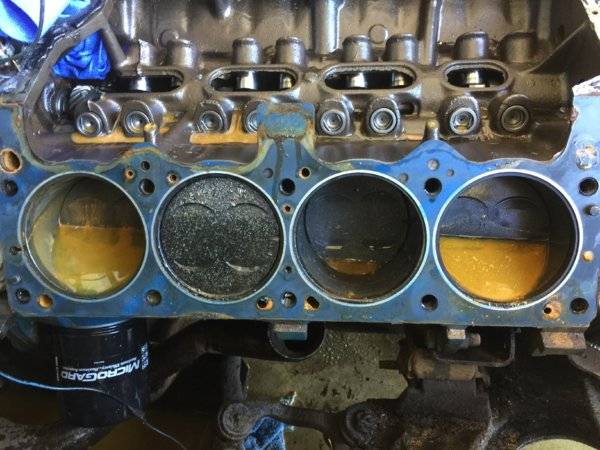

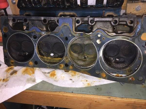

Ok passengers head. The gasket looks newer to me but then again I never saw the factory’s. It actually looks just fine. Pistons look clean no major carbon build up. Humm...

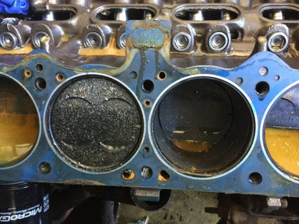

Driver side came off with the head. Not sure if I did the damage but the gasket was twisted so thats why I think I may have caused that. Not sure...

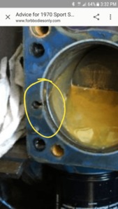

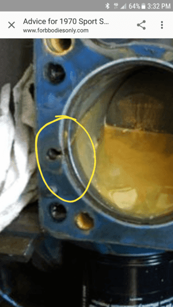

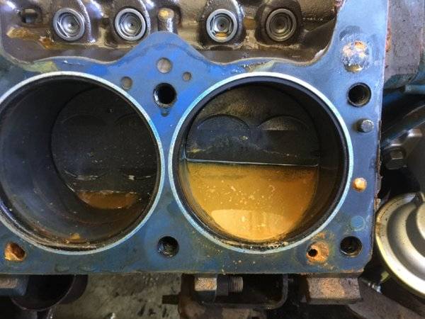

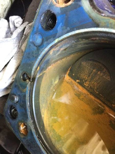

Whats going on here?

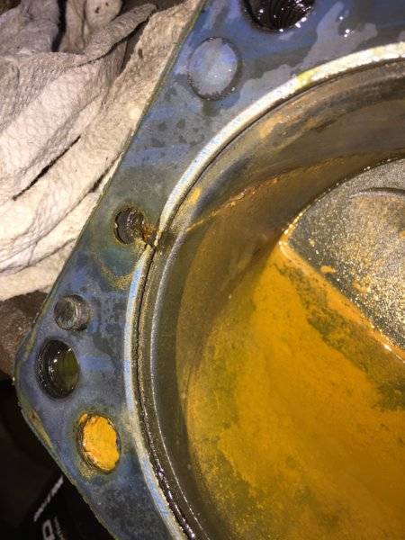

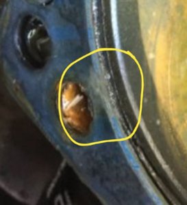

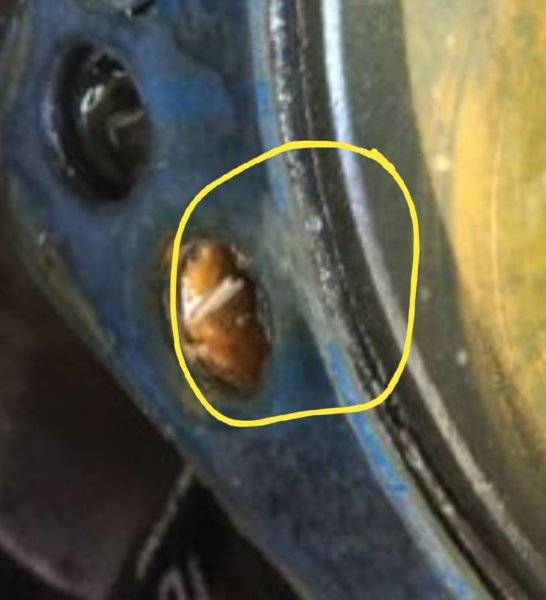

Yup that first one is real would that cause a leak? I guess any cylinder openings are an issue. Here are better shots of that one.
You said you got water out of 3 and 8?

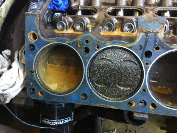

Looks iffy here too?
