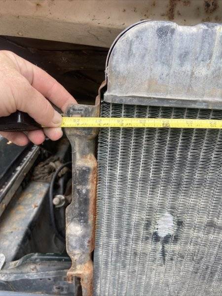

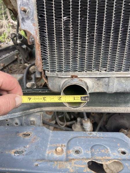

These pics are from my parts car radiator but same dimensions

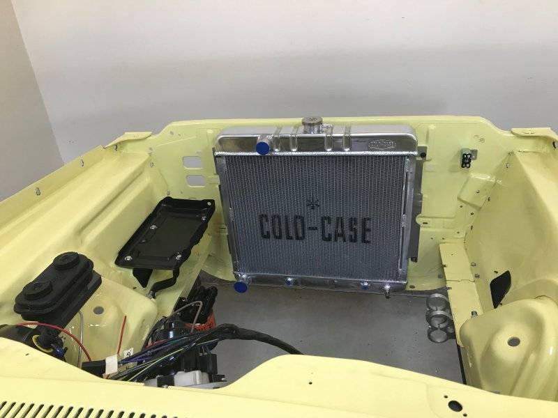

My Cold Case fit pretty good after I "adjusted" the mounting holes. Had to fabricate some brackets to adapt the shroud... for me it wasn't a big deal but as far as this being a direct bolt in, not so much. They sell a shroud for this rad but the factory one works just fine.
