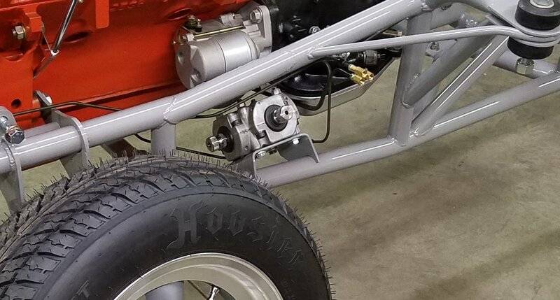

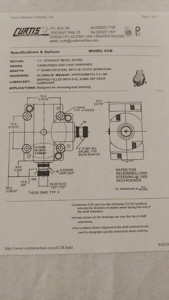

1STMP I'm intrigued by that small "bus" steering box. Is it a 1:1 ratio? What kind of GM bus did it come off? I have a Massey Ferguson 202 Workbull tractor here at home that needs a total revamp of its steering and I'm thinking that part may work for me.
MoparMur,
The box is from a model 06 RTS Motorcoach.
90deg mitre w/1:1 ratio. The shafts are 1" 36
spline.
The one I bought is an "engineering prototype"
as they are not for sale to the general customer,
though you can call to verify. It's been a long
while ago when I got this one.
I believe you can purchase one via a business
license, or find a RTS bus for a used one.
They are well built and robust. Hope this helps!

I've got another miter box, but the shaft
rotations are opposed. (turn right to go left).
If you think you could use it, PM me and we'll
work something out.
I worked for TMC/NovaBUS for 15 years as a
mechanical engineer, hence the idea for the
miter box. I needed some way to get the steering
past the headers to the rack&pinion. It works
great w/no freeplay or backlash.

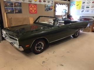

This was one of his cars:

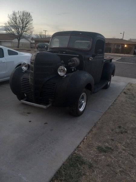

I've given my truck a name. Vern.

Hard to believe it's taken two more
years where the truck is to the point
of paint and interior. All of the
powertrain bugs have been worked
out. She starts and runs well, brakes
and cooling system good. We've only
run it on the street a couple times to
get everything fine tuned.
Windows, window regulators, door
latches and handles have taken
quite a bit of time to figure out.
Titling has turned out to be a different
horse altogether. DMV just doesn’t
see many custom trucks this old with
pieced together bodies and homebuilt
tube chassis.
