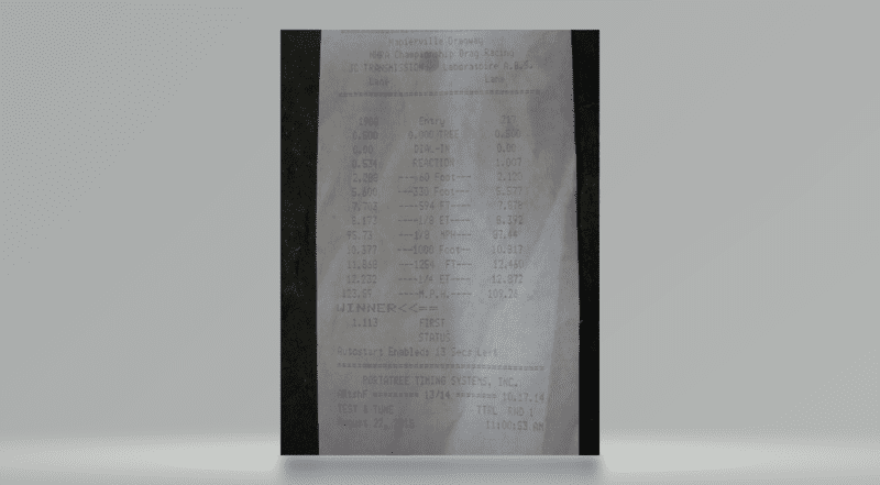

12.872 ET 109.26 MPH
60 foot 2.120
4000 lbs Dodge Charger with street tires and 3.23 Suregrip...
