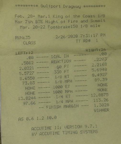

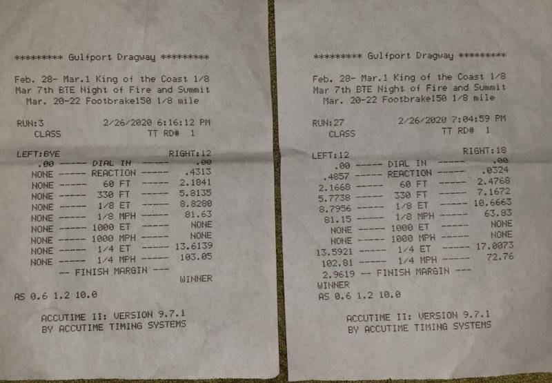

Here is the 2nd run I did that night. This one dropped from 103 mph to 102, but I also went 13.58 this run instead of 13.61
A little wheelspin in first gear, but not bad in my opinion, and I wish I would have stayed in the gas in first instead of a fraction of a lift for a fraction of a second.
