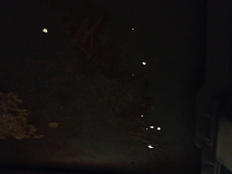

Well....Some folks have a sun roof, some a moon roof, but I got them all beat....I have a Planetarium roof! It's Cassiopeia and Orion's belt! LOL Anyways, the roof is dead.

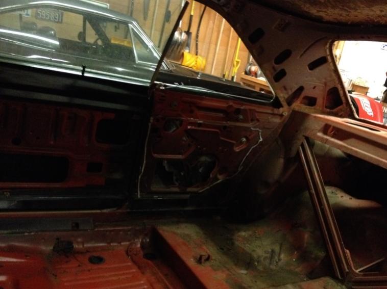

Interior's all ripped out. Just about ready to pull the front window and dash.

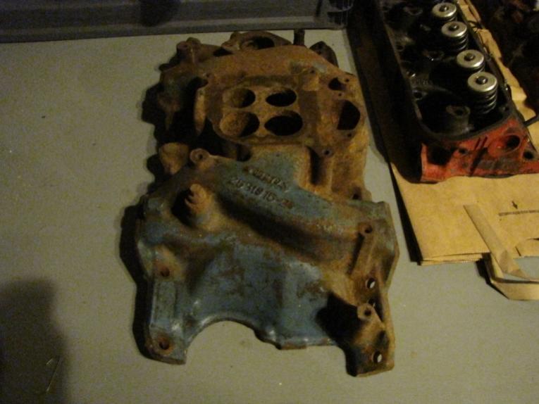

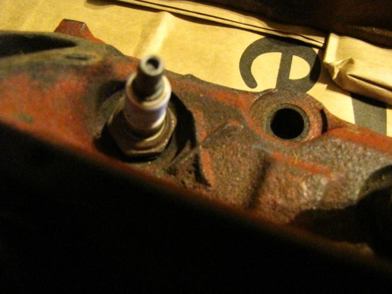

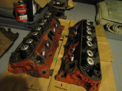

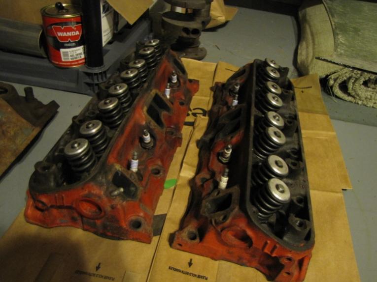

Took a drive and ended up picking up a real nice pair of fully assembled 340 "X" heads, and the seller threw in a 340 Intake as well....all for $300 bucks. I couldn't pass them up. Price was really decent. A guy could easily slap these heads on and run them. My original plan was to run a ported set of closed chamber aluminum heads or the RMS Indy's and shave the pistons for zero deck to build a quench motor. Now I may change my plans....I don't know. Might be better off selling these off to someone building a car back to factory specs. I know I won't be running the intake, if anyone needs one.
trust me sell them and get the rhs heads and build a quench motor! I did for the charger it is awesome! much more efficient you won't regret it. in other news I picked up two totally mint front fenders and a front bumper for the wifes swinger last night $450 for all of it. ahh yes and so it begins!
Trade ya a nice factory A Body disc brake setup for those heads. :)
Thanks 360! Heard a lot of good things on the RHS heads. Sounds like you got a swinging deal on the swinger tin.
Good on the Disc brake hardware Jay, thanks for the offer. I'll probably look at just selling these outright. Spoke with a local old school head builder in Appleton today. After talking with him, these heads belong on a car where someone's looking for originality and factory performance. Don't think I can push myself to start cutting/machining/modifying these heads to try and meet my needs. They're open chamber and I wanted to go the closed chamber/quench route. Guess I'm learning as I go here.
