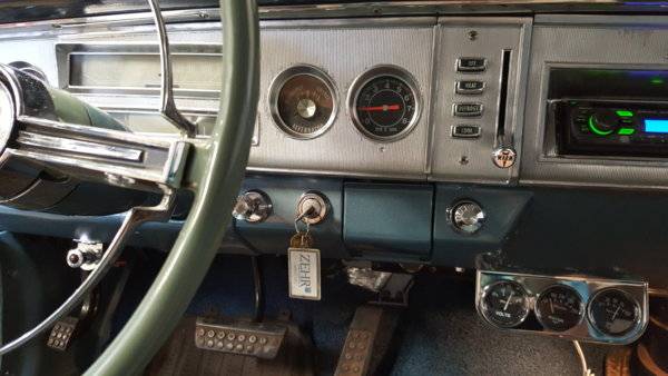

It's been a while since I've posted. Added the new in-dash tach and a few more gauges. I haven't connected the temp gauge yet because I can't get the plug out yet. Over the winter I hope to add a shroud and a new ignition system.

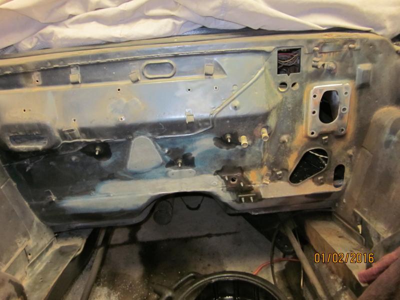

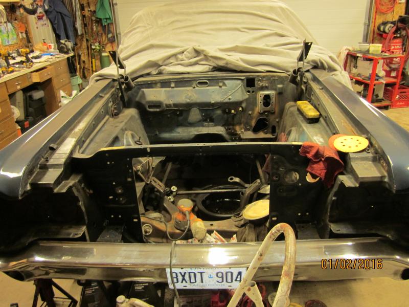

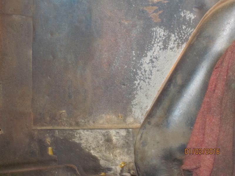

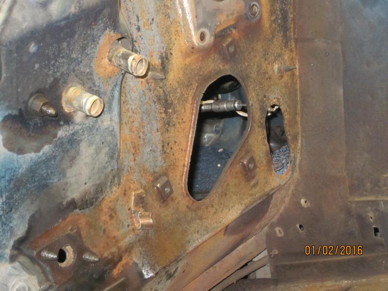

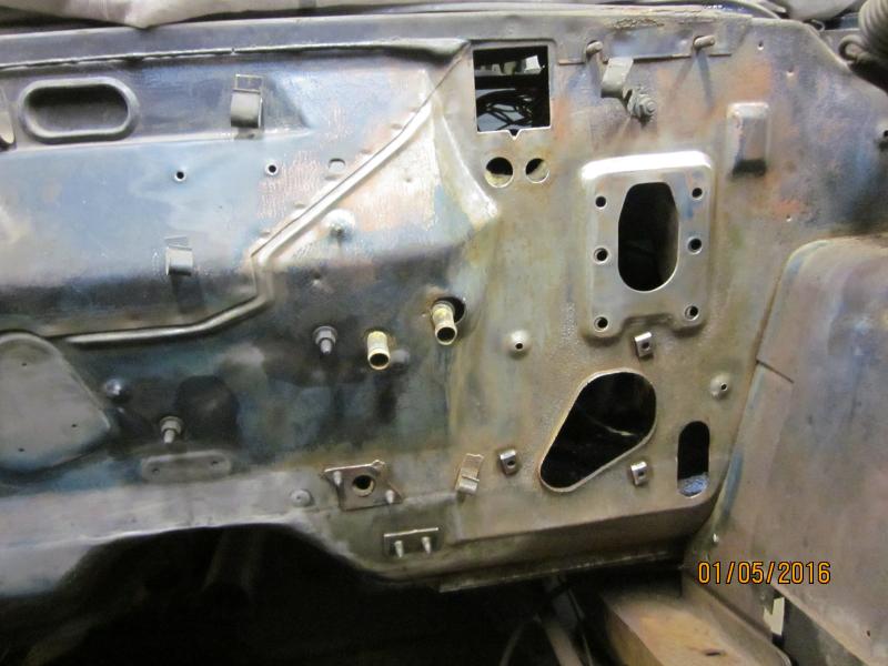

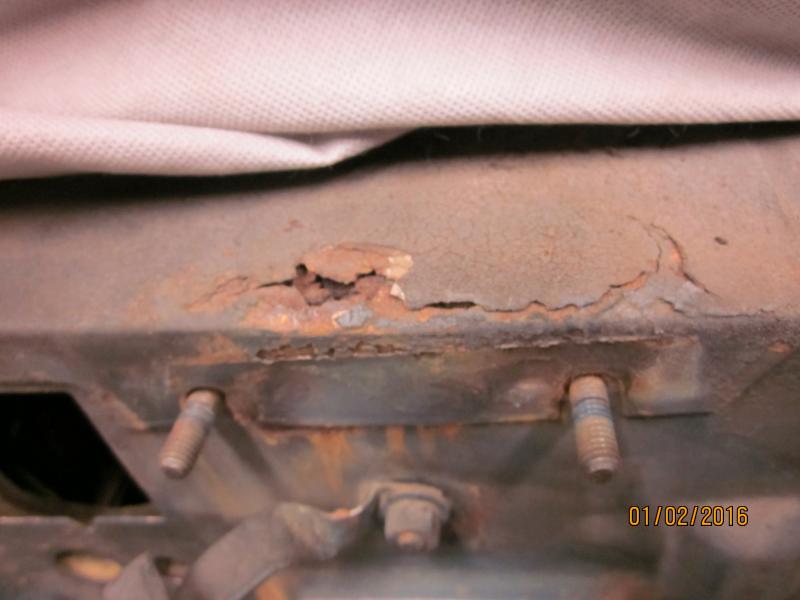

I was hoping to just clean up the engine bay but I'm finding more spots here and there that'll need attention. Man there's a ton of undercoating under thoseView attachment 301075View attachment 301076View attachment 301077 fenders!
Actually, I sold the poly to a guy who waited months for me to pull it. I didn't I'd be able to sell it and was thinking about keeping it but I promised him so off it went.

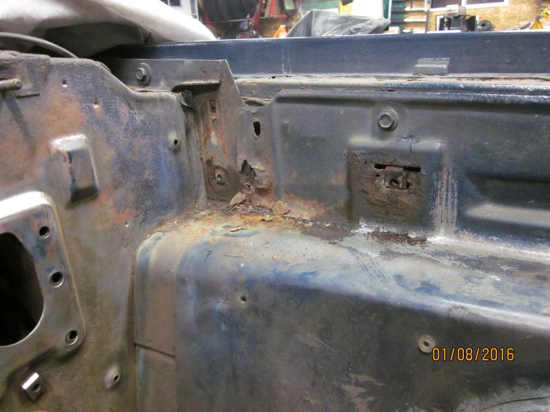

A bit of surface rust is making it challenging. If the car wasn't already painted, I'd just media blast it. Maybe I'll find a way anyway! I think the fenders have to come off to make those other repairs. Now if I can get them off without scratching them up...
View attachment 301078View attachment 301079View attachment 301080View attachment 301081

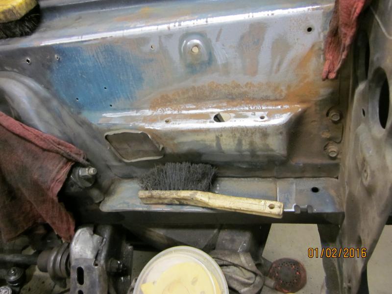

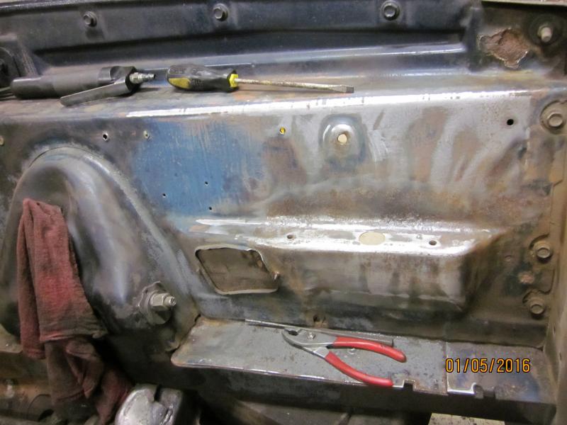

Thanks to Mr Belvedere's posting on his 67 ragtop (great read btw), I bought a needle/scaler. I love this tool! Together with a wirewheel in my drill, the rust is fading away.

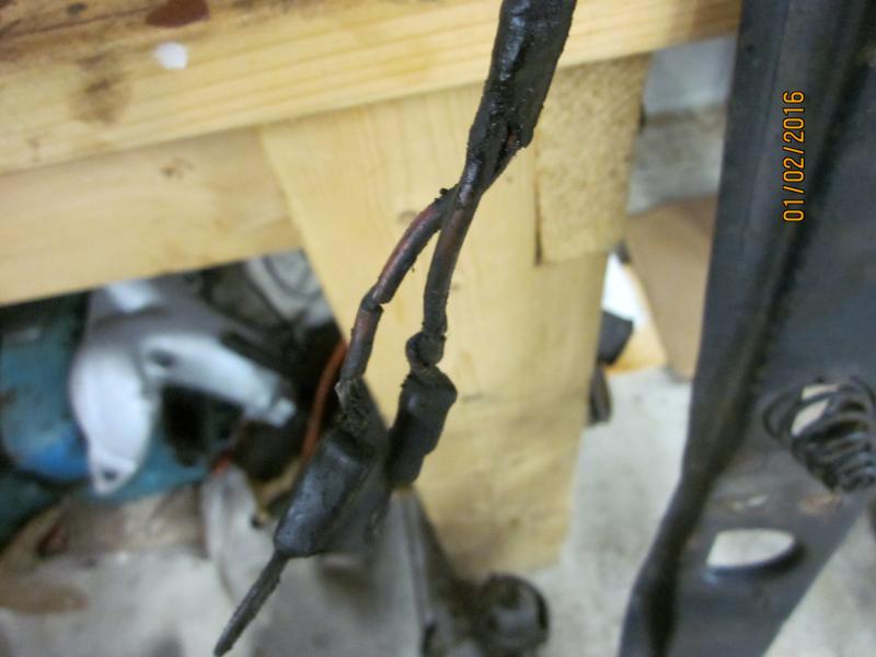

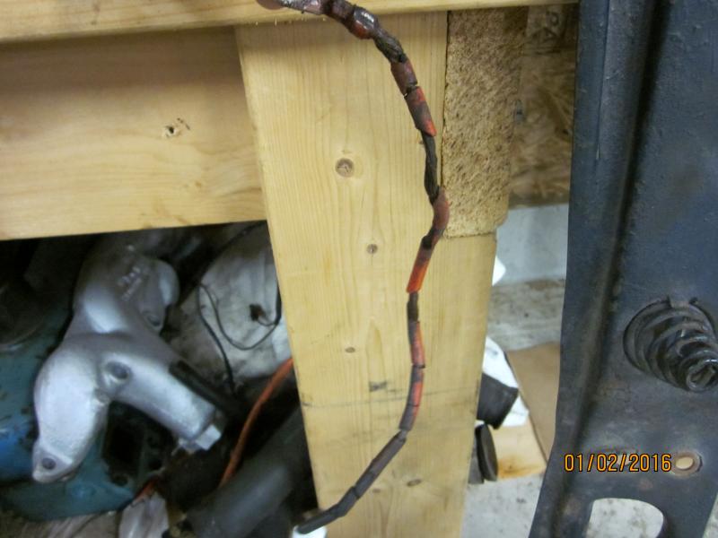

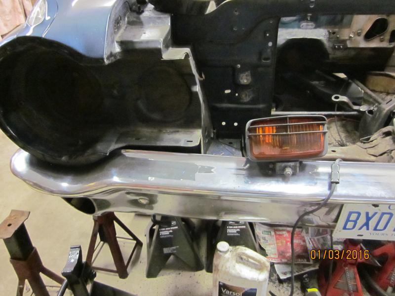

Looks like some rewiring is in order...good thing I'm an electrical guy! (But I'm wishing I was a welder about now)
View attachment 301086View attachment 301087
looks like a good spot for these fog lights don't you think? (just kidding)

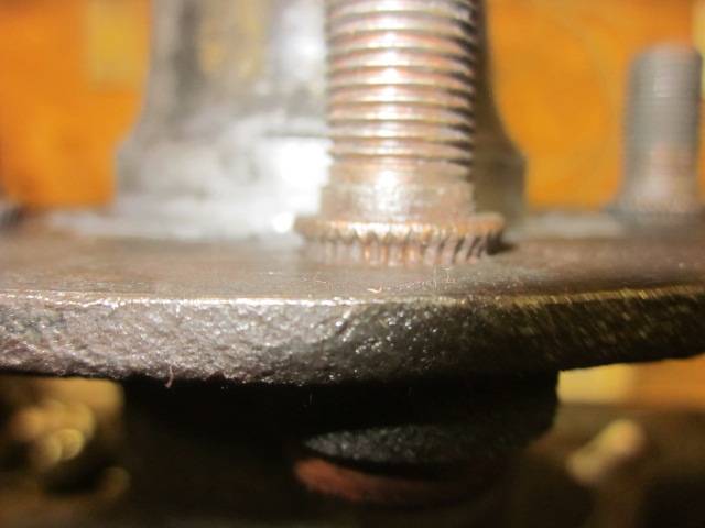

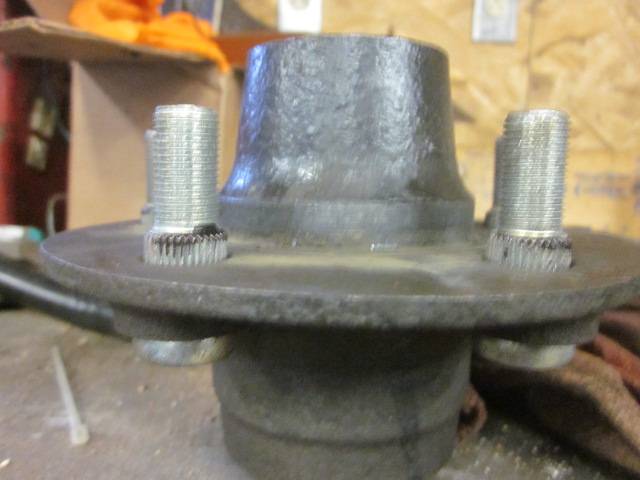

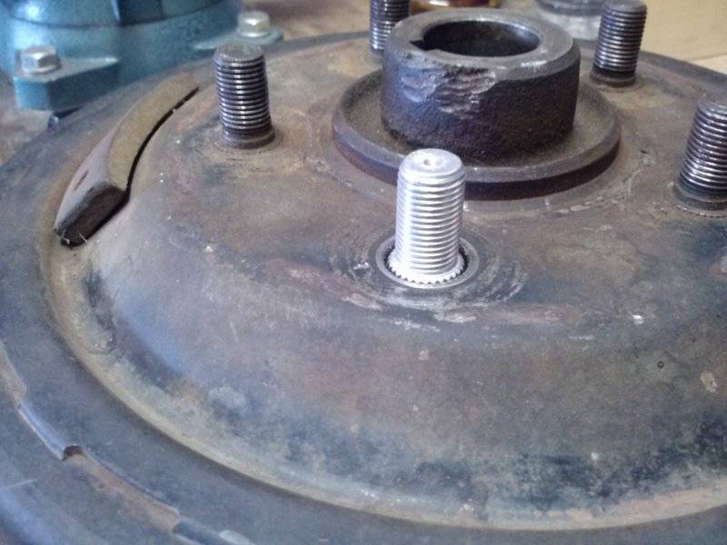

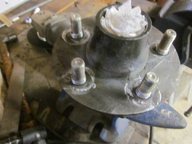

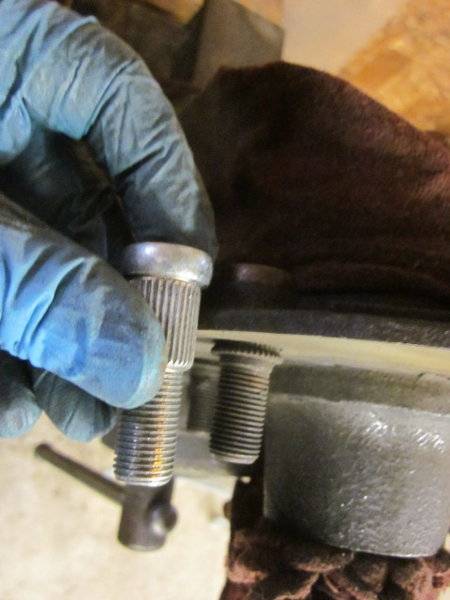

Time for some new meats! Finding LH thread lug nuts is a pain, so I decided to replace the studs on the front wheel.

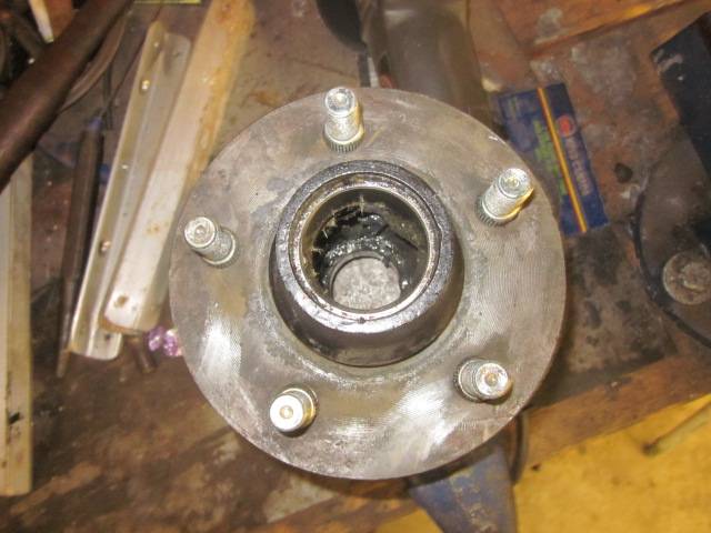

The drums must have been drilled out by a PO but the studs are still swaged.
I cut the studs below the swage and they popped right out on the press.
The new studs pressed in nice and tight.

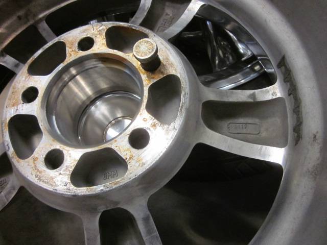

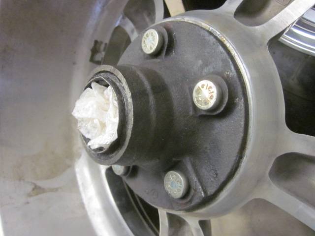

The shoulders are a little tall and test fitting into the rim shows a problem getting the hub to fit flush.
A little milling with the die grinders fixes the problem.
Nice and flush now.

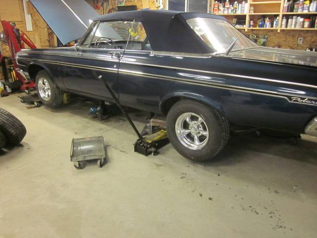

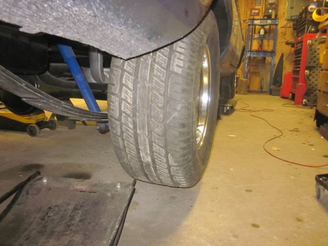

As much as I like the steelies, I felt this Polara with all that chrome trim needed something more shiny.
275 60's fill up the wells much nicer imo.
Took me a while to decide on a style, but I finally went with Torque Thrust II's

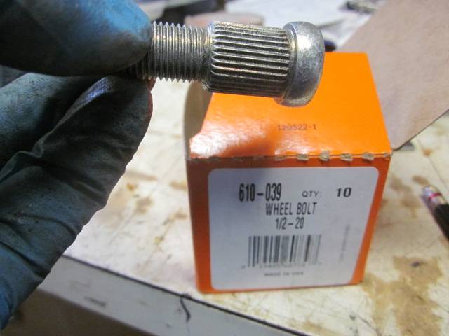

On the wheel studs I found that the 610-090 work as great replacements, used them on my 62 when swapping out the swaged drums. They are listed for Jeep.
