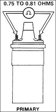

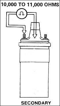

Coil (?) possibly too
View attachment 999887 View attachment 999888
I've has a bunch of **** coils of late it seems
don't know why either, even good brands

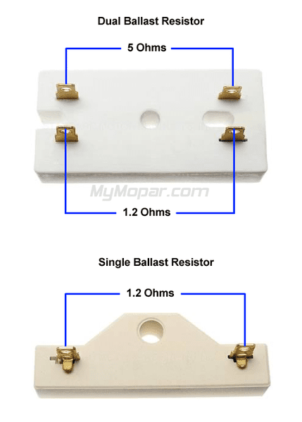

ballast resistor

your coil is weak & out of perimeters too
