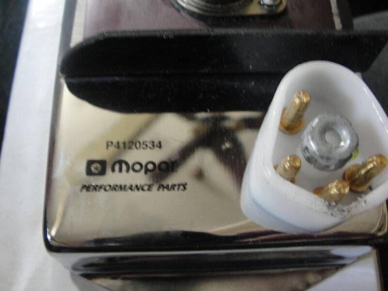

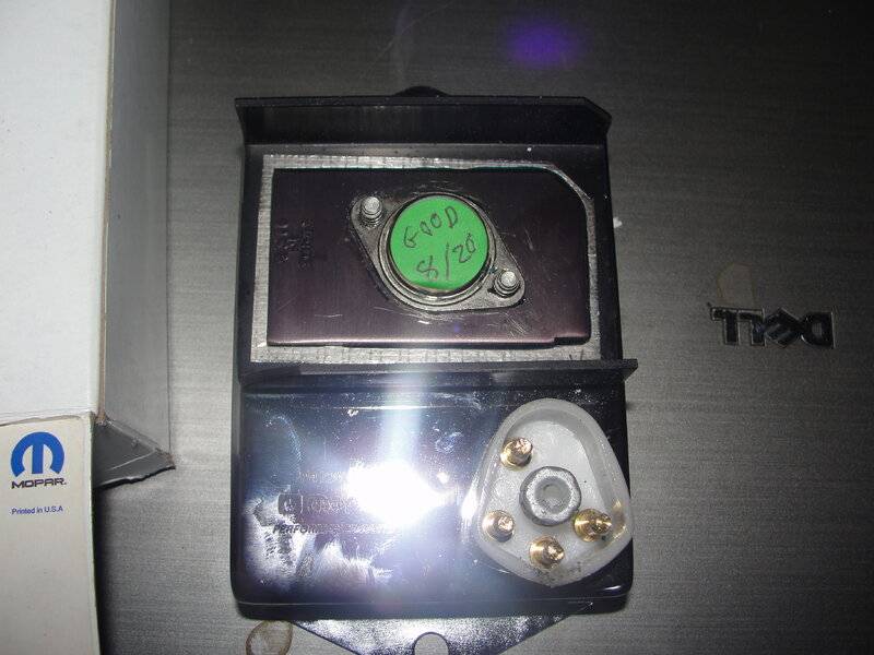

I have a Mopar chrome box apart right now , taking my ohm tester to the board

View attachment 991620 Funny you mention that I forgot I had this gem and it can only run right with a .25 ohm ballast.

3 of those burnt in two years in a row on my car ( those exactly ). With blaster II Chromed coil and dual ballast resistor, I think .5 ohms primary, can't recall ( quite often, the MSD .8 single resistor just trying to finding some difference). Why dual ballast ? Because as mentioned... NOWHERE says EXPRESSELY AND PUBLICLY it must get X or Y resistor when buying.
Can't say they got damaged by an "incorrect" ballast. I found the transistor went bad.
I know that list. But is not expreselly exposed anywhere on sales catalogs to guide to the buyer
