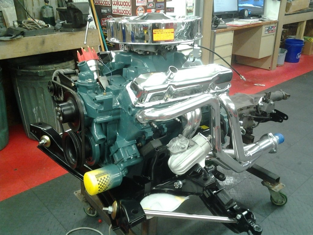

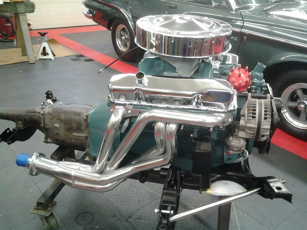

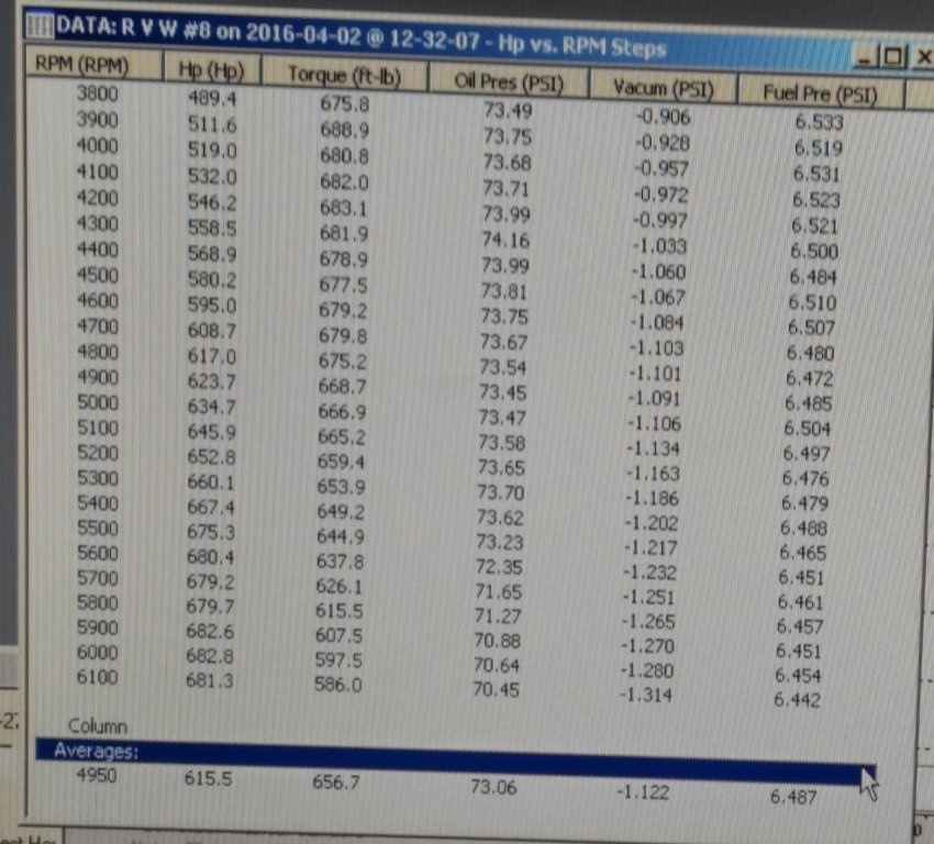

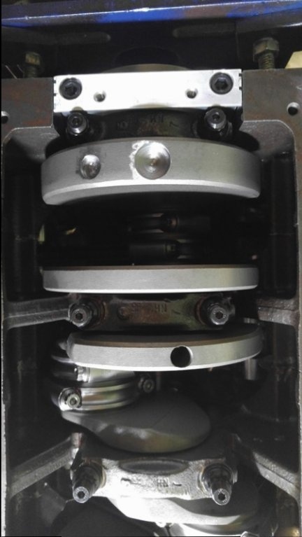

Here are a couple of pictures of the engine. Trying to make it look "close" to a stock 426 street wedge engine. Peak HP @ 5800 rpm 683 and max torque @4600 rpm 688 ft/lbs
OEM 440 block
ARP Main studs
Molnar 4.25 crankshaft with 2.200 rod journals
Autotec Custom pistons 4.380 bore 10.96 compression zero deck
Custom Hyd roller cam
Morel Hyd rolleer lifters
440 source heads 2.140/1.81 valves CNC ported Max wedge intake window. Inntake flow [email protected] lift exhaust flow [email protected]
Indy 440-14-2D dual plane intake port matched
Holly 950 Ultra HP 0-80805BK
PRW Roller rockers 1.6 ratio
Melling HV oil pump
street hemi oil pan with Milodon windage tray 32000
Dougs headers D452

....Peak HP @ 5800 rpm 683 and max torque @4600 rpm 688 ft/lbs....
That is exactly where I want to be. Bad-assed engine brother!! Awesome

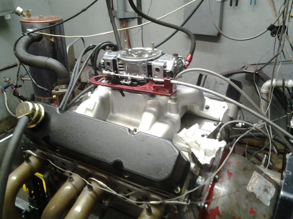

Call Scott Brown @ Competition Components 1-616-499-6223 or www.buyraceingparts.com. He just did a 512 street wedge engine for me with a mild hyd roller cam, single 4 intake with the 440 source heads that made 683 hp and 688 torque pretty much across the board. Very nice pump gas street motor. When it is done it will look like a stock 426 street wedge for my 64 Plymouth Savoy. Scott has been doing cams for me for a long time and has always been spot on for my combos.
Well that sounds like an absolutely phenomenal setup especially the way you have it painted and set up to look completely stopped so cool that's the best way make it look stock but rip it up hey you wouldn't happen to have your Dyno sheets so we can take a look at him to see the ranges and sets everything else goes along with the Dyno sheets just asking
Thanks I really like how the engine is turning out. Using the 440 source heads that look like the standard head really makes it look just like a good old 426 street wedge.
