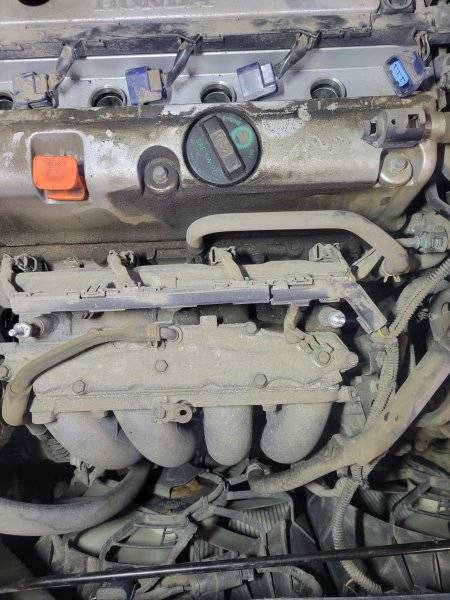

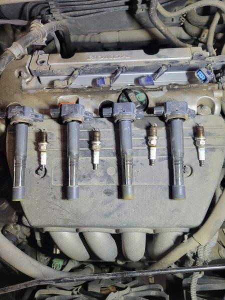

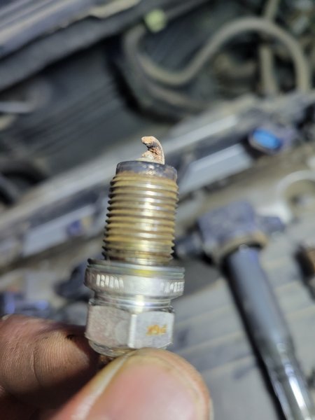

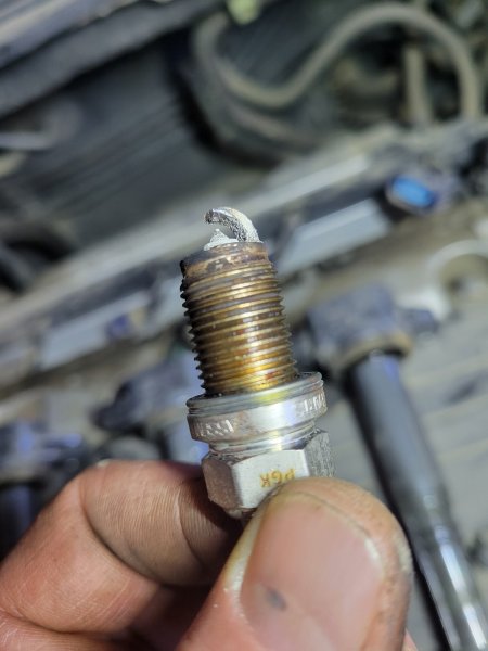

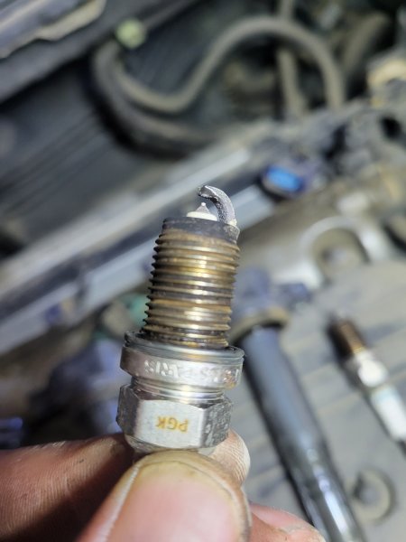

I have an 08 outside that I figured needed plugs due to a slight intermittent miss ( and I know these folks are low on the maintenance scale). So I figured nows a good time to have a look.. it has 170,000 miles on it. The jury is in...
You posed all the parts quite well. Kudos for presentation.
The only plug I pulled was #3 and it looked good. I'll still replace them all.
