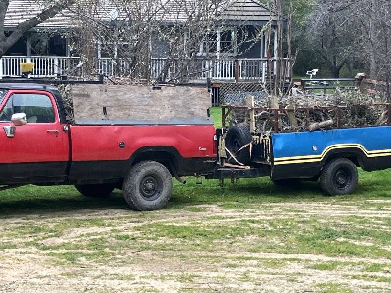

Tree fall and disposal:
View attachment 1614148View attachment 1614149
