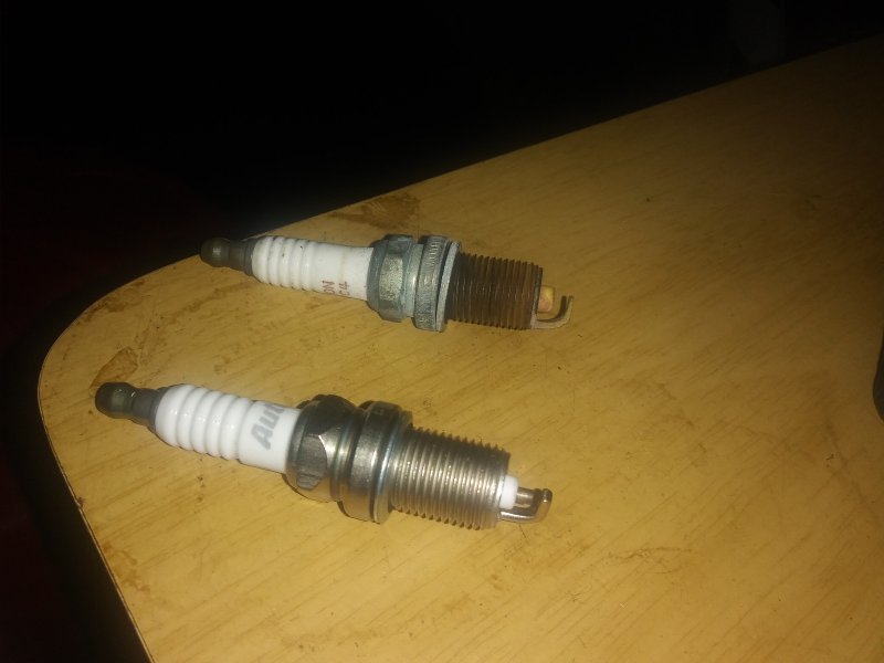

One is Autolite and the other is Champion?
No...the new one has a center electrode, the old one does not.
Ok, I misinterpreted "they" to be both of them. Yeah, obviously, the one in the foreground is brandy new. It's been another one of those days!

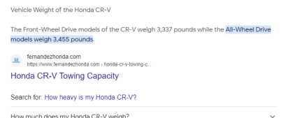

This Honda has never made much power. It always felt weak compared to everything else I've owned. A friend also had one that felt about the same so I don't think this one is a bad egg, just an overall underpowered vehicle. 2.4 liter 4 cylinder in an AWD compact "crossover" that surely weighs at least 3000 lbs?

3455 lbs for our model with a 2.4 L 4 cylinder?
