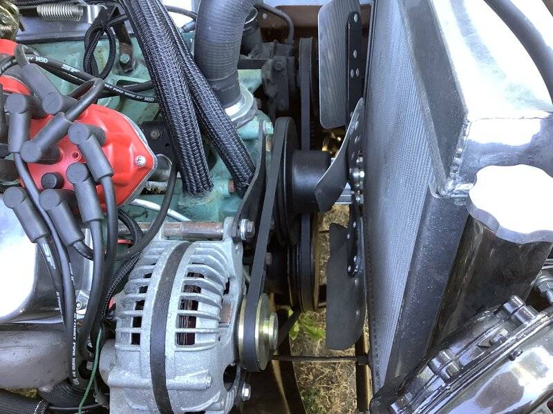

My 496 w mechanical fan, factory shroud, 2 row aluminum 26" radiator, flowkooler w/p, 70/30 coolant w 2 bottles of Water Wetter and 180° t-stat runs 174° on interstate in 120° temps and 161° in 95° temps. 196° in stop n go traffic in 120° and 185° in 95°.
3 different dual fan setups have been tried all did well in stop n go but as soon as over 45mph they started getting hot and at interstate speeds were hitting 225° n climbing fast. Cut slots/ports w rubber flaps in the shrouds and all still did the same. They seem to cause a high pressure area in front of the radiator due to their smaller openings, including the slots, which prevents enough air from going through. Yes, factory cars nowadays have e-fans and stay cool in 125° weather. Those fan/shroud setups were designed for those cars, molded plastic w large enough openings to allow enough air to cool the engine down to 200-220. That is the normal operating temp of modern engines w e-fans.
Moral of the story, if you're going to cool an engine in a hot, 120°, environment, what works for that blown hemi, twin turbo'd 512 in 90° weather, doesn’t necessarily mean it will work for your stock 383/440 in 120°.

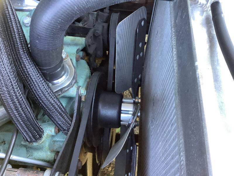

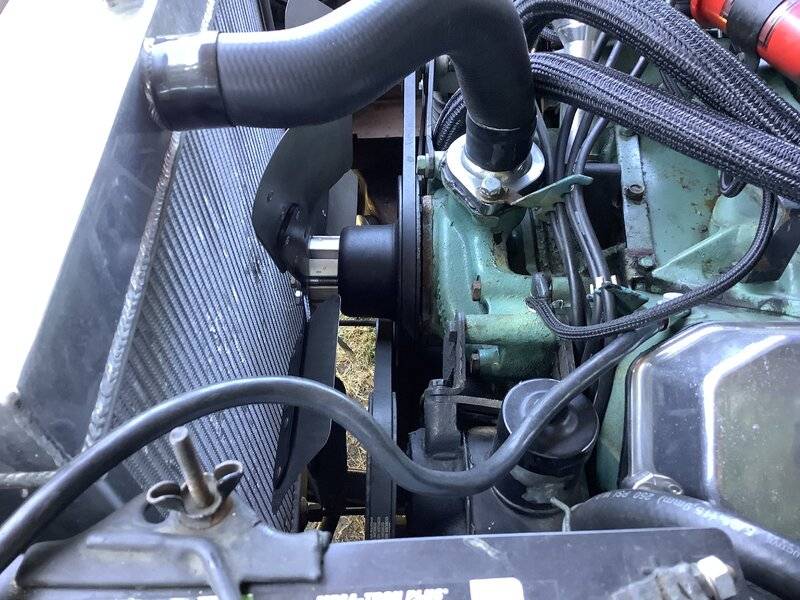

I had considered going to electric fans on my Charger but the current cooling system has worked so well there is no reason to do it. I run a champion 26” aluminum radiator with the factory shroud and a direct drive stainless flex fan. Thermostat is Stanton 180 and 50/50 premixed coolant.
Engine warms to 190, t-stat opens and she settles in between 180 and 185 regardless of conditions. I have always believed that you must have a really good cooling system regardless of what sits behind the radiator.
The 64 Sport Fury has a 22” champion radiator, no shroud and same flex fan and thermostat and runs almost the same way. Both cars have the same high flow water pump from Napa.
3DC11C8B-CC10-4F23-9A59-AF0C4E0DBADE.jpeg 26993AD8-068C-4E8B-9E2C-9616FEDE6618.jpeg 288A40D1-93BB-4371-AD85-4FA42B2BB1D7.jpeg 8FDBCD3A-DA6A-45A3-AEEC-0114418F5DE1.jpeg 485E7627-C0DF-4F2A-97DE-1E7B8D0A99BA.jpeg 96F1059D-3500-4243-8F69-2F7956B72BB6.jpeg 2623EA82-B87F-4DBF-BD98-E0B9236AE3E7.jpeg
My main point is when ads and people say it cools "even in 90° temps" as if 90° is hot. My engine runs 10-15° cooler in 95° than in 115-125° weather. And in 90-95° nighttime temps, no sun, it runs about 154° on the interstate. "Hot" is above 110° not 90°.
