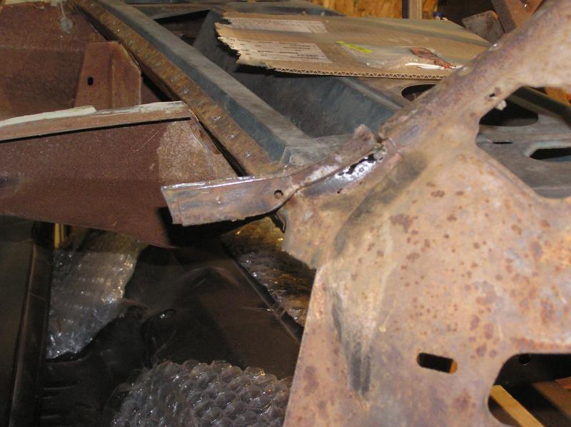

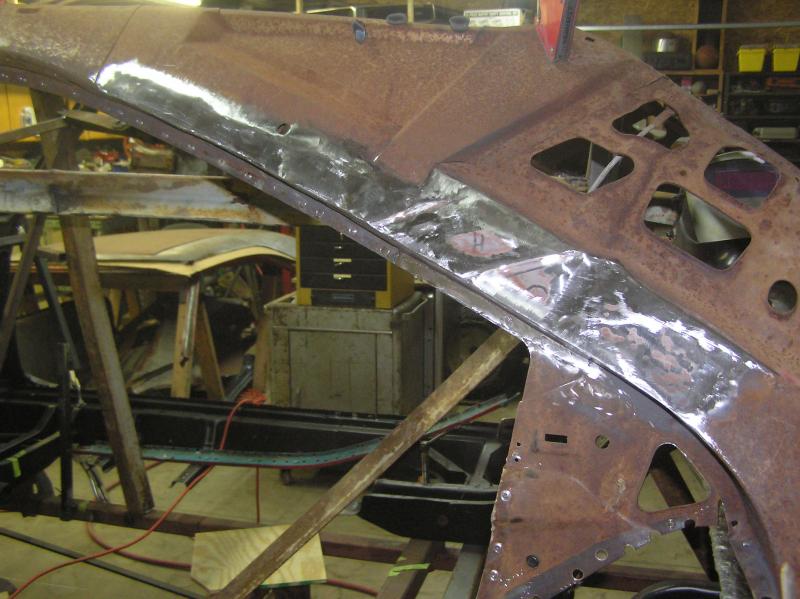

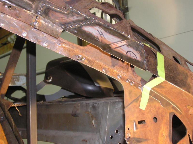

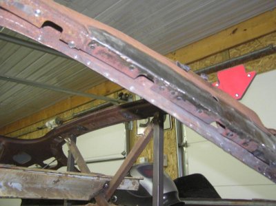

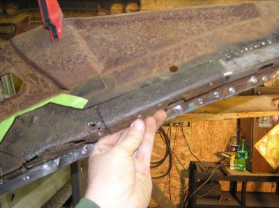

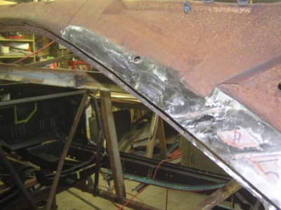

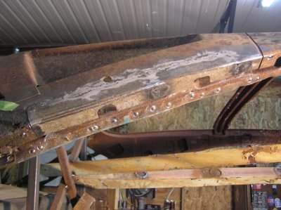

More passenger roof support patches

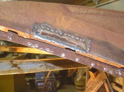

patch #2

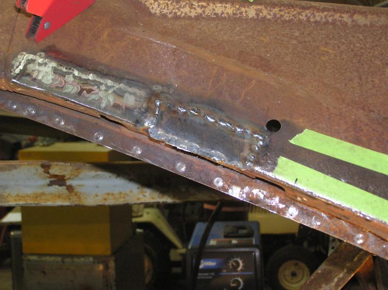

Patch #3

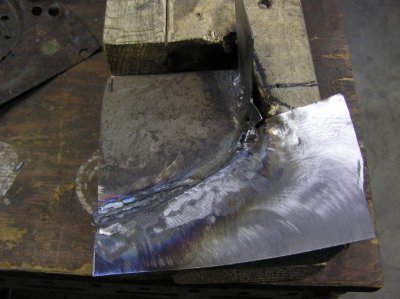

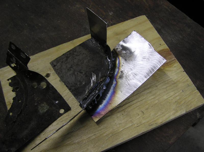

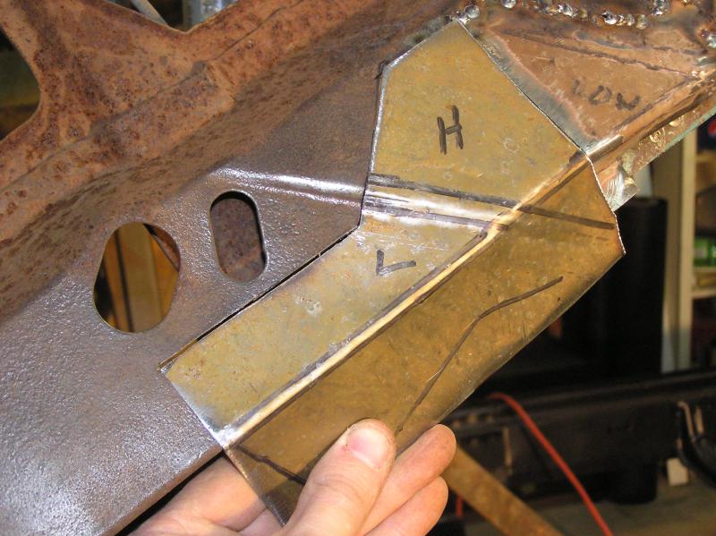

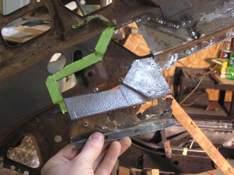

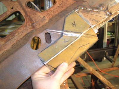

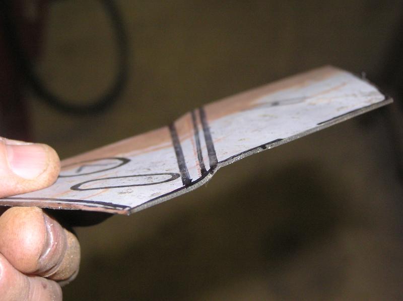

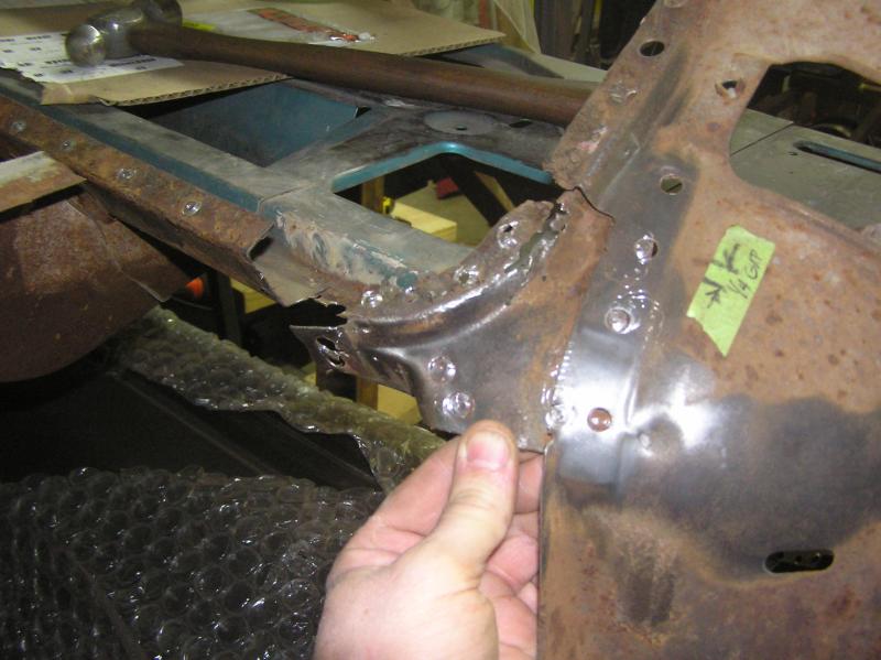

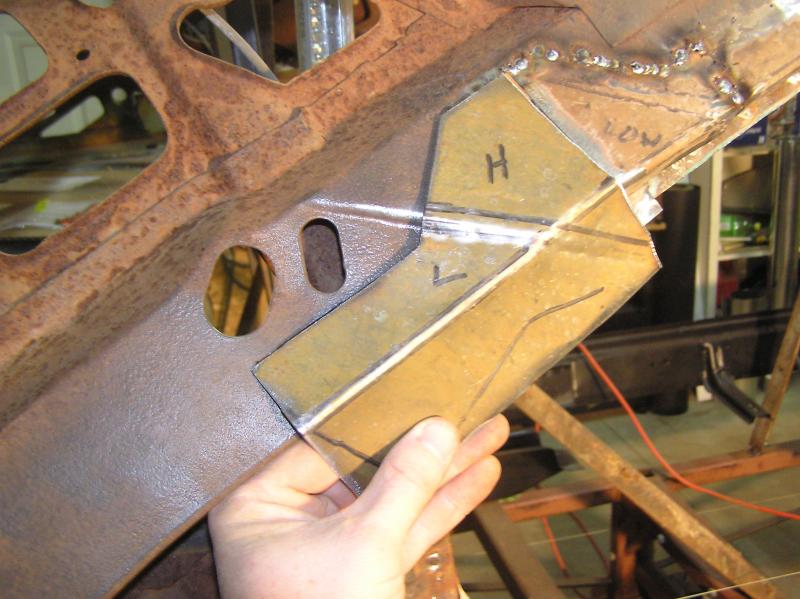

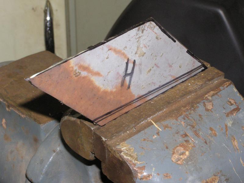

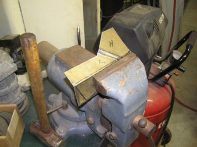

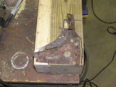

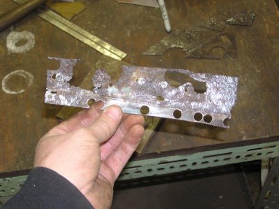

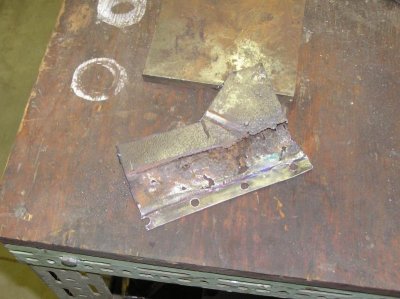

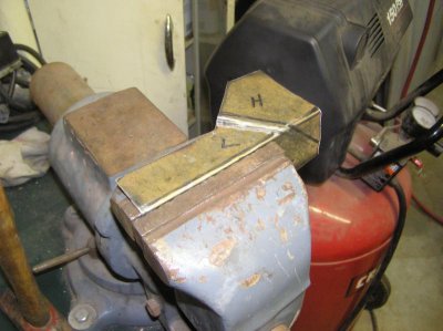

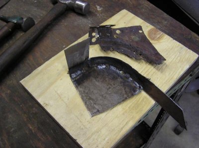

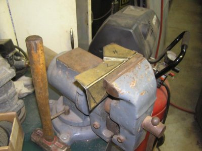

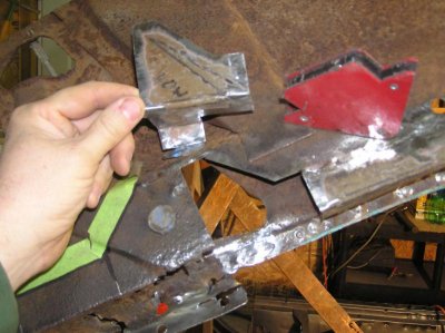

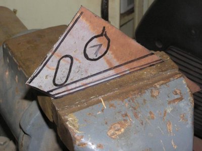

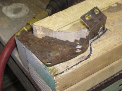

This one was a little scary! I layed out where the bends were, then hammered the original flat.

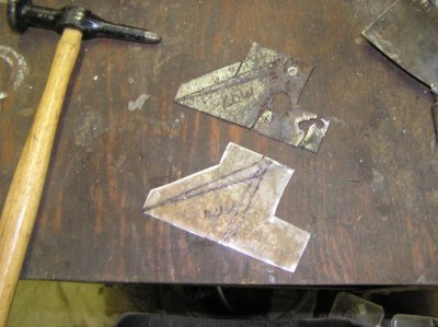

Next I transferred and cutout a new patch (a little bigger to allow for fitment) layed out the bend lines, then put it in my vise and did some bending
Kinda hard to see were it transitions from high to low, but if you backup 3-5 pics you can see what I was trying to duplicate.

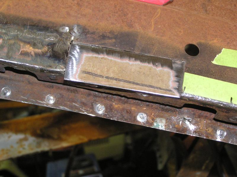

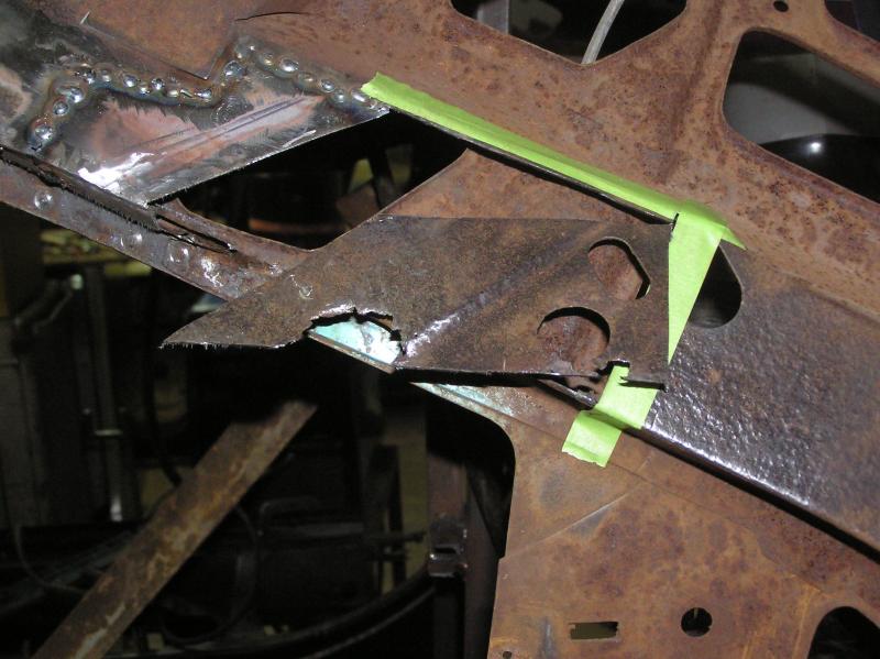

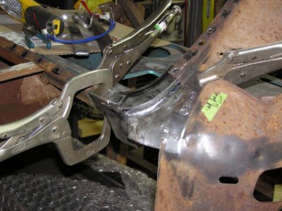

Patch #4
Similar process as patch #2

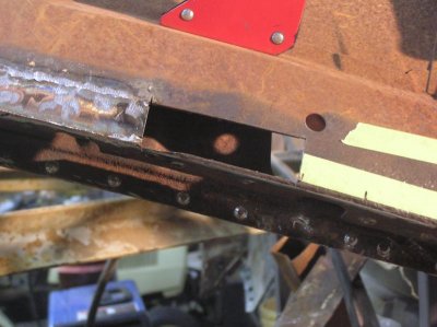

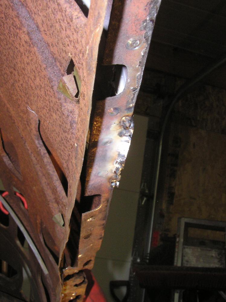

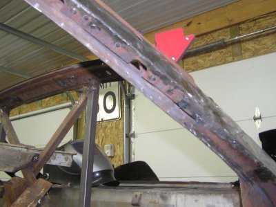

On to the drivers side.

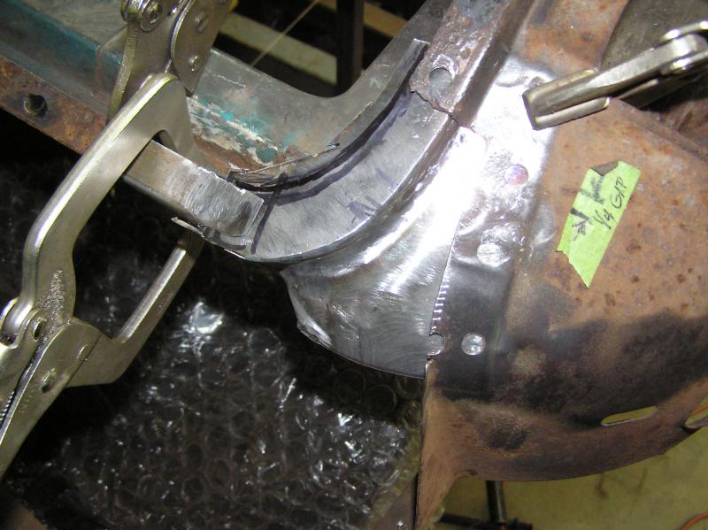

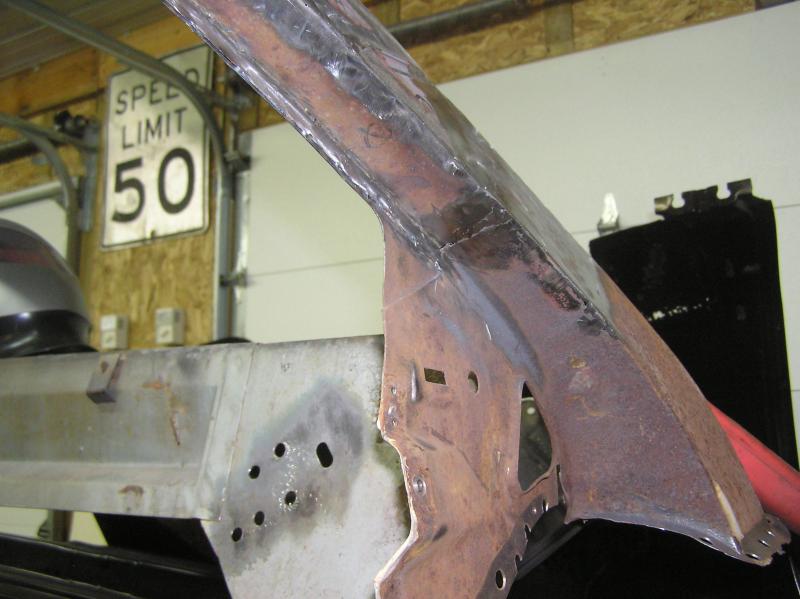

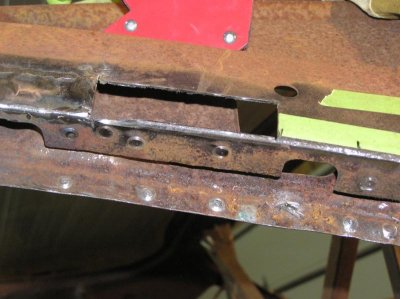

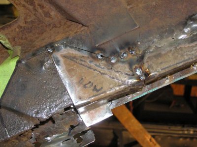

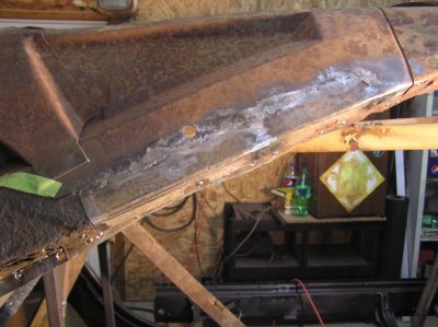

1st, I marked and removed the quarter panel reinforcement bracket.

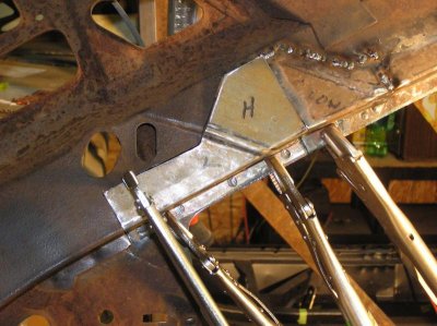

1st patch welded in.

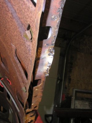

The metal where the 90 bend was good so I did not have to replace this.
I let the metal extend out over the bend, then came back and welded underneath
pardon the turkey poop weld.... I'm still learning!

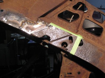

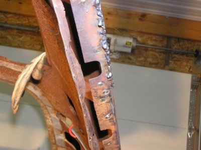

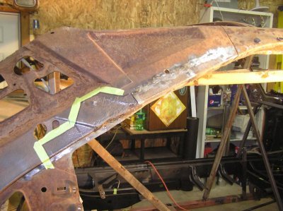

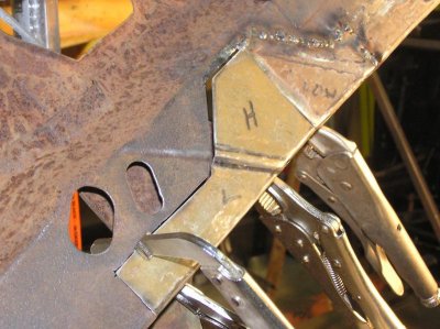

3rd patch
In this sequence you can see a little better how I did it
You can see the overhang a little better here
and here

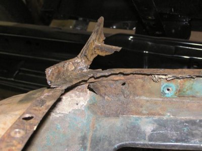

Rear window lower corner

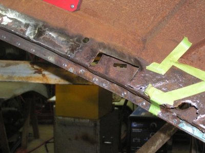

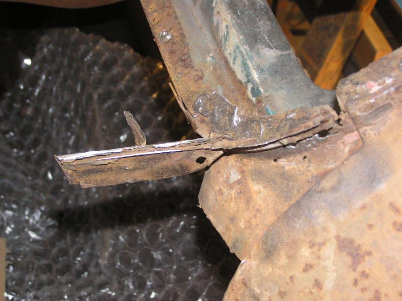

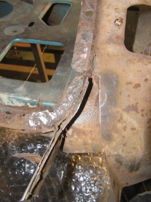

Decided to take a look at the pass side, rear lower window corner.

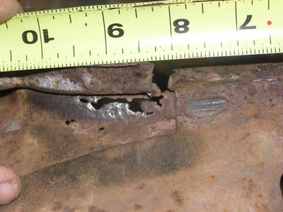

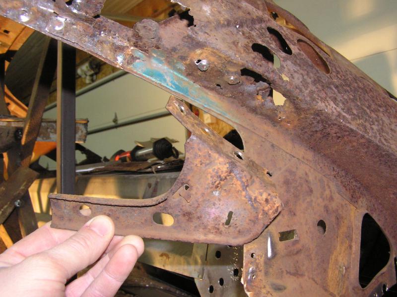

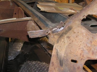

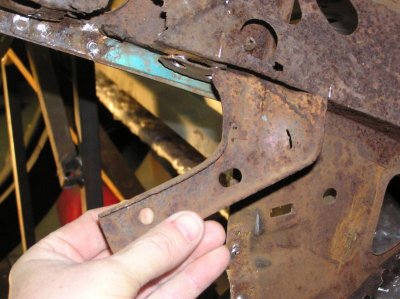

These 1st few pictures show what I have to work with. You also see this bracket.
I believe it supports the deck filler panel and trunk gutter.
I was careful not to cut it when I removed those panels.

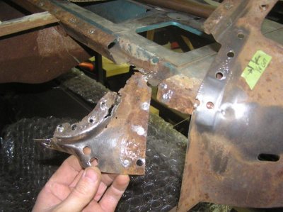

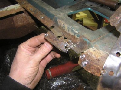

Once I removed that bracket (drilled out the spot welds and carefully removed it)
I drilled out the spot welds in this corner support
and removed it

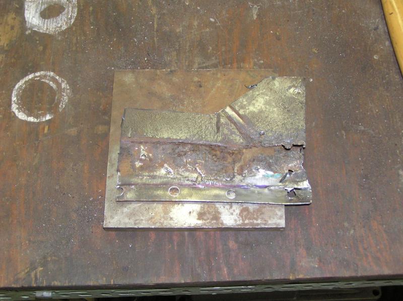

Before I removed the corner support I sectioned out a piece the lower window frame.
I did not get a good picture of this, but here I am showing the piece that was sectioned out

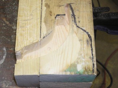

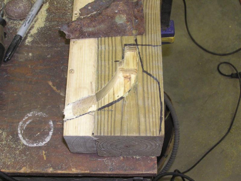

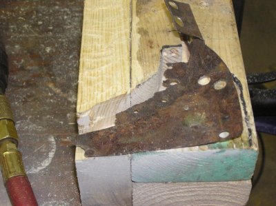

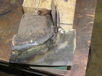

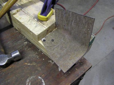

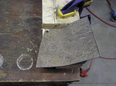

Forming the window corner

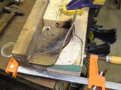

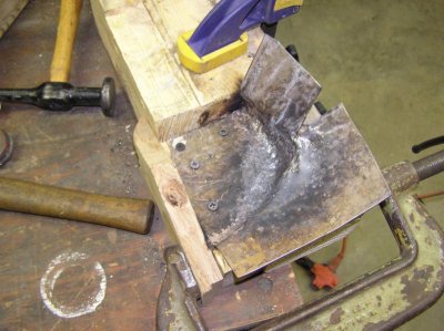

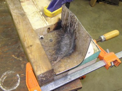

I had this idea that I would make a wooden form and try to form the window corner.
I started out with a chunk of wood, then using my router and grinders, I formed the wooden buck.

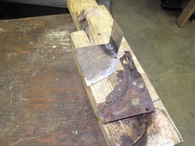

Now came the time to try and form it. I was a bit concerned that it had to form into a tight corner, and I wasn't sure it would work. But hey I came this far...
so I put in a piece of metal, and started hammering away....
I had to apply heat, it helped a little
I had to abandon this plan as the metal got to thin in that tight corner I was worried about!

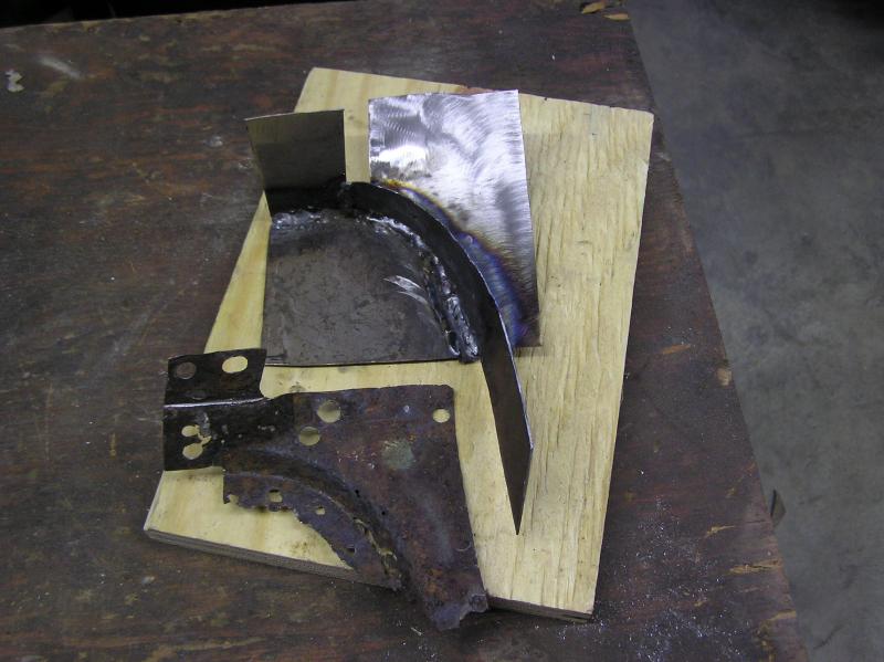

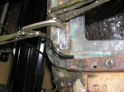

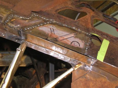

ON to plan "B"
This time I'll form it by hand.
Here you can see I'm fitting the corner and the lower window frame patch
