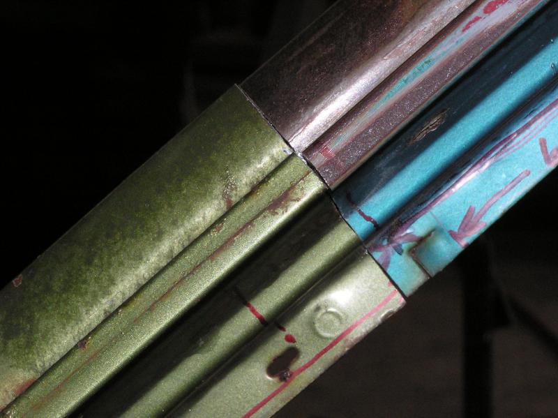

Don't know what it's called in metal work ..but wouldn't a scarf join be stronger than a straight join?
I do luv your work though!
Yes polara you are right. Stay tuned and you will see how I did this joint.

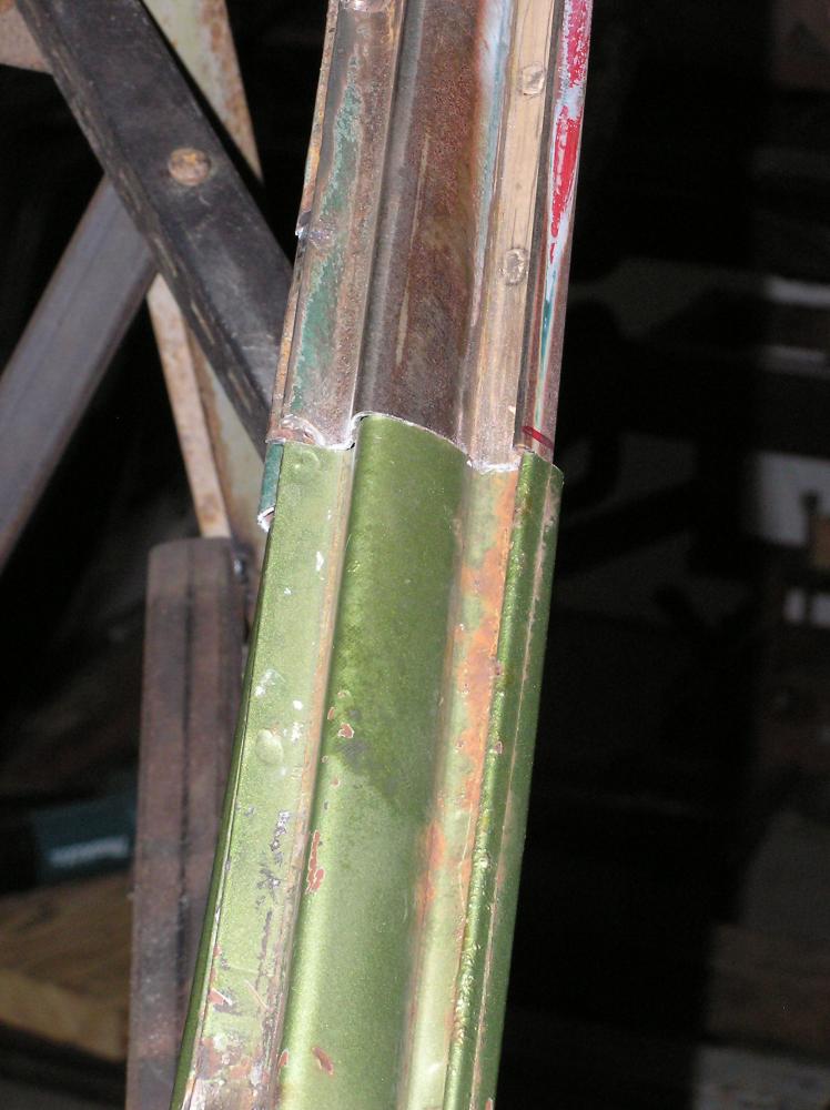

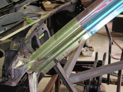

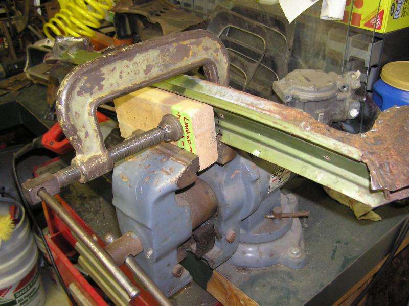

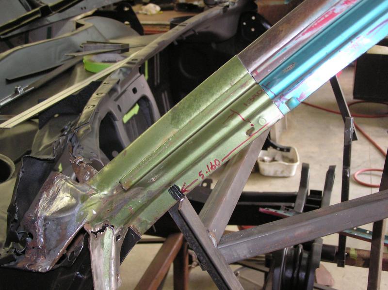

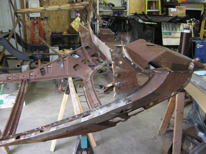

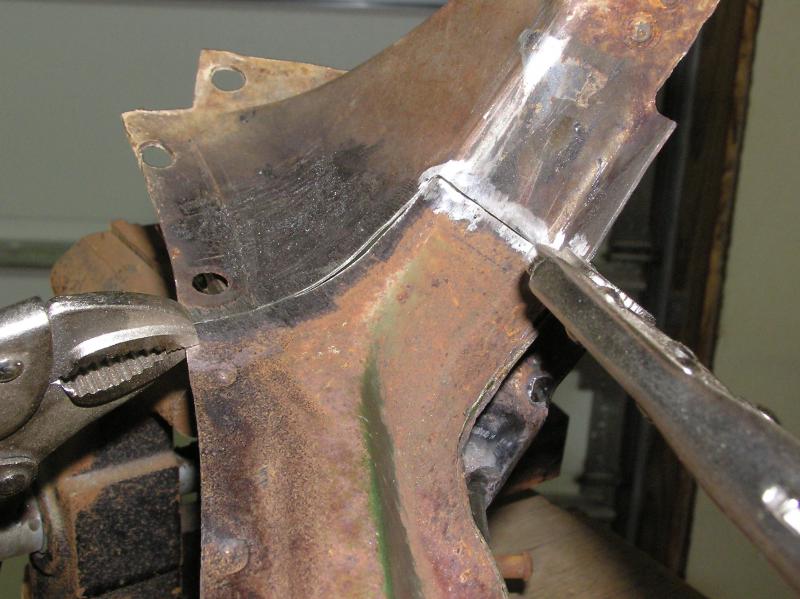

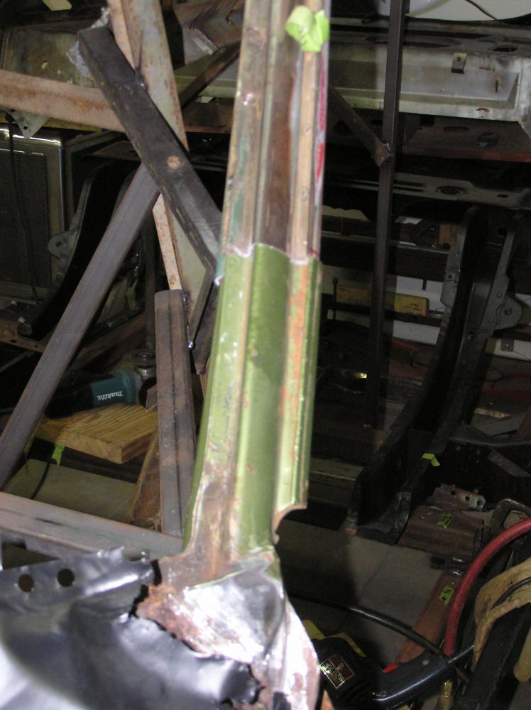

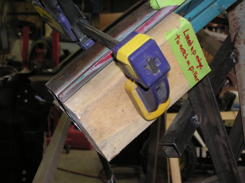

Cut the donor A-pillars

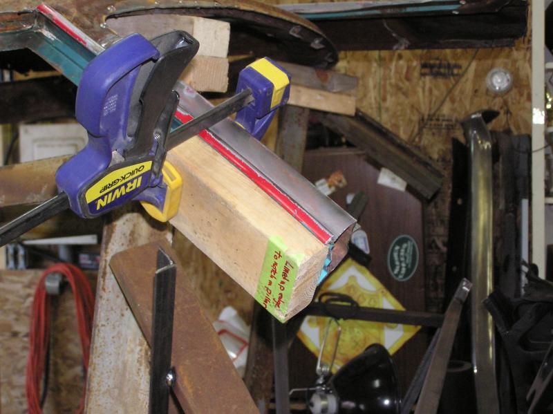

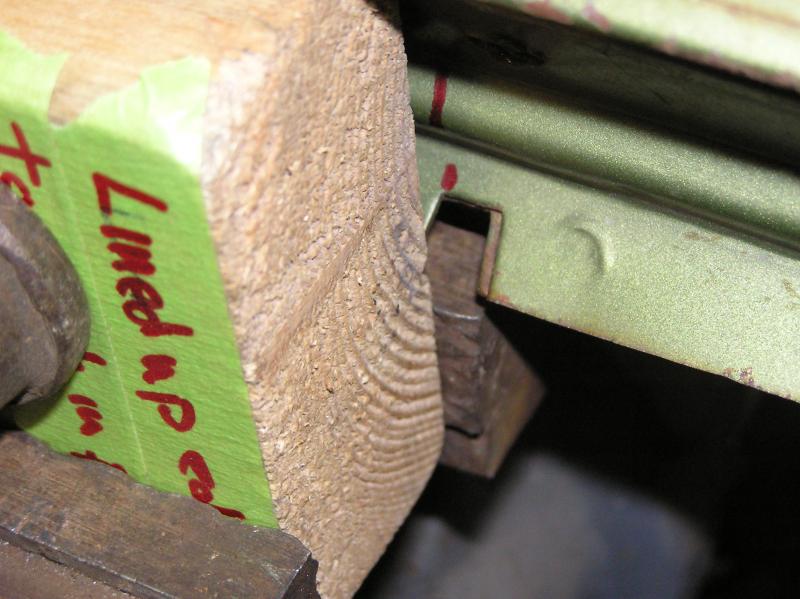

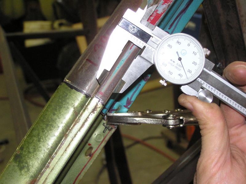

Next I took the 2x4 and clamped onto the donor a-pillar the exact same way. Except I moved it up on the a-pillar so that my donor section would be a little longer. (to allow for fitment, and error)
Then I used my sawzall and cut off the donor.

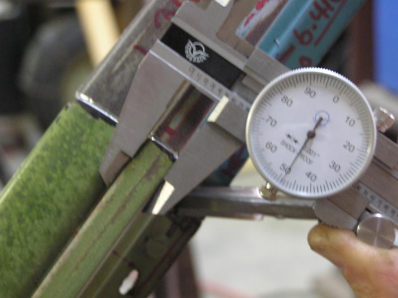

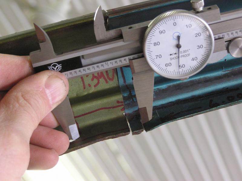

Put it back on to compare to the jig numbers and was pleased!
Cant get any closer to a 1/16 over than that.
The only thing I noticed that was different, was were the drip rail trim goes. About .015 diff.
I'm sure I can blend it.

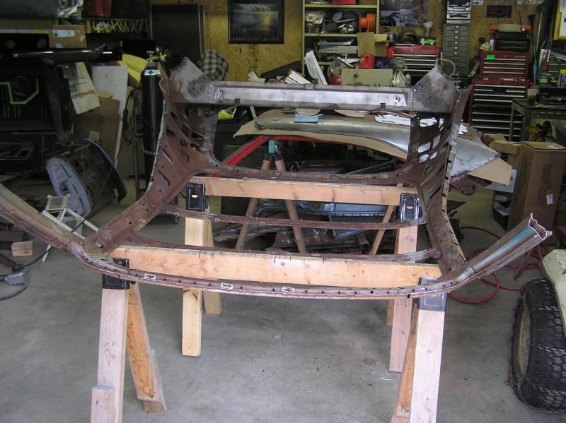

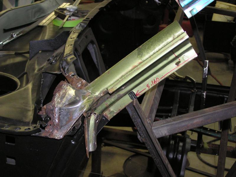

More A-pillar work
I hope I'm not boring you guys! :sleepy4:
Let me know if it's to much detail. Or if you have any questions feel free to ask.

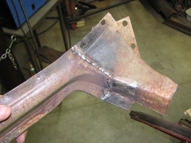

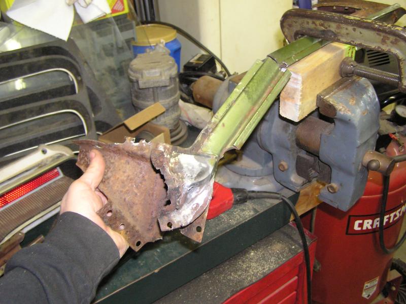

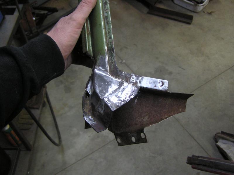

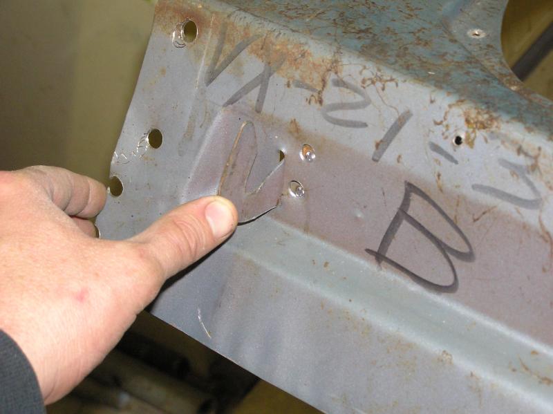

I cut the pass side a-pillar the same way as the drivers side.
Apparently this is the only pic I have.. sorry.

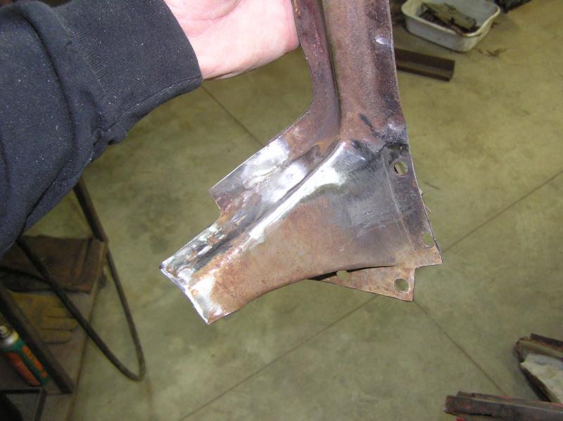

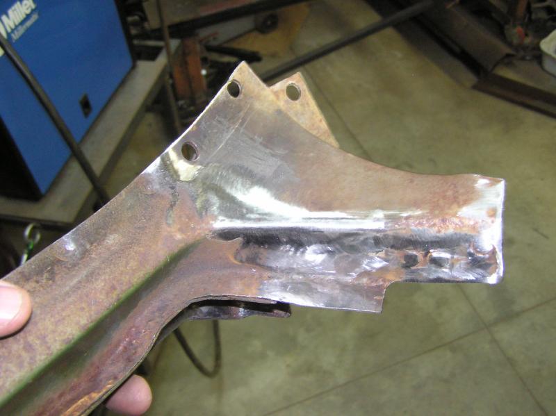

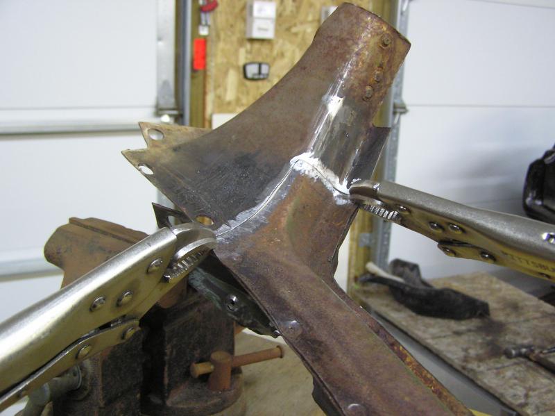

Also did a little patching on the donor a-pillars
P1010112.jpgP1010114.jpgP1010115.jpgP1010116.jpgP1010118.jpgP1010119.jpgP1010120.jpgP1010117.jpg
I think you're the wrong kind of surgeon with these skills! beautiful work.

Awesome work! I was looking to see if you had shaved off the drip rail, thinking about doing that to mine while it's in the body work stage. Haven't decided if I'm brave enough to try it yet. Seeing the pictures of your drip rail removal gave me a lot of information. Thanks and keep up the great work!
So Pappy, If you shaved the drip rail off, it would not be able to have a vinyl top right?
Cause the drip rail has the stainless trim, that helps hold the vinyl and hides the edge.
I'd kinda like to see some pics of Chargers with this done.

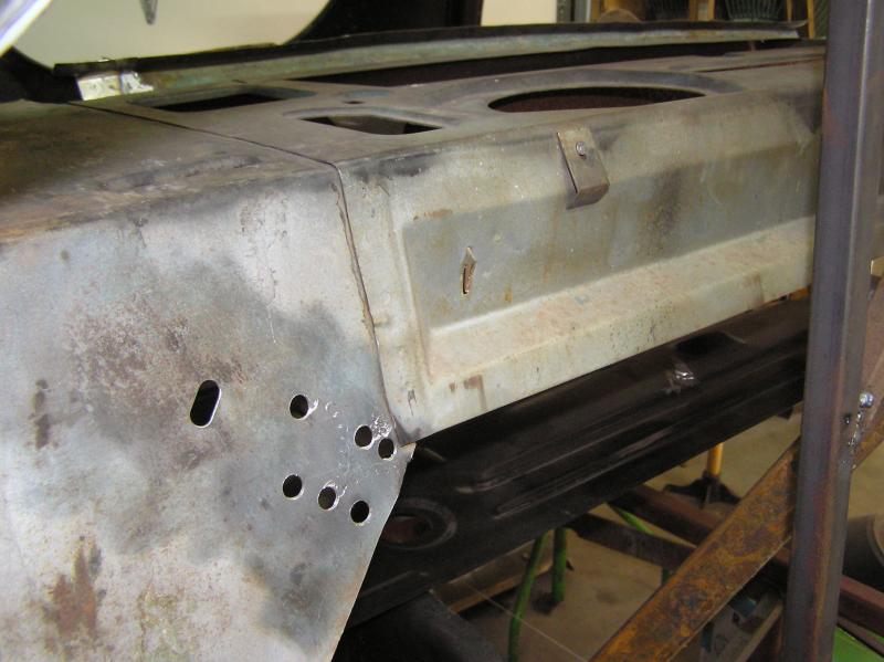

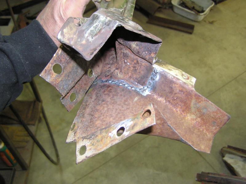

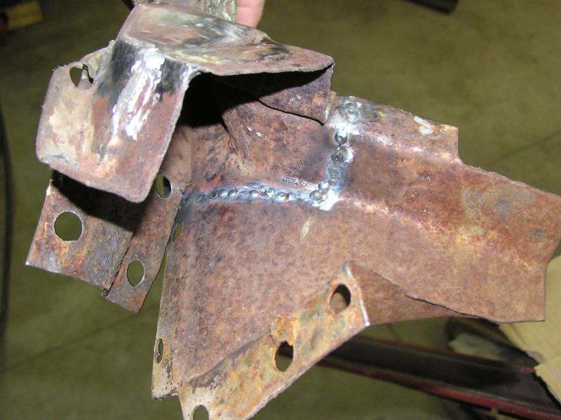

Rear seat hook fix

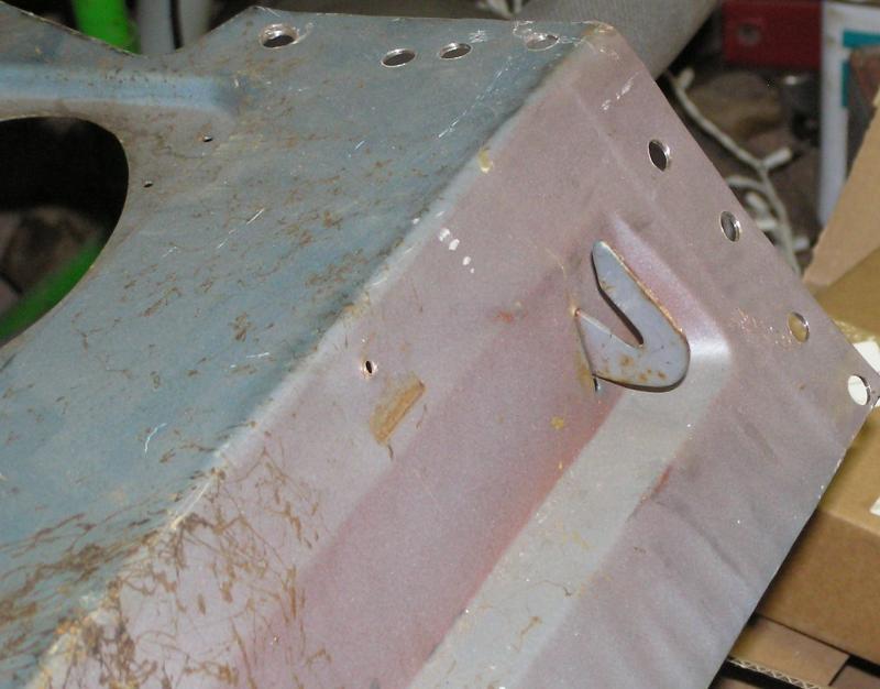

I noticed that my rear seat hooks were broke off the package tray support
I checked the package tray from the 4 door Coronet that I had parted out (I through nothing away)
and BINGO, I have one!
So I spot drilled it out and welded it in. (sorry I didn't get a pic of it welded in)
That's correct. Mine did have the vinyl top but I'm not putting it back on. I've decided to stay away from the drip rails. Looks like way more trouble than I want to bite off. I'm looking at doing something with the trim to give it a more updated look. :)

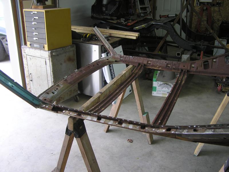

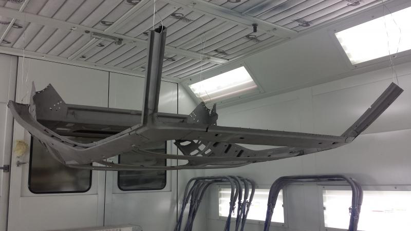

Off to the Blaster

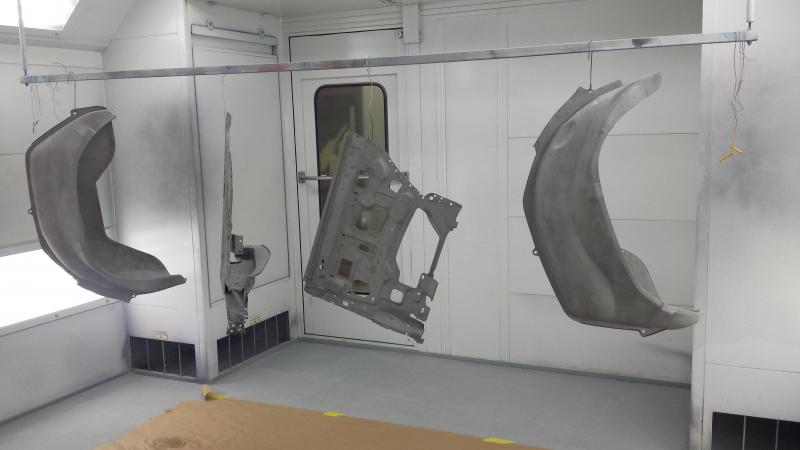

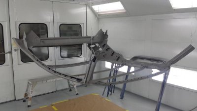

Ok time to get the roof support off to the blaster
Sorry I didn't get any pics at the blaster but her you can see them in the paint booth just before painting them with some epoxy primer.
