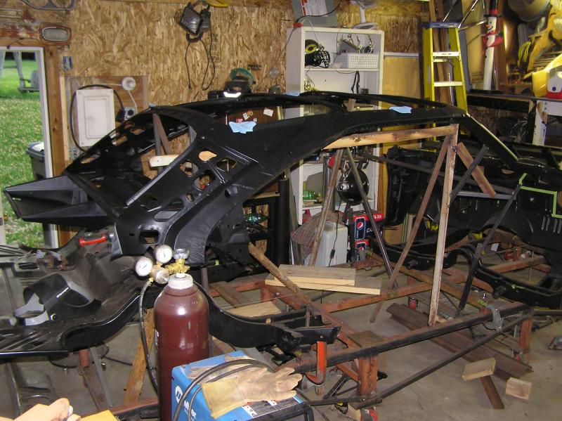

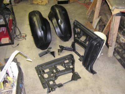

Parts in epoxy primer
Here is how they look after epoxy primer.
NO MORE UGLY RUST!
:yaayy::yaayy::yaayy:

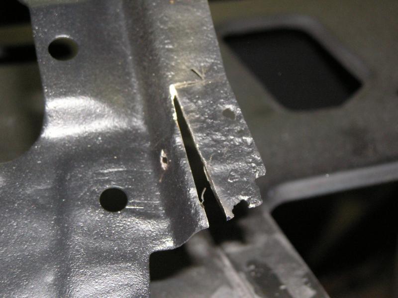

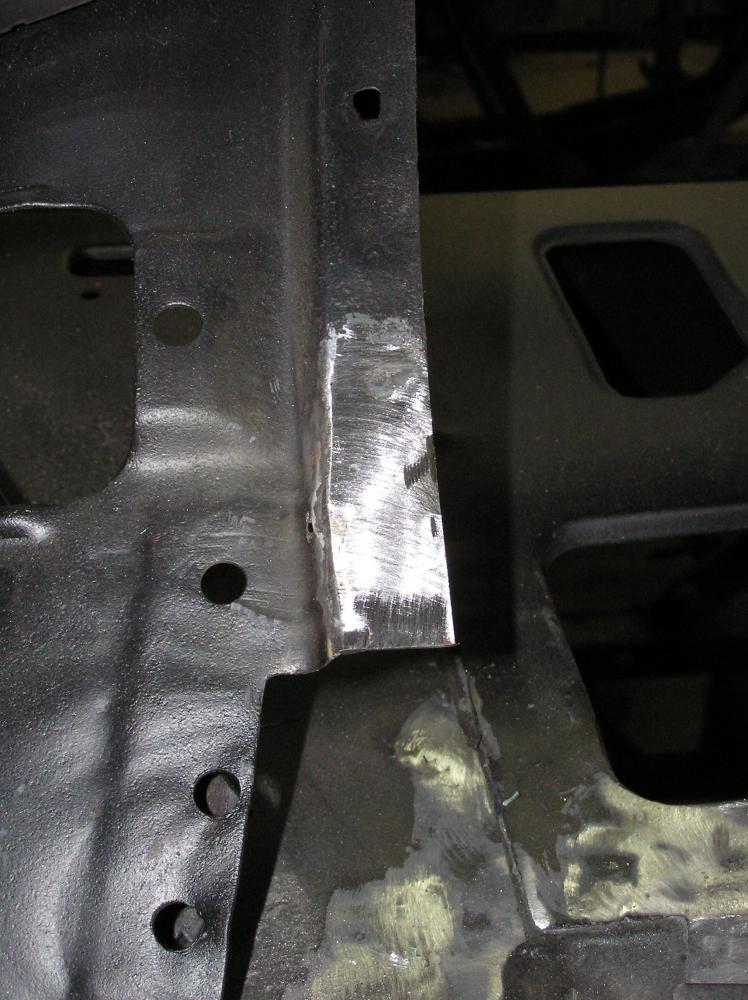

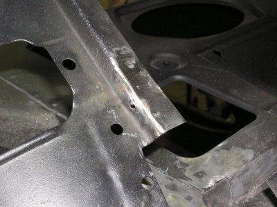

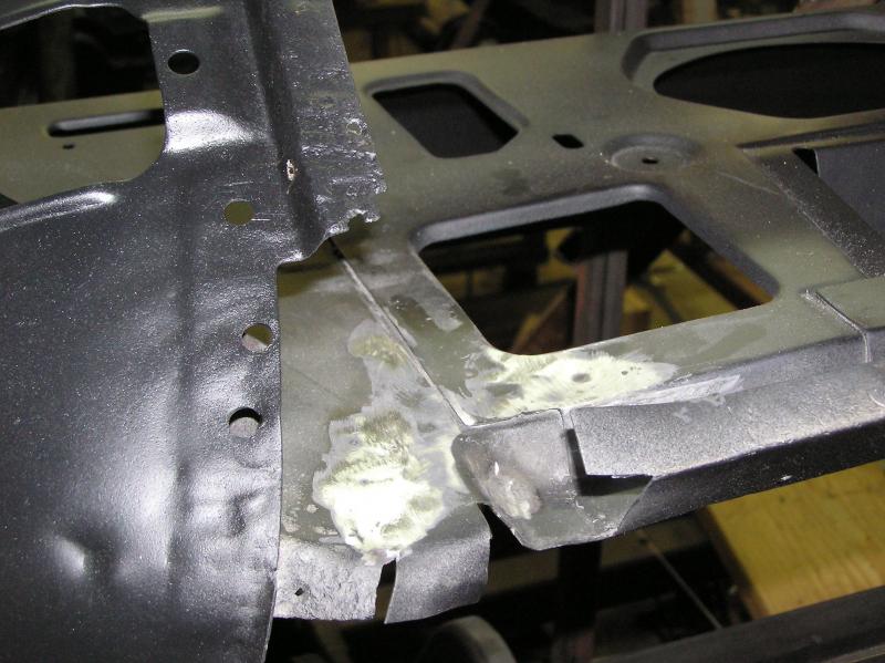

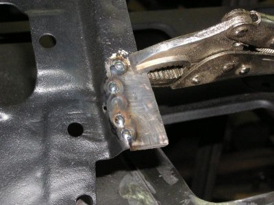

More patches
I had to fix a few more areas around the rear window. Here is one of them.
I had a few pin holes in the package tray (where I had put in a patch) Thats why the primer is ground back.
And yes I did come back and fix this hole. (I just did'nt get a picture)
Looks as good as it was before the rust made you fix it! great work with the finish!! :)
Thanks Ron, I am not a "paint guy" but that epoxy primer sure "wets" out nice!

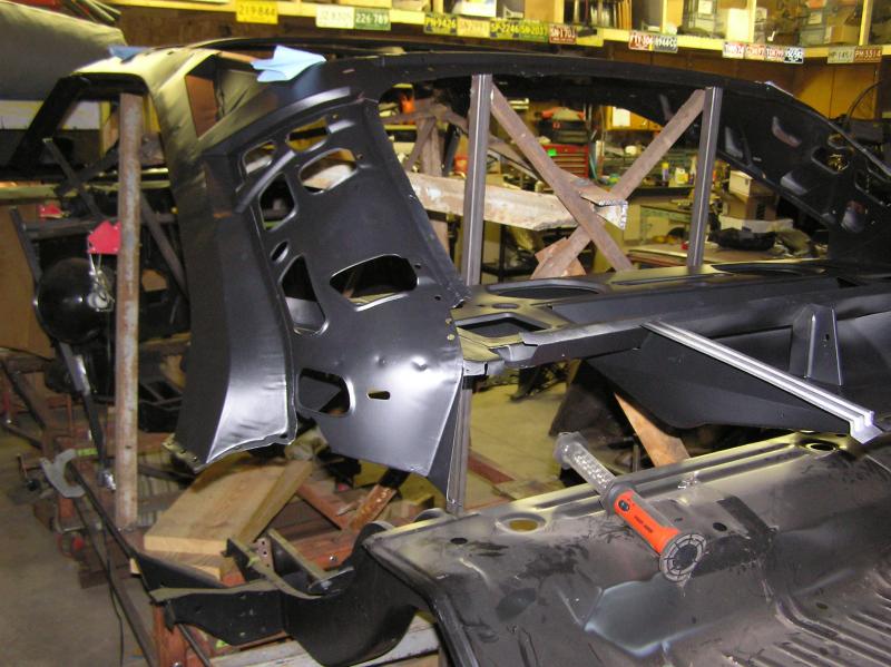

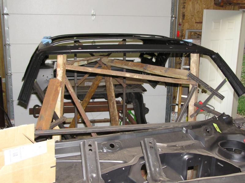

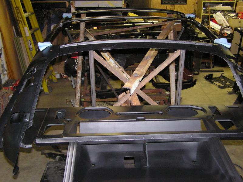

I have been watching several similar projects, and I was wondering what will you use as a reference when you are rebuilding your floor and welding to your rockers. and frame rails for critical structure.? this is the first time I have seen the method you are using it looks much simpler than using a body jig and removing one section at a time. I ask because I am planning a project and I want to avoid problems with panel/ window glass alignment, frame straightness, etc. Thank you for all of your posts so far . very helpful!
Hi Coronet66,
As far as a reference to go by. Before I took the car apart I measured as much as possible.
(distance across, diagonals..... any dimension that might help me get it back together properly)
From what I understand, if everything is close, the floor pans should drop in with minor tweaking.
The reason I am doing it this way is I replaced the front clip, and rear frame rails, and inner rockers, with parts from a donor car. For me, this seemed much easier (and faster and cheaper) than fixing countless areas of frame rail, torsion bar crossmember, and inner rockers.
Believe me when I say I am a bit nervous of everything going back together properly! (panel fitment and gaps)
Right now my plan is to get it back together just far enough to get the frame alignment checked! (no floors)
