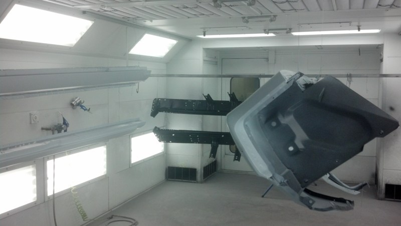

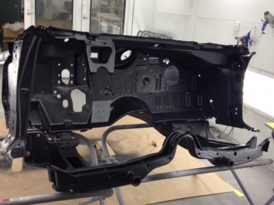

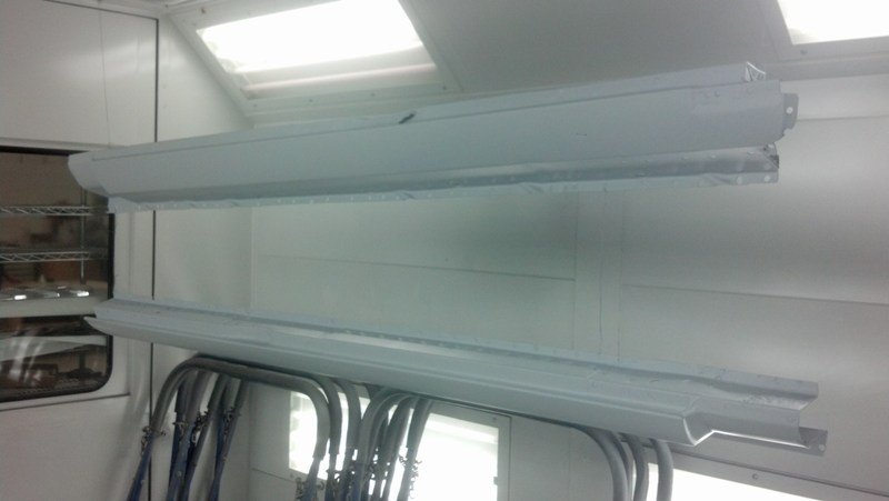

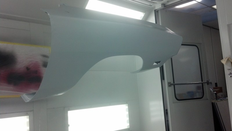

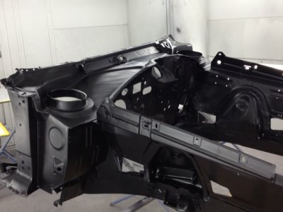

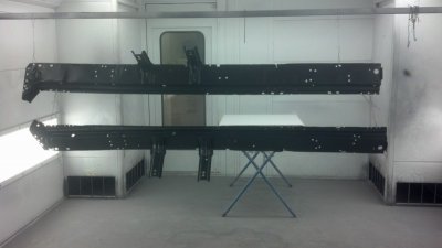

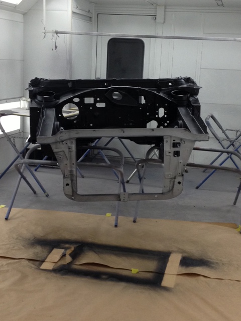

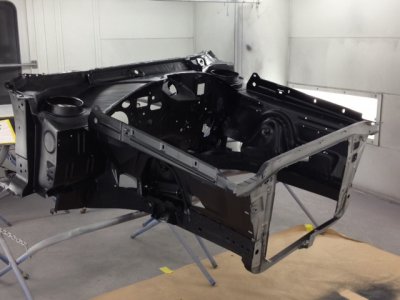

Here are some pics of the Cornet front clip after it got epoxy primed
Man, that is one big undertaking but everything your doing looks great and I'm sure the finish product will look great as well. Keep it up

Thanks 747, It has been a HUGE undertaking to say the least! I have put a lot of time into the car and I am still not even close to being over the hump!

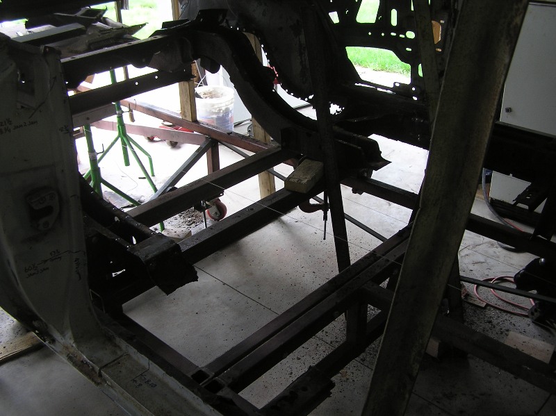

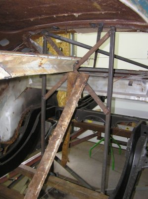

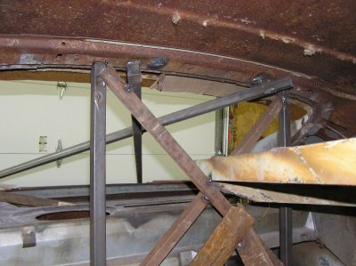

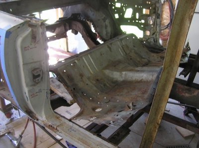

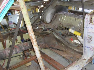

Here is your step by step......
1st I added bracing to locate the front half of the roof.
The bracing goes all the way down to the frame jig and is welded only at the jig.
I did not weld the bracing to the roof. I did this because I may be replacing the entire roof. :yes:

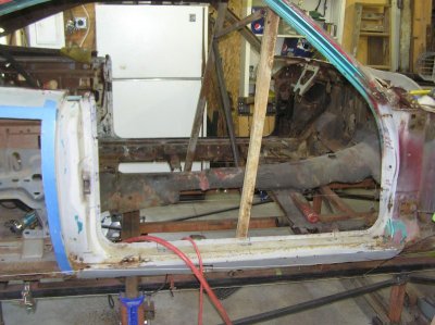

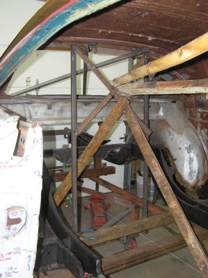

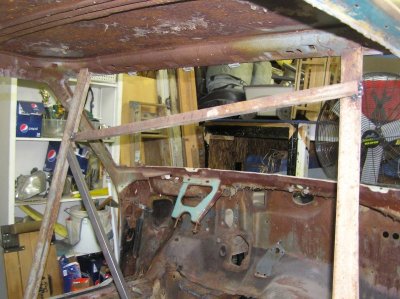

Next I removed the rear seat floor pan
Then I added more bracing at the back half of the roof
Thanks speed, with what I have planned, it better not move!
