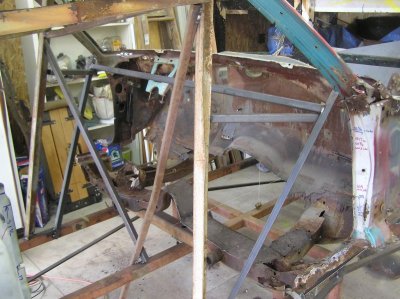

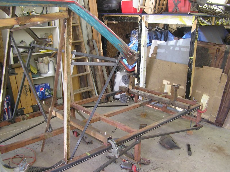

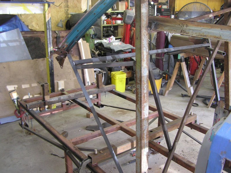

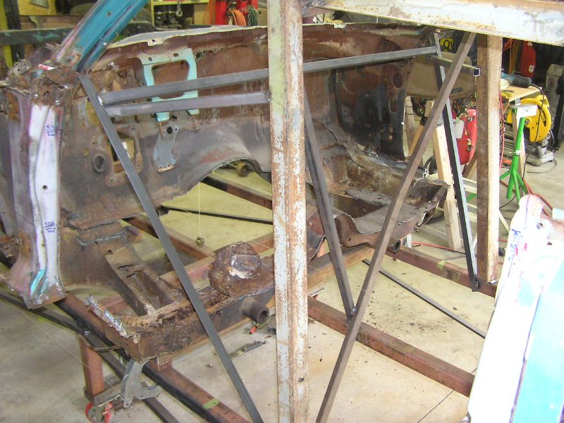

Front clip removal
Ok before I remove the front clip,
I thought the front needed a little more bracing....
I notched the outer brace so it will locate the lower part of the a-pillar

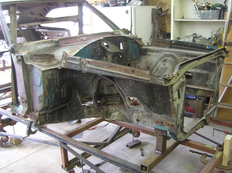

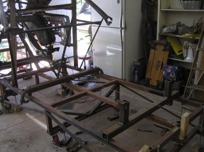

Now you see it.....
Now you don't....
WHOA . . . Now I think there's more of the car missing then actually there . . . and I thought I was in deep . . . NOT ! !!
