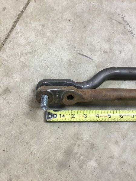

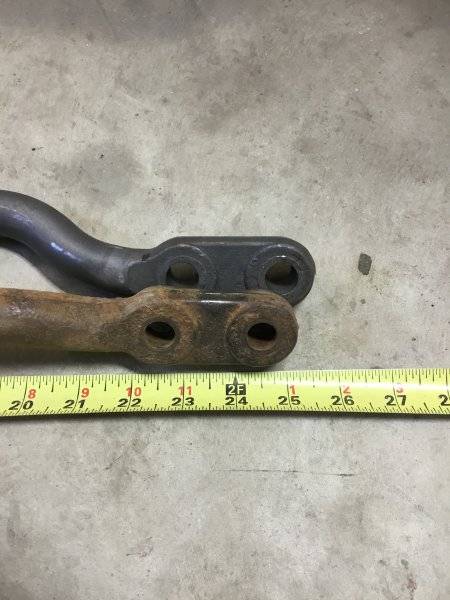

Dropped center link from Mancini or 440 Source. Where is it made?
Many moons ago, I had an aftermarket BB oil pan interference issue on my '65 Coronet. I took the original center link out, cleaned all of the paint and dirt off and added another piece to the bottom, welding both sides a couple of inches in from the curves. I don't recall if I heated and bent the new piece up in order to get more weld area. Anyhow, then I simply cut the unwelded part of the original out. Worked well.
