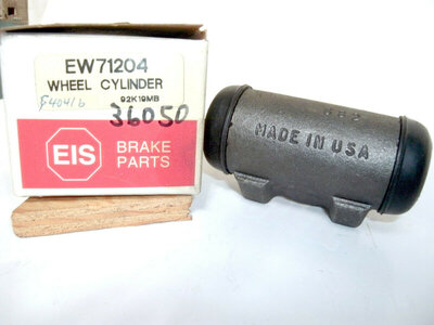

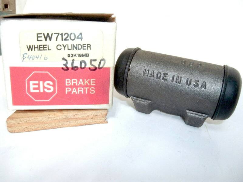

Eis Front Left Wheel Cylinder. Old - but new in box!

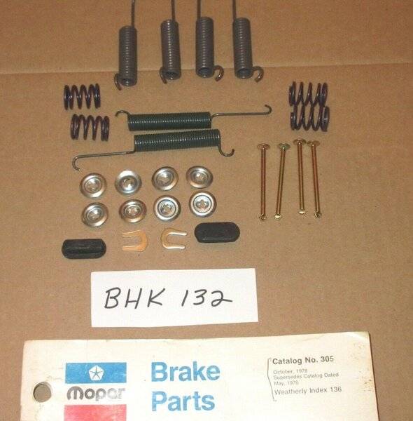

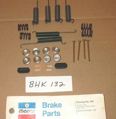

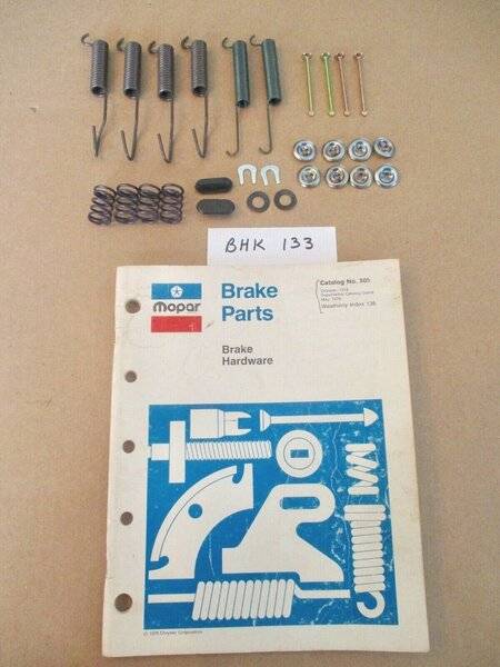

From Central Jersey Motor Parts comes the '69-up hardware from Ma Mopar herself
(NOS)!

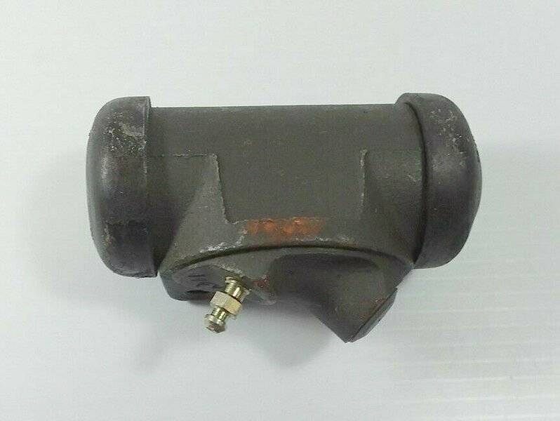

Raybestos right front wheel cylinder - old but new, shows some shelf wear. USA of course! W36051

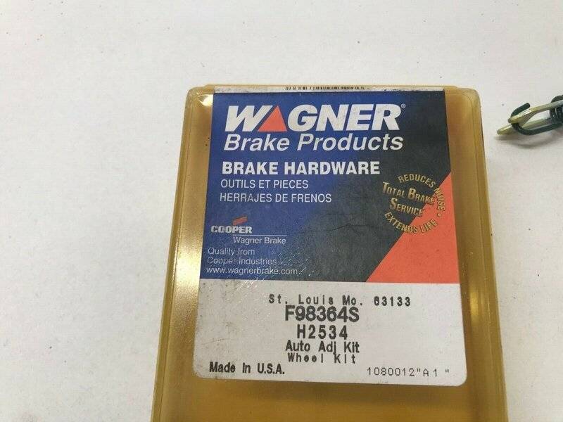

Quantity: 2
Wagner H2534 Self-Adjuster Kits (Left Side).

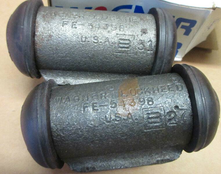

The rear Wagner-Lockheed wheel cylinders you know about already. I have them in hand, in fact...

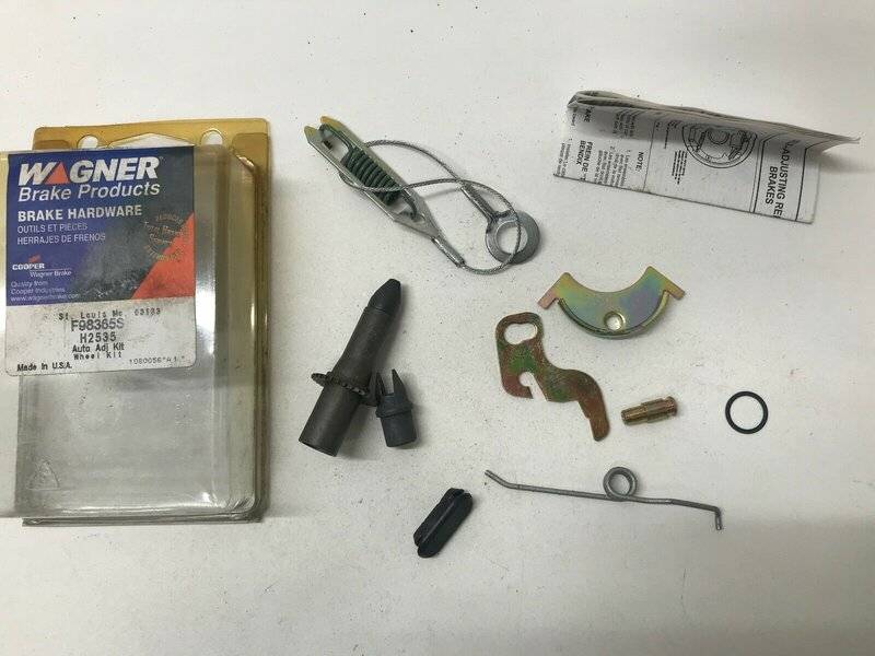

Lastly, H2535 Wagner Self-adjuster hardware for Right Sides - (2) sets, of course. Made in USA!
(NOS)!

I went with some rebuilt cylinders or they might have been manufactured using the original castings. Maybe they were assembled out of the country (China/Mexico) but the castings were OEM. Found them at NAPA.
Linings were a PITA. Wrong frames, damaged lining, you name it. The '62 had a set of new replacements on the front that might have been installed years ago and never driven much so I used them. The rears were sourced at NAPA also but like stated went through several sets just to find a set. I was on a budget and some day I might replace them with a aftermarket grade. "Brakes in a Box" comes to mind? Carbon fiber lining? It's been awhile.
USA all the way! Canada is great too but I don’t know they made the stuff for brakes.
Thanks Ed! Much appreciated!

Really with shoes, it's either aftermarket Chinesium or high-dollar "custom" stuff from either of these places.
That's it, short of getting lucky and finding some old new stuff (yes, like our resident NY fella here that I chose
not to deal with this time around).
