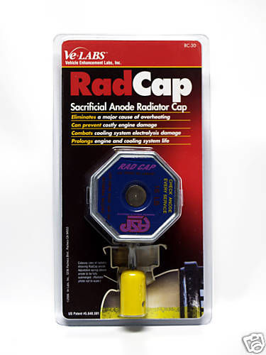

Here are two very good links with knowledge and info about this problem. The first has a lot of knowledge info and the second has some great products to help fight this demon as well!!! Hope this helps!
http://www.sancarlosradiator.com/VoltageDrop/index.html
http://www.ve-labs.net/
