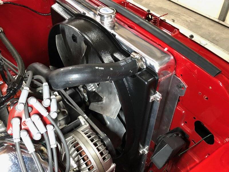

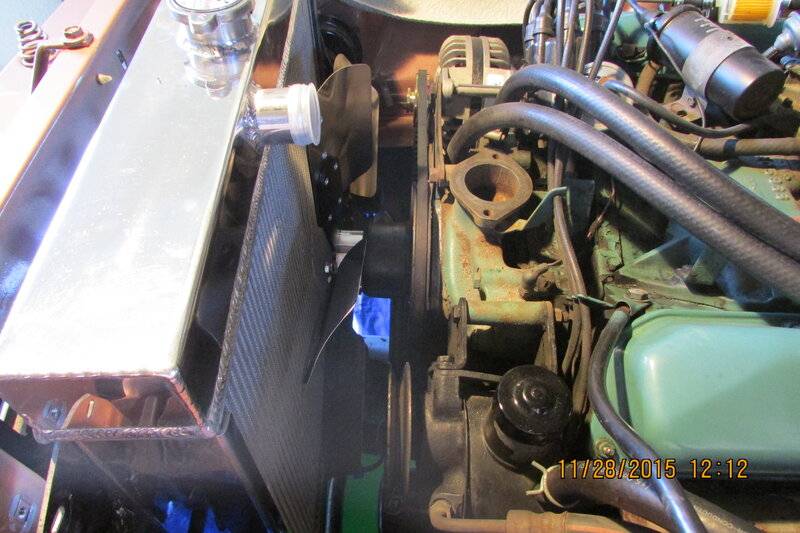

Curious. So what's the actual fan - radiator clearance you have? What type of engine and trans mounts are you using?

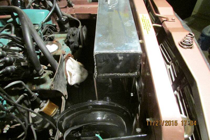

It's not a fan clearance issue Dave..its a fan clutch to core issue..less than 1/2". As far as engine/trans mounts and everything else this car is bone stock. The 3rd core in the Glen Ray radiator is the issue.
Its the ONLY thing changed.

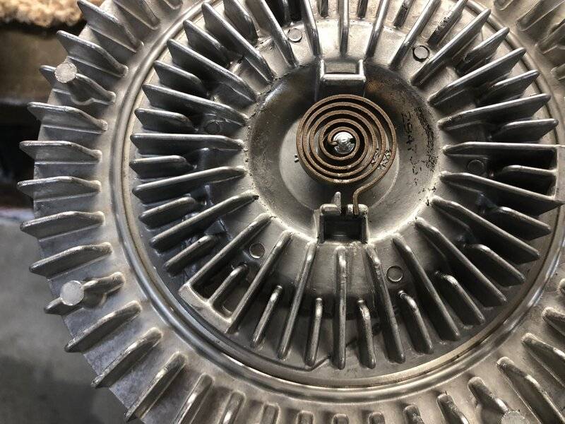

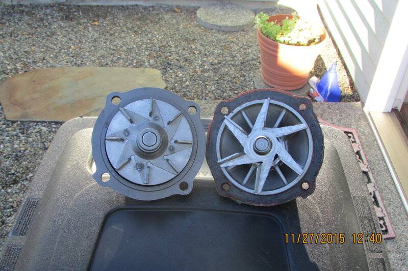

Kinda' ironic, I had the water pump off and was going to upgrade the 2765 to the 2947 because it just never seemed to have much resistance/air flow, saw this thread and decided to "adjust" the the new one.
You just filed a new slot and unwound the spring by 1/8"? How much change will that make do you think?
Being's I'm a "noob" fan clutch adjuster, I don't know, but when you pop the spring out, it will only turn the shaft about 90° and when you put a lil' heat on the spring, it's amazing how much it moves. I don't know if I even needed to do it, but I definitely needed more "wind" than I had, I was going to put a solid hub in but thought I'd try this first, so far so good, I blocked the rad. to get it up to temp so the thermostat would open, got up to 185, pulled the cardboard and went right down to 170, I'm only running a 22 radiator and slow moving/idle is where I had my concerns.
And yes, hack sawed a new slot.
One half inch space to the radiator with a clutch fan may find your clutch chewing into the radiator just deep enough to require radiator replacement.
Been there, done that. As the clutch heats up, that gap gets smaller.

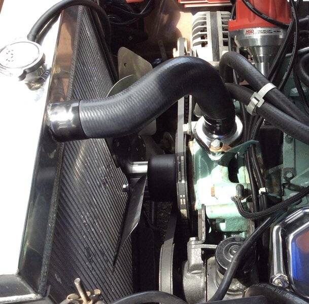

I run solid motor mounts on all my cars, and still would want more than 1/2" clearance. No way I would chance it with rubber mounts.
I've been driving this car for two years like it...it's fine. All this came about when I needed to replace the alt belt and couldn't get it over the clutch without destroying the core. So I just pulled the rad and slipped on a new belt that in all reality I will never have to change again. Like I said I previous post, the 3 core Glen Ray is a necessity and it's staying.

That's what I have! Can you measure it?
I'm confused - if you have the same unit, why do you need someone else to measure it for you?
Lookit, bottom line:
- You're hard set on the radiator you have; that's a set point of the equation, short of modification of the
radiator support.
- Your engine, without something getting modified there, is the opposing set point when added to the shortest
known fan clutch (the Hayden "Jaguar" unit you have now).
- You've stated you're fine and dandy with the 1/2" clearance between clutch and radiator (despite repeated
advice that you shouldn't be).
- The whole point of the thread (I think?) is that you can't service your fan belt at that spacing, though.
So....either you're fine with things the way they are or you're going to have to be willing for something
in the equation to change; one of those "set points" has gotta give in order to gain more clearance.
That's where we are here. So....what's the decision?
Because after the comparative measurement was posted it was confirmed. Go back and read my previous post where I said I have reserved myself to just pulling the rad if I ever need to replace the alt belt in the future. Thanks to all who replied.
