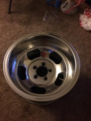

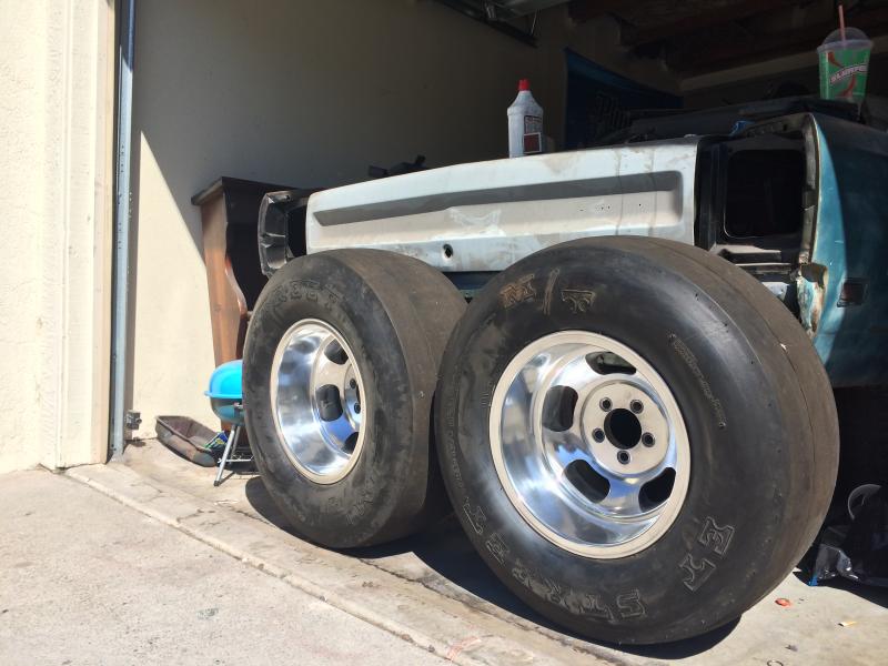

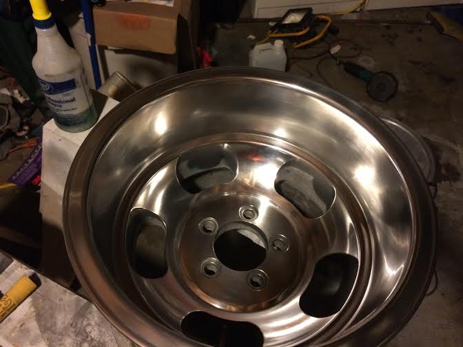

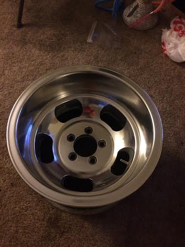

So spent some time on the wheels. A lot of sanding and just started polishing.

those slots look great!

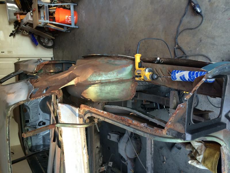

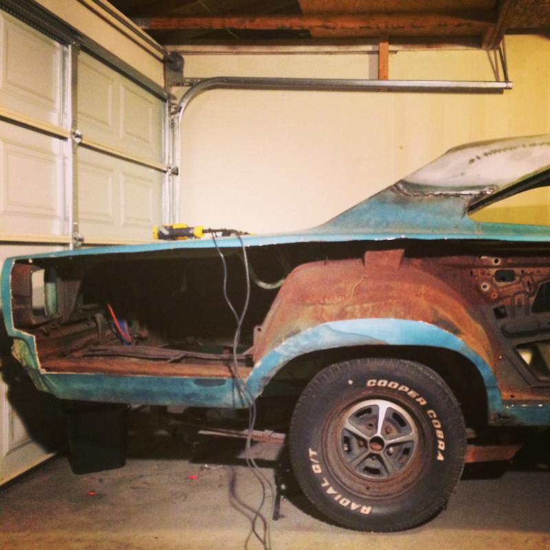

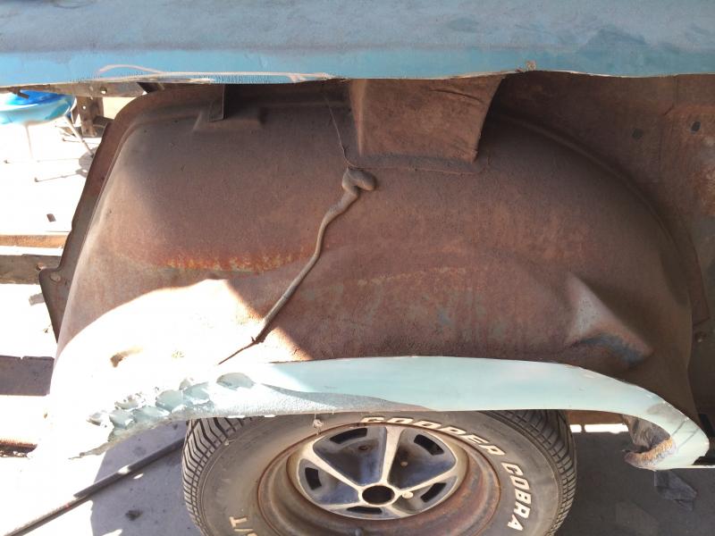

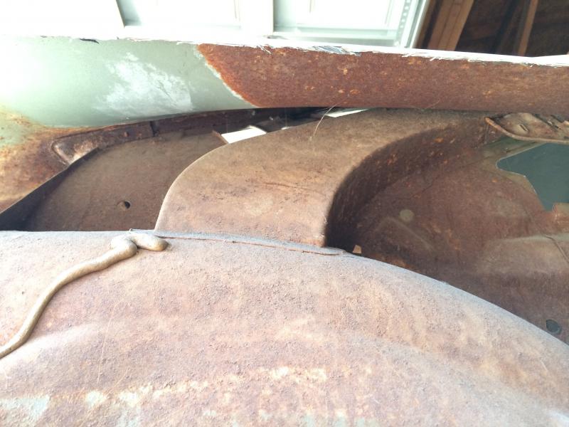

So right now I basically cut the quarter "skin" off to access the wheelhouse and Dutchman panel. What would be the easiest way to go about replacing the Dutchman panel... Should I fit the new Dutchmen panel to the old quarters. Then completely remove them. Or should I leave the old Dutchman panel and fit the new quarters to that.... I'll be waiting on some insight before I dig any further into the car. Thanks guys image.jpgimage.jpgimage.jpgimage.jpg

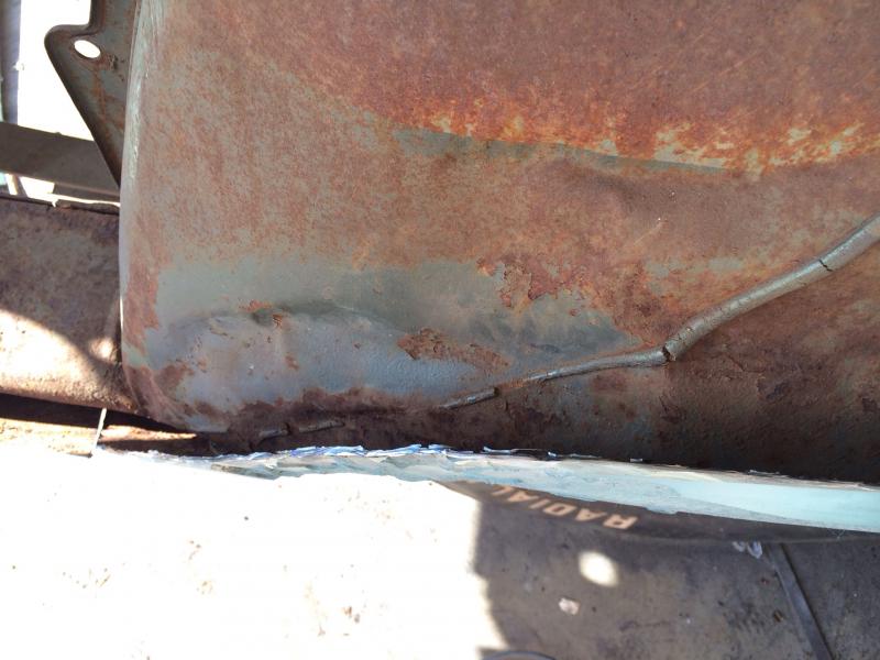

Tiny bit of wheelhouse damage in the lower section from the hit. But nothing serious. Luckily I'm dehumping the wheelhouses so it won't pose any problems..no cancer behind the quarters so I consider myself lucky.
Here's the slight damage. Almost looks like the car just bounced off two guardrails..Possibly down a drag strip? Hahaha

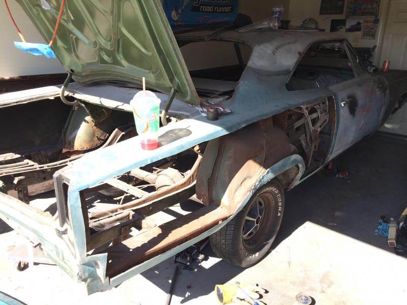

And bondo bondo bondo View attachment 217265 the quarter skin I took off weighed double that of the new quarter...must be a whole gallon on just the skin alone
I had the same thing on mine. No rot on the wheelhouses, but gawd was the bondo thick on the 1/4 skins.
It wont bother nothing unless im missing something to put the quarter skins on it, the dutchman can be replaced later im sure, BUT be comfortable in how you build it, we have to enjoy the build... Thats how i look at it, i love this stuff!!!

Thanks for the tips guys.. I'll have to check out your thread in a bit. Also the car isn't getting skins it's getting full quarters. I just didn't want to pull the whole quarter off yet but wanted to see the condition of everything behind it.
Mine got full quarters too, plus trunk floor, extensions, Dutchman panel (and a couple of inner repair bits) outer wheel houses and door skins...
Cool I'll have to check out your thread when I get done organizing my garage. Can't work in a messy environment hahaha
Guess, i missed the full quarters but don't think it should be a problem... Im replacing everything from the back of the doors to.. the back, lots of stuff but, its part of it i guess, you'll get it and maybe it is better to replace one thing before the other, i don't have a problem learning, just doing lol.. Good luck..:)
Checked out your thread hsor. You and your body shop have been doing a great job on your car. I got another question for whoever knows. At the Quarter/Dutchman panel seam. Did the factory use sealer in between. Is there a tooled joint of sealant on top or is it just painted. Hard to tell with my car

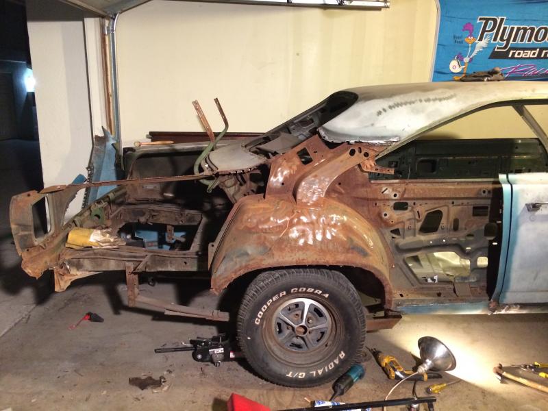

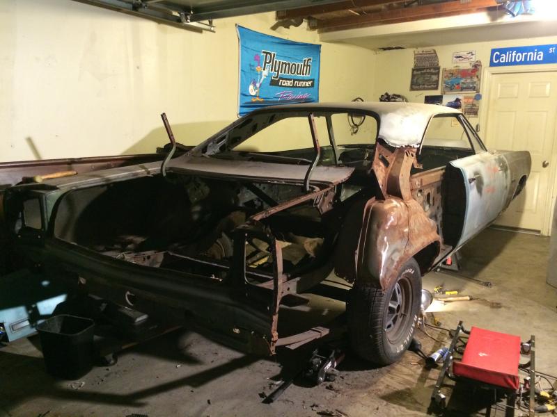

Wrestling this quarter right now. Hope to have it off tomorrow. I never ordered the window corners for the car so I'll find out how these ones look when I get the quarter off. Crazy to think once these quarters go on the majority of sheetmetal work will be over other then little things here and there. image.jpg

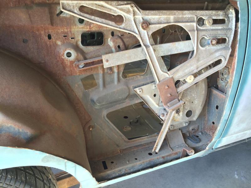

image.jpgimage.jpgSo here it is as it sits at the moment. Separating the quarter from the wheelhouse was a nightmare haha. From all the previous hammer work it was very hard to tell whereabouts the spot welds where at.. Just have to get this last little piece behind the door off and we are good
