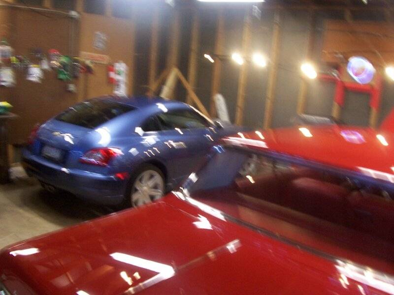

I have over 6" of concrete in my shop, but unfortunately the expansion cut lines are close to the left/drivers side post and my floor cracked with the wifes Sport Trac on the lift when I first installed it. Why I trussed the tops after the fact. Not an issue now even with a 3/4 Ton x 8 ' box GMC on it. The Bee spent most of a year+ on the lift, not a big deal being a coupe but I wouldn't want a hardtop up there that long as the gaps certainly open. If I win a lottery in the near future, I want a large 4 post that clears the 9' door opening and 20' long to store the Bird up top and Bee underneath, so that I have a work bay again + the 2 post hoist bay to work on day to day **** like my Daughter showing up with a flat yesterday and working on the plow truck etc...
was thinking the charger might buckle for a full winter storage . That's good info - by the way love the cars

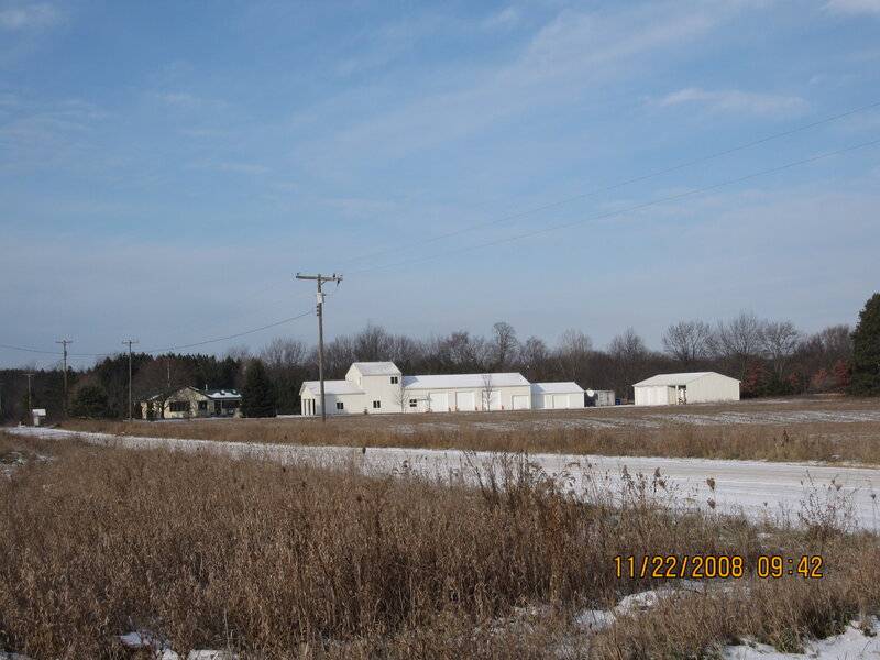

never have enough light!......I have 3X more today, than back 10 years ago(as in this pic)......
