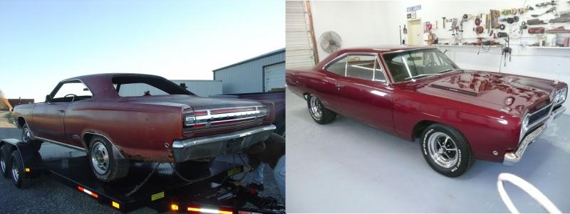

The coincidences strike me here. I also have been working on a '68 GTX for some years now;
cancer has tried to kill me a few times in the last few years; and my name is also Ed! :icon_salut:
Well, let me tell ya - it can be done, despite all of life's challenges:
This one was a lot worse than your dad's (and now yours), trust me. Floors, quarters, it's had a lot of sheetmetal replaced.
Just about everything on the car has been replaced, repaired, repainted, you name it....all in between hospitals and jobs life in general.
I've been taught the lesson to take it in small bites - the car has been a series of small projects out of necessity, as my energy levels aren't what they used to be. That keeps me motivated (oh yeah, still working on it - these things are never really done).
You just never give up on it, that's all. Sorta like life. :)

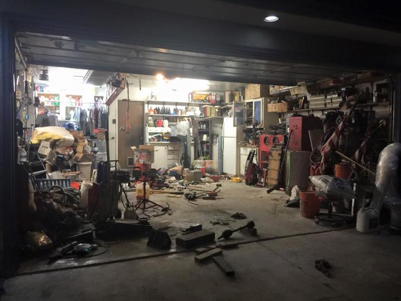

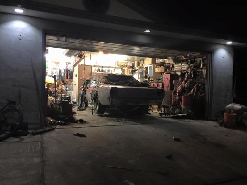

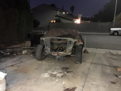

Hey everyone, I've finally gotten a little of free time, and decided to jump on and do a little update. Well I finally got the car into our garage after 13 years lol, but the reasoning why I put the car in the garage finally is extremely frustrating. Someone decided to light my trash can on fire that was pressed against the side of the car and the fire spread to the plastic tarps on the car and melted the tarp to the car in a few places:angryfire::angryfire:. So there's some places I need to re sand to get the plastic off and to fix the primer. Thank god the car was stripped! Here's some pictures.
Here's the pictures of it being moved into the garage. The garage was still a mess, but that's a lot better than it was two days ago. had some issues getting the car in the garage, the E-brake release is broke, so it was kinda gripping the back end and to top that the back left tire exploded and I wasn't aware of it until I went to move the car, because I had the truck I blew the engine out of sitting next to the car!

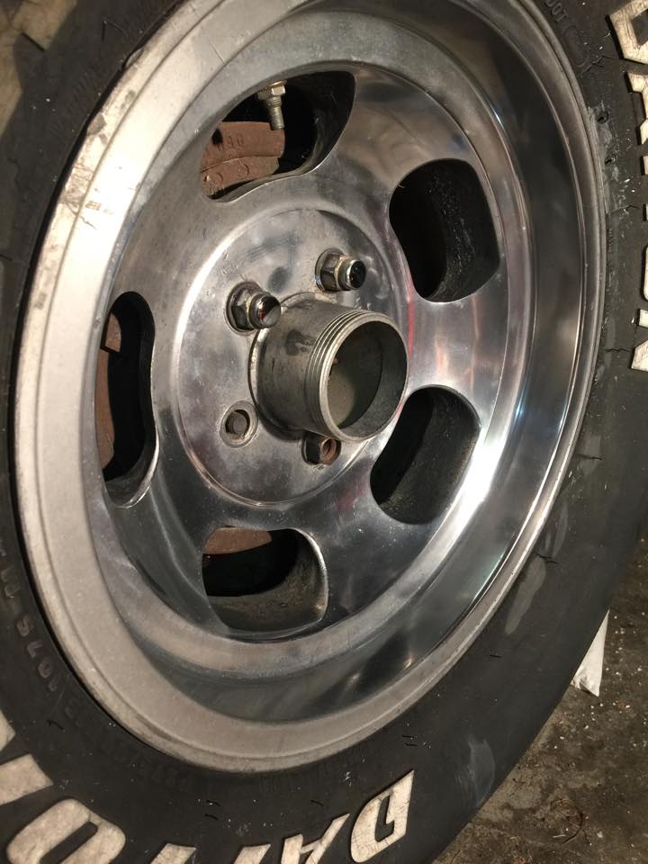

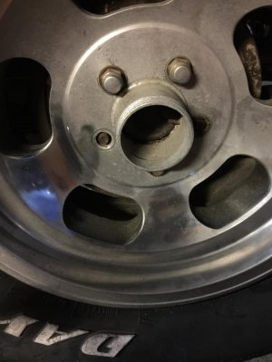

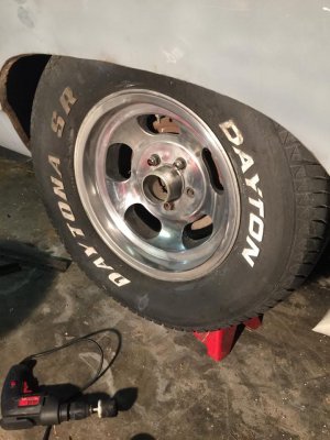

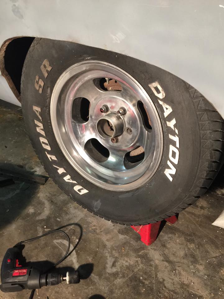

Dad and I always went back and fourth on how much work it would take to get the rims cleaned on the car, so for the first project of it being in the garage I decided to use some of this new polish I found and I just rubbed a little on hit it with a buffer that was attached to my drill and it cleaned the rim extrememly fast there's still some oxidation on it, but I didn't spend more than fifteen minutes on it! Ever have some really oxidized wheels just use some of this stuff (http://www.amazon.com/BlueMagic-400-Metal-Polish-Cream/dp/B000BO8Z9I) Works like a dream!
Glad to hear you're still kicking it! Cancer is something tough to watch someone go through, can't imagine how it actual is dealing with it. And thanks for the pictures of the car Ed! it looks great I can't wait to see mine up and running.
See that's what I always told my dad, but he wanted it to. We never even found the build sheet for the car, dad had the fender tag at one time, but he took it off for some reason and lost it about 20 something years ago. I'm definitely going with black though, this car is one mean looking SOB in black.

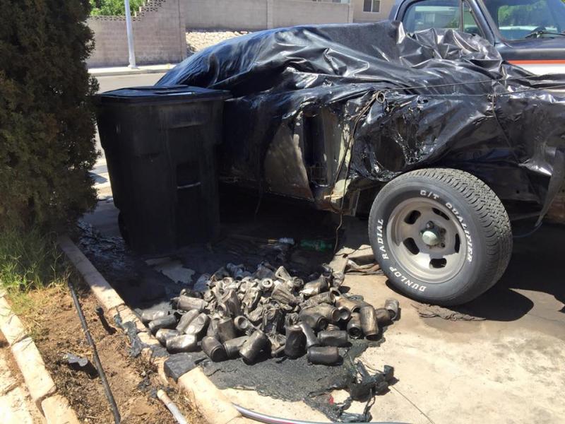

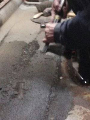

Alright everyone, I've got one hell of a question here. What is the best way to get the rubber coating under the car off? I've tried everything I can think of! I've taken a chisel and didn't get too crazy with it, took some heat to it and it just melted a little, but as soon as I went to scrape it off with something it was already dried (also tried heating and scraping didn't work it was just sticking to the car), Hit it with the sand blaster just got laughed at lol. I'll post some pictures of the undercoating.
I've spent many an hour with a propane torch and putty knife doing that.Get it hot enough to turn brown,the thicker stuff will require a bit more heat.I've also had good results with a needle scaler,noisy though.A friend uses a oscillating multi tool with the flat blade and it works well.Just be patient it will all come off.Crank the tunes and and zone out!

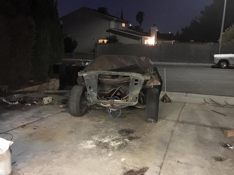

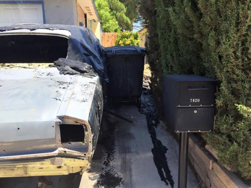

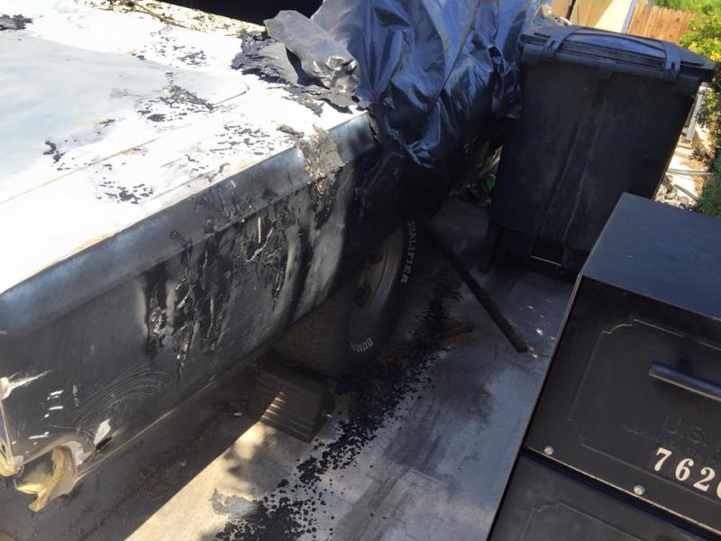

Hey everyone, it's been awhile! I've finally been able to get back to work on the GTX, scraping away at that damn undercoating! Well after tons of hours laying under the car, and getting all that undercoating in my hair and everything, I've decided to start looking into a rotisserie. I think it'll be cheaper and easier to build on by hand. But I'm not really sure how to go about it. I know at onetime my dad had someone send him a way of building one and all the materials we'd need, but I can't seem to find it anywhere. Any help or suggestions greatly appreciated!

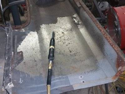

Under coating removal . . . wish I would have listened to what the other told me a lot earlier:
I spent months using a putty knife, and got 3/4 of the car done . . . got the whole back half of the car ( from the axles back ) done in a weekend - and with better results . . .
Needle Scaler - it's the way to go . . .
Here's what it can do . . . and very quickly too . . .
The process . . . in action . . .

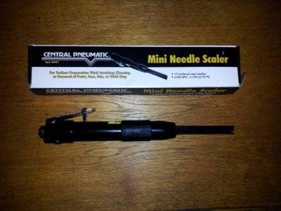

Sweet, just got my rotisserie today, hopefully get it together and mount the car up to it, and I can get started with my needle scaler I went and bought the other day. Thank you for the suggestion!

You're going to love it - it'll make it so much easier ! !
( I'd say "enjoy" . . . but how can you enjoy that job ! ) - so, good luck !
