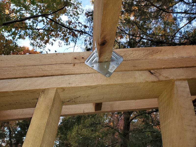

I am not being critical but I saw something that I wanted to mention.
This picture with the metal brackets:
We use them out here in California too but not with screws. Building codes here require nails because the nails will deform before they break. Most screws are brittle and snap long before they bend.
Simpson does make special screws that are softer than regular screws. Our building code accepts them as an alternative to nails but they are about double the cost so nobody I know uses them.
Maybe you already used approved screws and I missed any mention of it. Also, the codes may be different in your area than they are out here. We have to build to a high level of earthquake standards so our practices may seem extreme to people in other regions.
Good luck with the project.

My concern with nails was that they can be pulled out "easily" . . . or at least easier than any screw could be pulled out. Could I use nails - I actually did on my carport - until I saw that Simpson offers a quality screw to anchor these things into the wood.
Note: Nails are providing a "shear" force with the metal . . . so they will be very strong - just that a screw increases that shear force since they are less likely to be pulled out than a nail could be . . . my installation is using the Simpson screws too
Update: forgot I told you this, and not the thread - Don't think that these are even required in NC - we don't usually get Hurricanes, but Hugo did hit here and do a lot of damage - but we do get tornados, and I guess I'm going to play it safe with all my shop equipment and install them even if it's going to cost me a few more dollars in the long run . . . I think it's worth the extra cost.
Could have used nails but my "motto" is BSH . . .
so I went with the screws - might look at the cost difference ( if I have time )

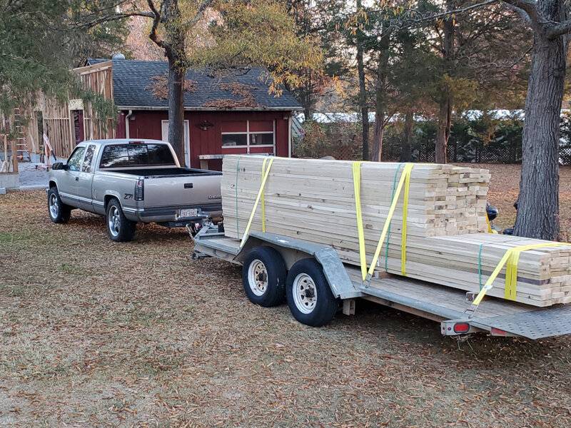

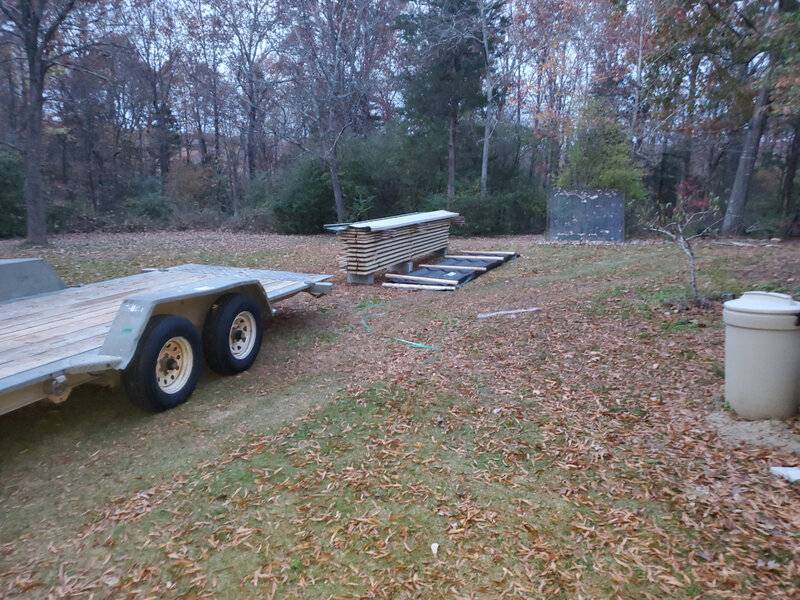

Got my load of lumber hauled in yesterday . . .
Here's the stack of 12' that will be used as the walls for the next part - the center section
( and some miscellaneous stuff as needed - like the garage door header . . . )
Just as I got the stacks of lumber "gone" - a new stack shows up in it's place . . . ready for more work !
Those are the 16' for the bottom/tops of the wall section/diagonals/ and my missing rafters
And the 4/4 that will be used for the purlins to attach the metal roofing . . .
Purlins and roofing stacks . . .

Hurricane clips are a misnomer they actually work against wind uplift that happens when wind speeds exceed a specified miles per hours. The clips are required by codes throughout the country since about 20 years ago.

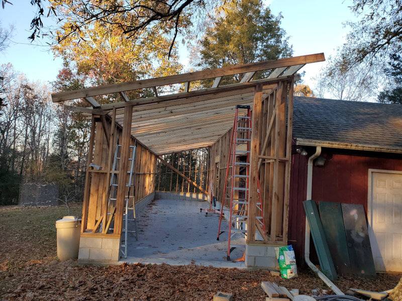

Made some really good progress today on the build . . .
Got ALL of the missing rafters installed, INCLUDING the ones where the shop roof was in the way . . .
( figured out a really easy way to make it happen . . . you'll like this . . . )
First, the middle one of the 3 - fit into place untouched - sometimes is better to be "lucky" than to be "good" . . .
Fit like a glove . . . unbelievable . . .
The next two were simple cut to fit up next to the shop eaves . . .
In the end, they "might" need to be cut again when the center section goes up . . . but they're all installed now.
And I've build the end piece with the 2' overhang - will need to fill in the gaps next . . .
Really happy with my progress and the way its all coming together . . .

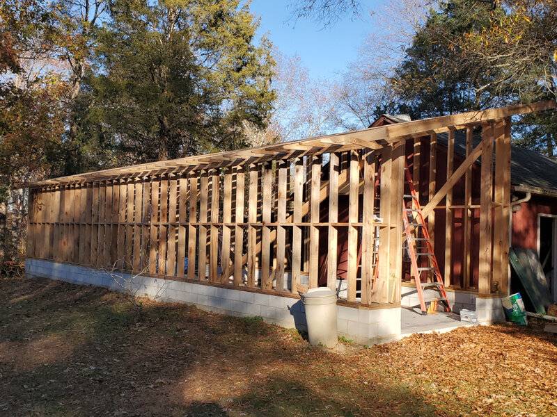

This is how it looked last night . . .
And this is how it looks with the blocking filled in at the top of the wall . . .
Also got all of the blocking added into the "shorter" wall, and a couple done on the tall wall . . .
Tomorrow will be attacking the "tall" wall to get all of the blocking installed there too . . .
She's coming together . . . slowly but surely . . . still need to get my garage door framed in . . .

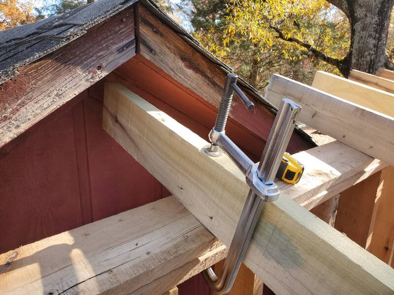

Thinking about the build last night, and I realized that I had installed the "tall" blocking incorrectly . . .
This is what I had done with - thank goodness it was only a few - 6 bays . . .
This is what I needed to do with them . . . the problem . . .
When I get the trusses for the center section - they need to rest on the top of the double plates . . .
Problem fixed . . . only took about an hour . . . then on to the rest . . . finished up all of them on the "tall" wall . . . BUT

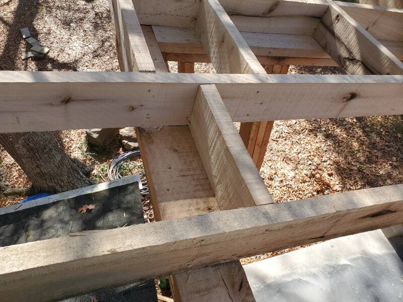

Then, when I got to the end of the "tall" wall . . . I ran into "problem" #2 for the day ( not having a good day ) . . .
Can you see the problem . . .

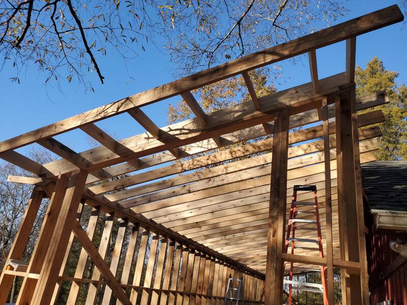

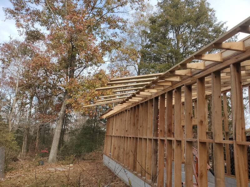

Was bound and determined to get to the purlins today . . . and I made sure that I did . . .
Got the first couple of them up and installed on the rafters . . .
And the view from the top . . . got quite a few more to go . . . but it's moving along . . .
And they're calling for temps in the 60 down here tomorrow . . . I can't wait ! ! !
Did you see the 2nd problem ? ? ?
The hurricane straps . . . by moving the blocking inside the header - I don't have a way to install the straps . . .
SHOULD have got them all installed prior to doing the blocking, and I would have reversed them . . . but it's too late now . . .
Now I'll have to come up with a new plan for getting them installed . . .
Hopefully NOT undoing all the work that I have installing the blocking in the first place (but it might take just that ) . . . UGH !

Try these.
They fit either side of the rafter.
The Simpson H 2.5 actually is rated higher to resist uplift but is not rated as high for lateral resistance. The uplift is of higher importance where high winds events are more common. Lateral resistance is more important out west because of the earthquakes.
We use the H 1 clips everywhere except where clearance is too tight to fill all the nail holes. Sometimes you can't even get a palm nailer in to drive the nails.
The H 2.5s fit left and right sides. Just be sure to install them so they don't hang too low and interfere with the drywall.
Bought some of them with the "hope" that they would work . . . Thanks for that insight.

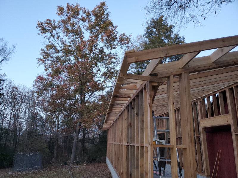

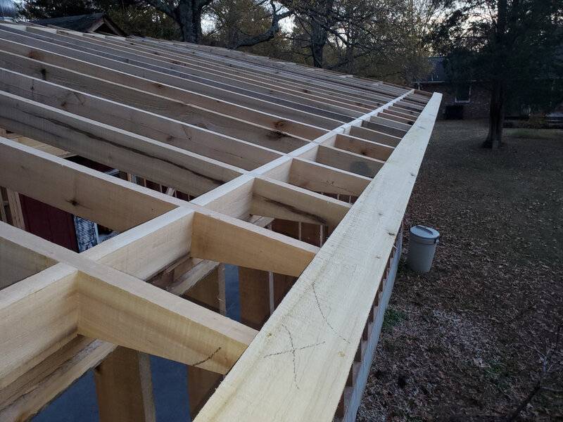

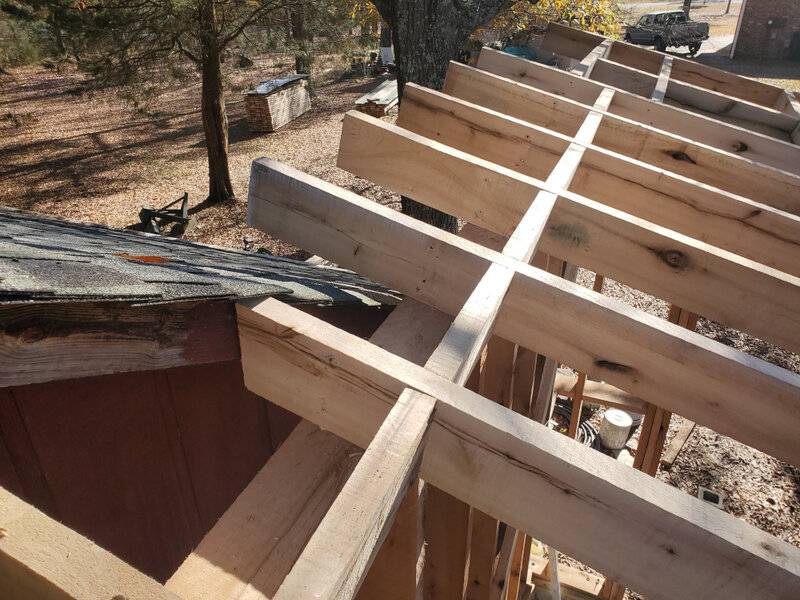

Very Interesting Day . . . spent most of it on top of the shop for a change of pace . . .
Still making progress, and the warmer temp today helped a bit . . . but I thought I was going to get more done than I did . . .
First, got started and installed all of the hurricane straps on the "short" wall and front wall ( not the "tall" wall - yet)
Truth be told, should have used the limited daylight to work on the purlins . . . too late now . . .
Figured it would be easier to work on top the shop, then to keep climbing up and down, so I tossed a bunch
of the boards up on to so that they'd be available when I needed them - seemed like a plan . . .

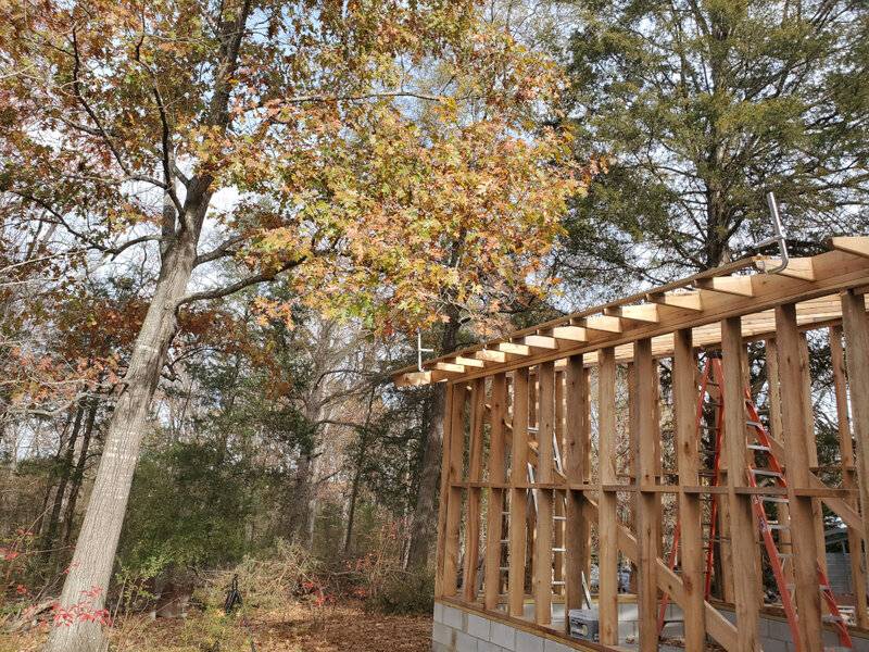

Then when I got to the back corner, I realized the tree branch was in the way . . .
So it had to be taken down to get it out of my way . . . add it to the firewood stack . . .
Then I spent most of the day on top of the shop, working on the purlins . . . and the daylight disappeared
fairly quickly . . . so I apologize for the "bad" pictures, but my guess is that I'm about 1/2 way with them . . .
Hard to tell with the lack of daylight . . . but I'm liking the progress . . .
Sure was an odd day, working in the air like that, and I've not done that for a long time. Took quite a while to
get even close to being "comfortable" up there walking around . . . good part was crawling around . . .
And I realized . . . I'm not 20 anymore . . . and I'm feeling it after these 4 days of construction . . .
