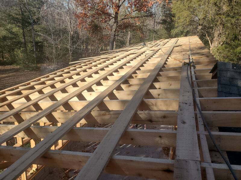

Thank goodness, I took half a day off and got some shop building time in with this great weather.

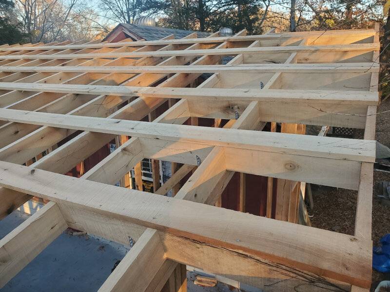

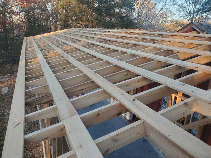

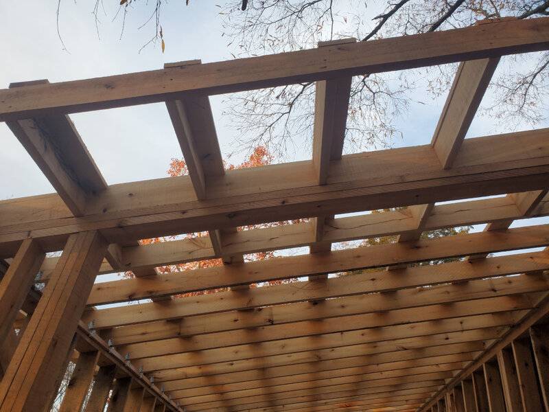

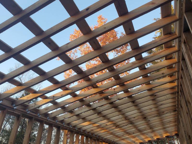

And . . . as you might suspect, I'm back up on the top of the shop again - working on purlins . . .
And, as usual . . . my little buddy ( he really does look little from up here ) is outside with me enjoying the weather.

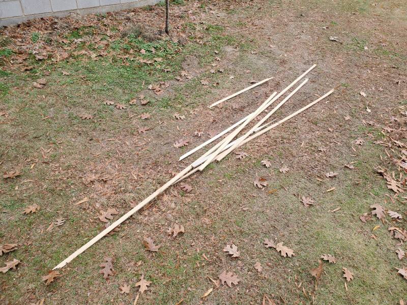

I've got all of the strips cut, and set in place with only a few screws to keep everything aligned . . .
( well . . . I might have to be adding in one more row of purlins - due to the spacing )

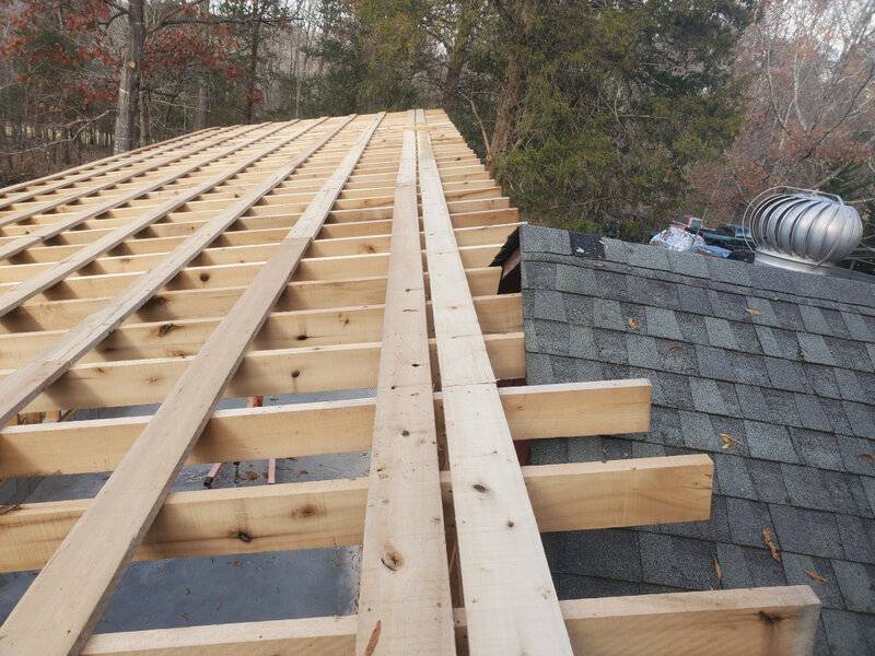

Another view . . . and how it's looking . . . but I've got a lot of screws that need to be installed now . . .
Really a pretty cool looking view from the shop - as all I'd been seeing was a view from up top . . .
Tomorrow's weather forecast is in the 70's again - so I'll be taking advantage of that and working on the shop again.

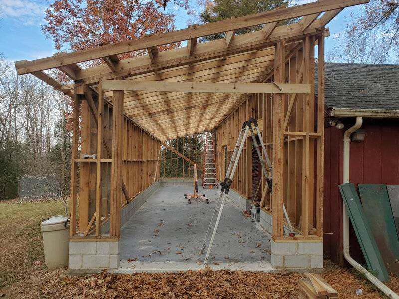

This is the opening with the 8' door . . .
This is the opening with the 9' door . . .

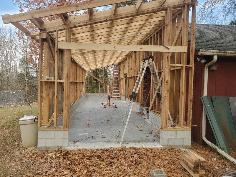

Got all the rest of the planks screwed down . . . and had to add another one at the top . . . as seen below . . .

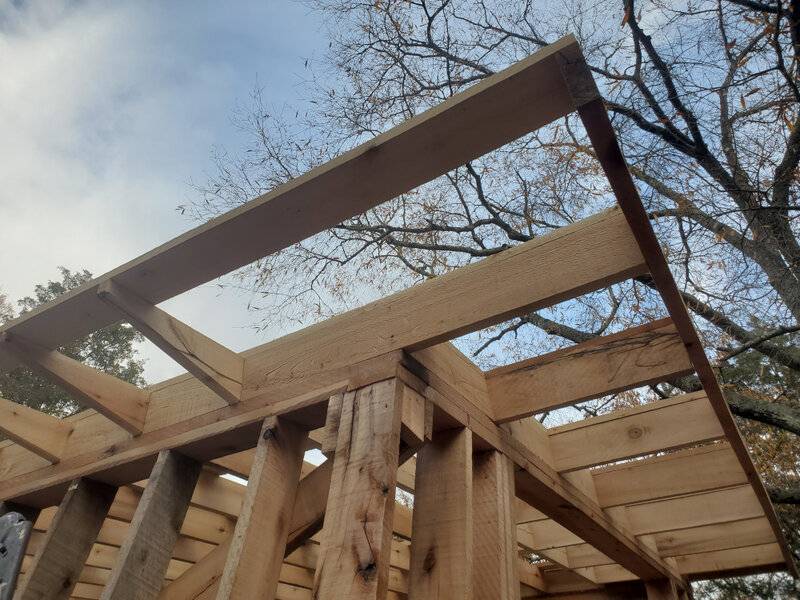

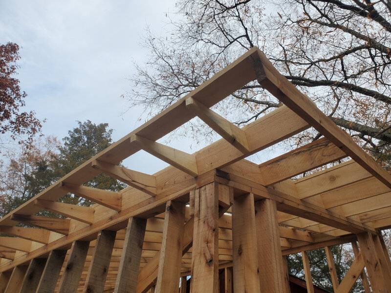

The 2' extension on the front, had this "ugly" opening . . . that needed to be addressed . . .
Handled . . . added a couple more rafter ends in and it makes it look much better . . .
Did the same thing to the back opening . . .

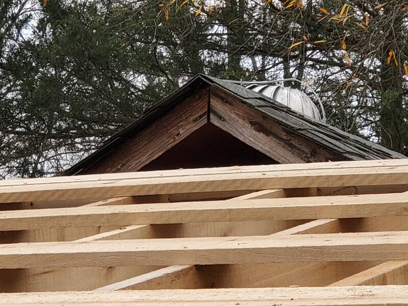

Filled in the openings at the top of the walls, to prevent critters from getting in and under the roofing . . .
This picture better illustrates what was done . . . but it will stop the critters . . . that's the plan . . .

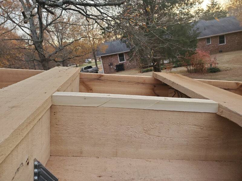

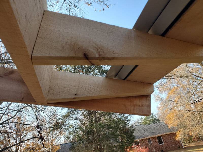

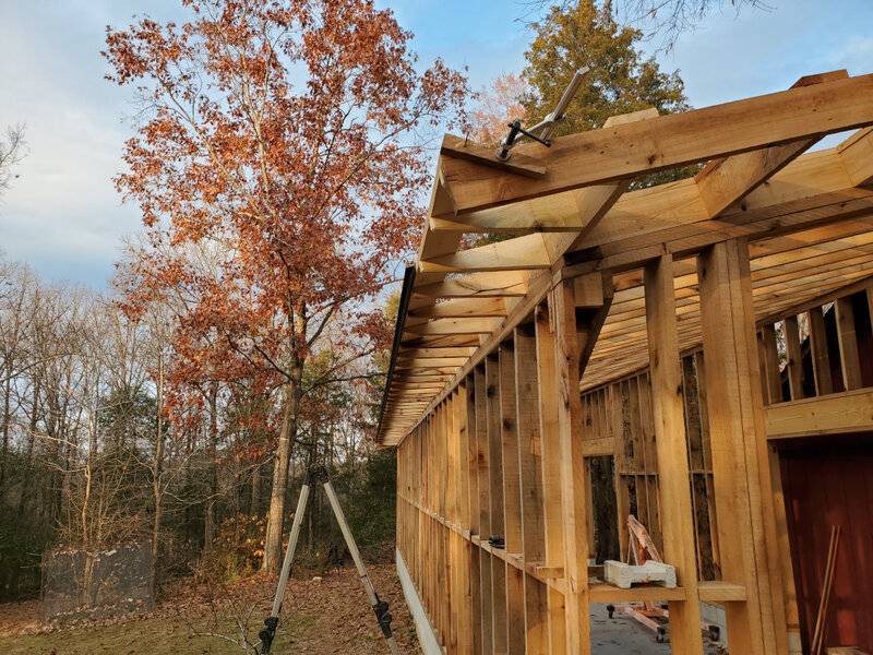

Getting ready to start on the metal roofing, and the drip rails need to be installed. Simple enough . . .

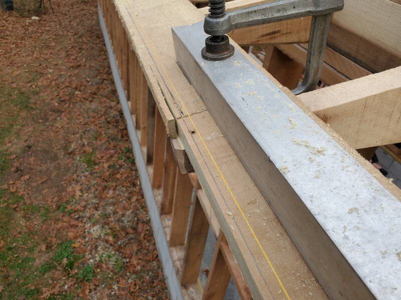

But - set up a string line and had 1" spacing on both ends . . . and only 1/4" in the middle -
Things moved - or I messed up while building while using my lines . . . JUST . . . need to fix it . . .
3/4" is too much to work on cleaning up and not be easily noticed . . . so I'll split it in half - 3/8" . . . will cut 3/8 off where needed.
Here's my process . . . clamp a straight edge, and run the circular saw down the edge . . .
This is how much needed to be trimmed to get it "looking" better . . .
The end result . . . will be greatly improved and probably not noticeable (to most people)

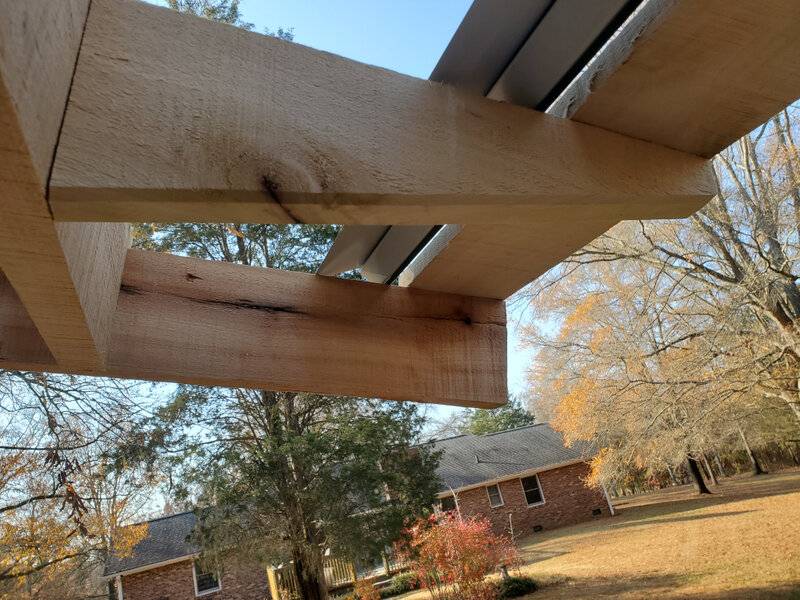

While working on the drip rails, this image just caught my eye . . . thought I'd share it with everyone . . .
The old . . . And the new . . .

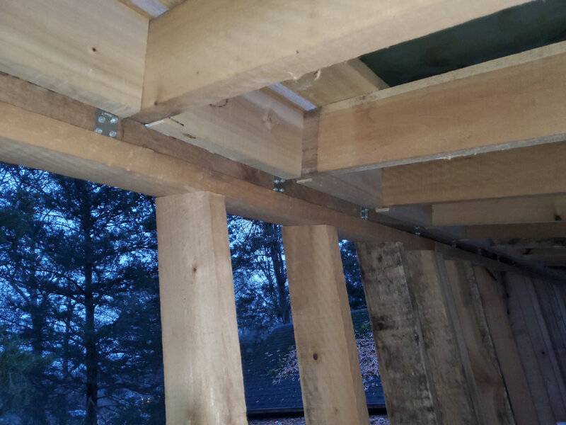

Got out of work at lunchtime today, and jumped on the Simpson H2.5 straps on the high wall . . .
And got them knocked out today . . . one step closer . . .

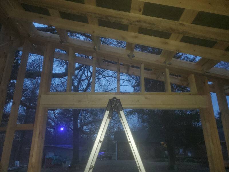

Got the header installed for the garage door . . . and was working on the studs above it . . .
Got them mostly cut to size . . .
And while I was working on it, start to hear the pitter-patter of drops . . . rush to get things stored away . . .
And 5 minutes ago I was outside working on the shop . . . and now this . . .
( doesn't show how hard it's coming down as I'd hoped it would show . . . )
Still got to get the studs screwed in and secured on both ends, they're just wedged in place right now . . .

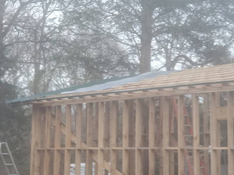

Was able to get the first (2) panels up on the roof - getting the first one straight and square took a bit . . .
Hoping that the "initial" How do I do this is now behind me, and the progress will be a bit quicker today . . .

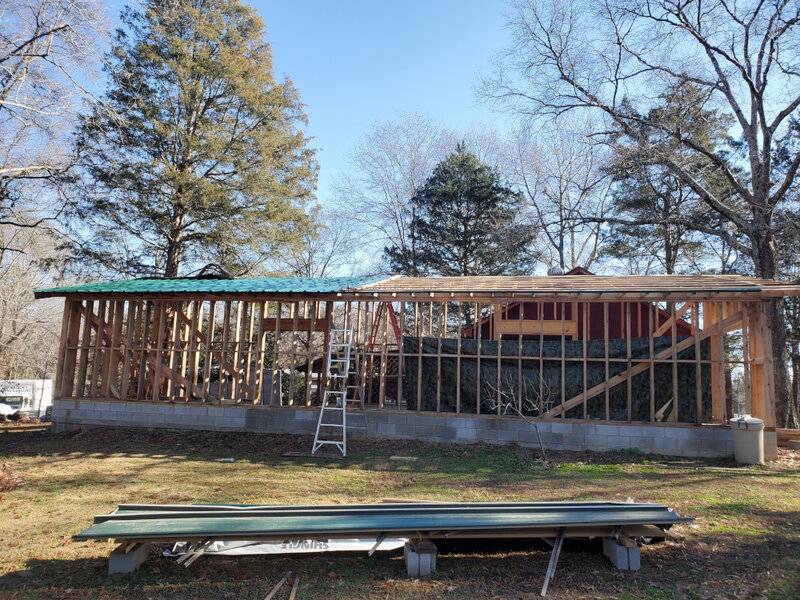

Was able to squeeze in a little roofing time on Saturday and got 3 more panels installed . . .
Frustrating . . Only 2 days that progress can be made and it rains - almost all week it was calling for clear and 70's . . .
5 panels of 18 installed . . .27.77%

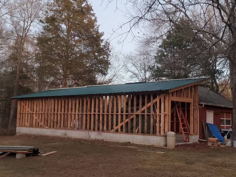

Are you planning any plywood sheathing or are you just going to add metal panels to the sidewalls? The end walls of such a long narrow structure will tend to rack especially the wall with the garage door in it. Putting plywood on the exterior side and interior side will create a box that will stabilize the wall with the garage door from racking. I know your were able to install diagonal braces on the other corners.

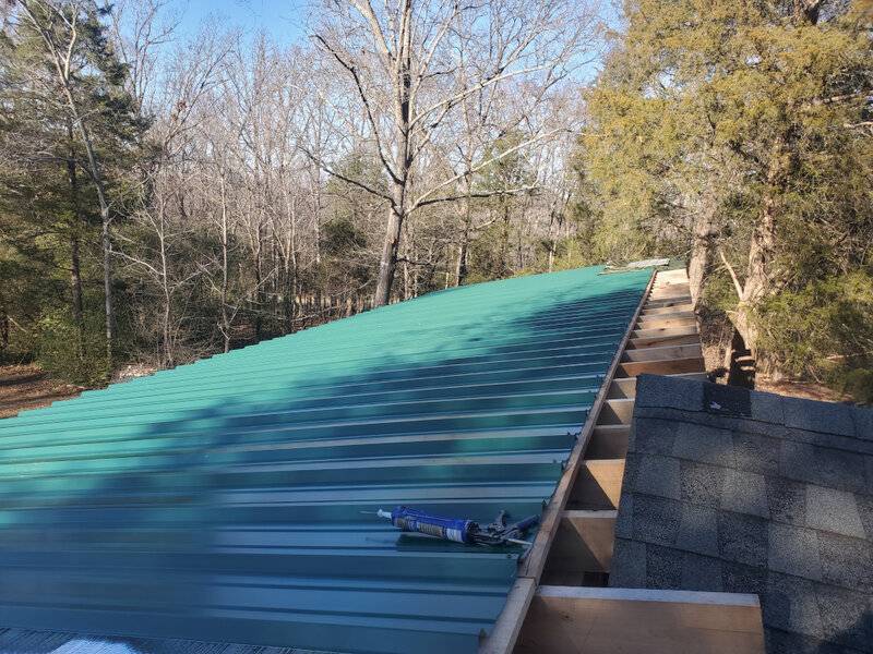

Great day of progress . . . Love it ! ! !

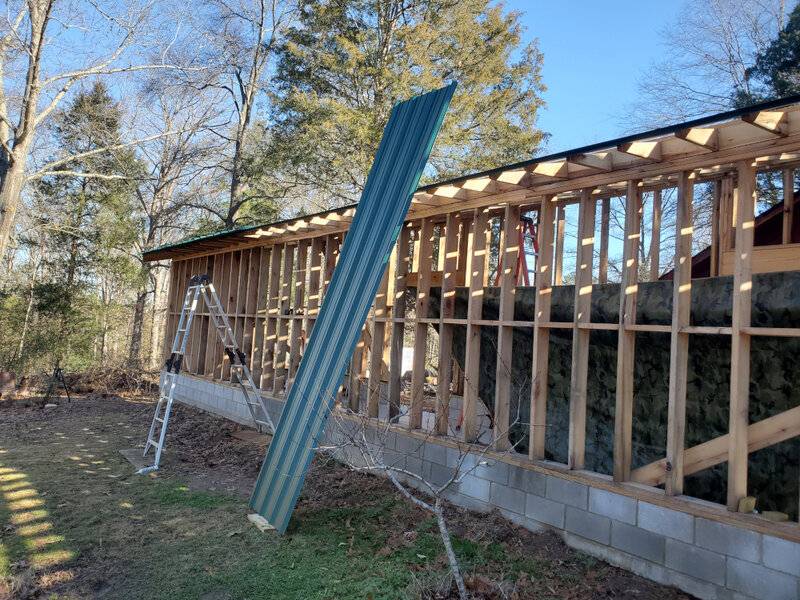

Not sure I was going to be able to pull this off, but I surprised myself . . . Boy did I . . .
Had a friend ask me "how" are you getting the panels up on the roof . . .
Here's the plan of attack - lean it up against the building . . . climb up top and pull it up . . .
18 panels . . . this is when I had 8-9 of them up . . . was wondering if I was going to finish it today . . .
The view form up to . . . Really like the way it's moving along . . .
Surprise . . . all of the panel are in place - can't say "installed" as the whole field needs to be put in place . . .
There are currently only 2 screws on the bottom, and 2 screws on the top holding the panels in place . . .
The good news . . . NOW I can go get some siding and start building the walls on this thing.
Now that they will be under cover and protected now . . . What a great day ! ! !
