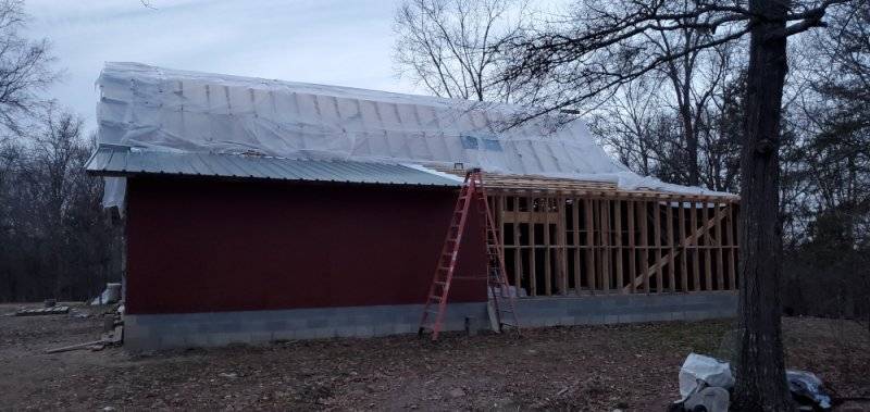

Finally time to pull the trigger . . . starting on the New (much anticipated) SHOP - Build

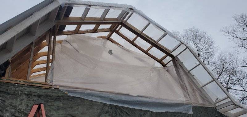

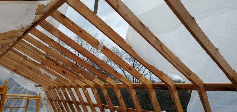

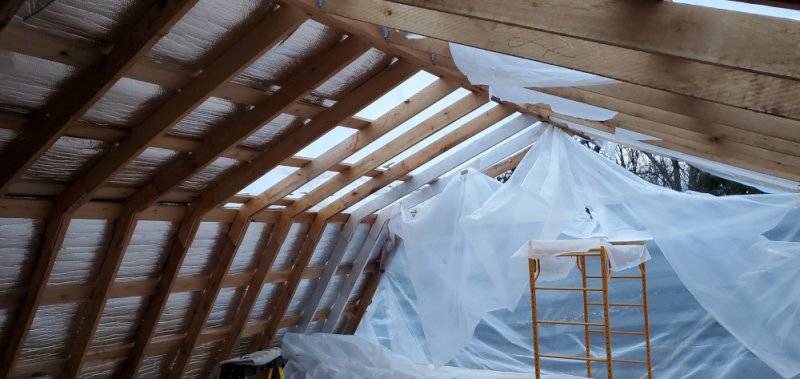

One Solid week of rain here - slowing down my progress . . . but still trying to move forward . . .
Had an entire week of rain, and the plastic on the shop held up very well and did good keeping it dry.

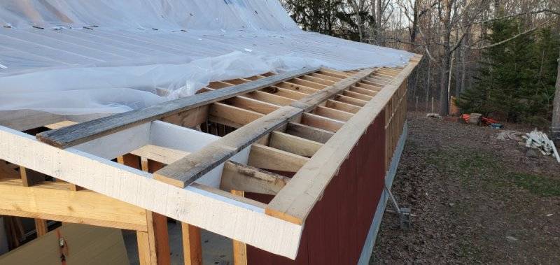

Had to fight with a couple areas leaking, but they were on the other lean-to and not a big deal
( not a big deal because it had concrete under it and not much that it could damage . . . )
This was actually done during a light rain, as I was under cover and could get the work done . . .

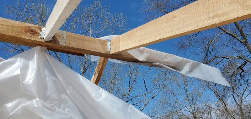

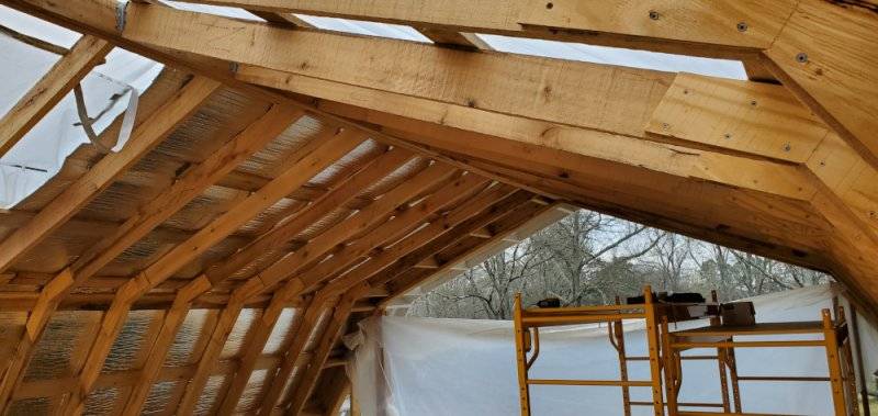

Added the needed blocking above the walls for the upstairs . . . ( ooops, missed one . . . duh ! )

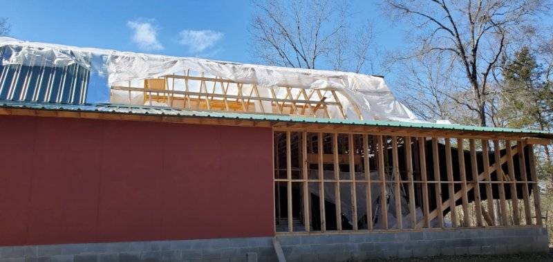

This was quite disconcerting . . . after weeks of trying to keep plastic covering the building, started to remove it . . .

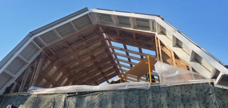

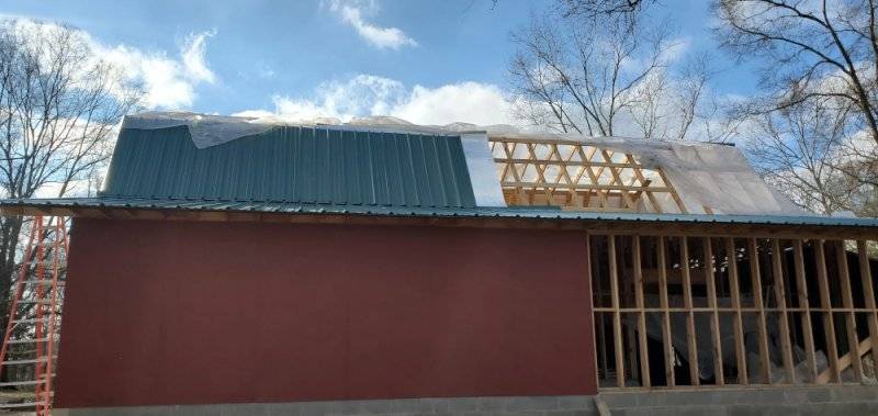

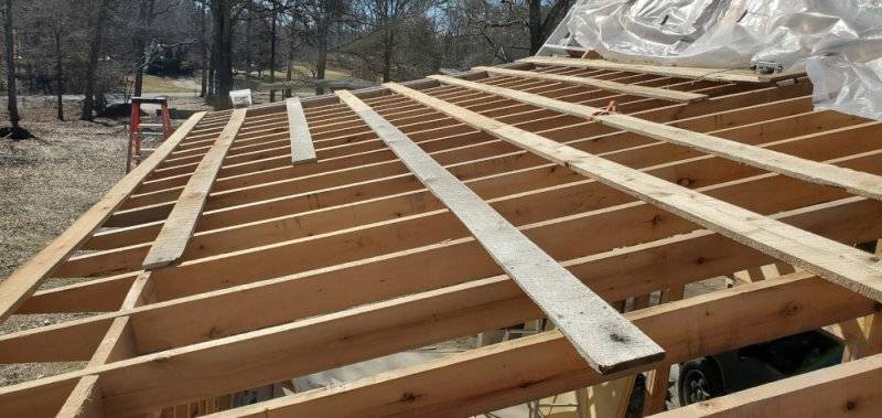

Time to start adding purlins and "hopefully" get some metal roofing installed this weekend . . .

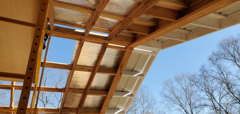

Had this section for the overhang that was missing the rafter extensions . . . and needed to get it corrected . . .
There . . . much better . . . time to continue with the addition of the purlins . . .

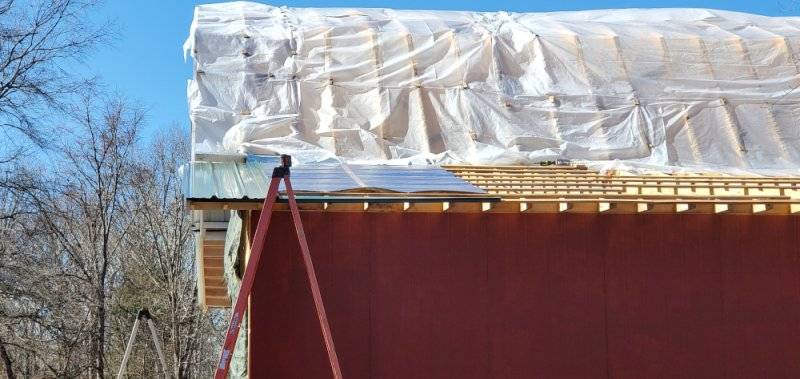

Still feels "odd" removing this plastic . . . but that's the only way to make this work . . .

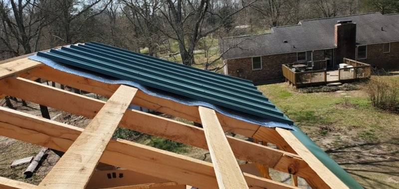

Got a couple days in a row with no rain in the forecast and temps no too bad . . . so the plan is to try and get
some of the metal roofing in place this weekend . . .
Hopefully . . . things go well this weekend . . .
More Later . . .

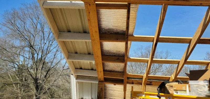

It's amazing amount of pre-work required to get the work done . . .sheeesh ! ! !
Wow . . . thought that most of this roof could get done this weekend . . . but . . .

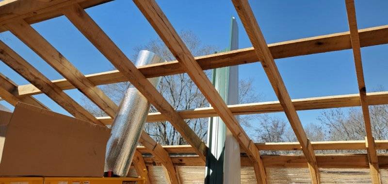

All of the stuff that needs to get done before the metal can go up is staggering . . .
- all of the plastic need to be removed ( did it a section at a time . . . ugh ! )
- all of the purlins need to get installed - assure 16" on center for the rafters . . .
- blocking needs to be filled in between the purlins on the front ( and back ) walls . . .
- get the radiant barrier set in place . . .
- then . . . the metal can go up ! ! !
And all this while climbing up and down ladders and balancing on purlins and joists . . .
( doesn't get much "funner" that that . . . )

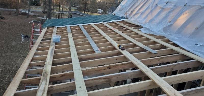

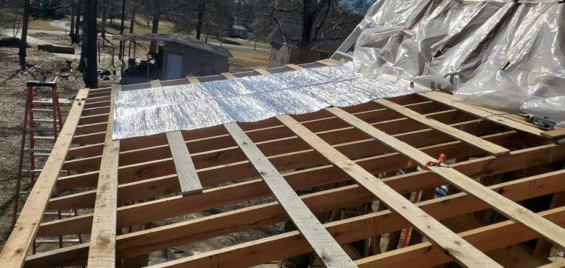

Getting a section of the purlins in place . . .

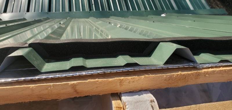

Getting the radiant barrier set in place and secured . . .

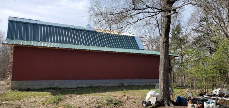

The first piece of metal is the hardest part . . . getting it right is so important to having it all line up straight . . .
Then they go up a bit faster . . . until you run out of installed purlins to attach them to . . . and have to add more . . .
The end of the weekend . . . got 8 of 18 panels installed ( the last 2 will not be able to be done yet )
so . . . we're just about the half way point now . . .

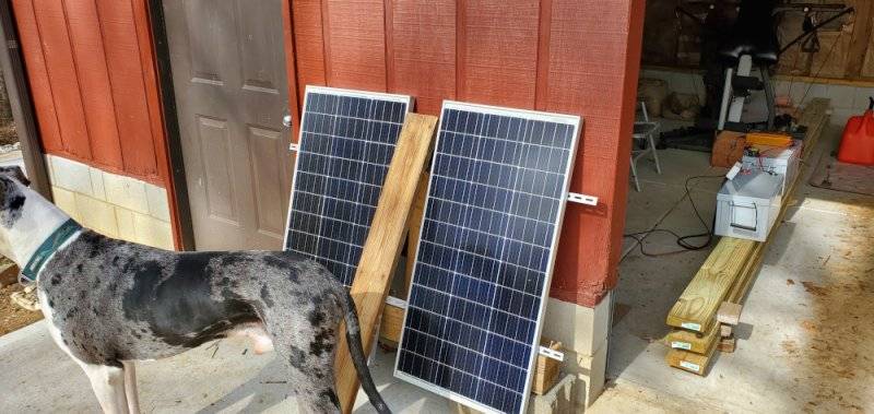

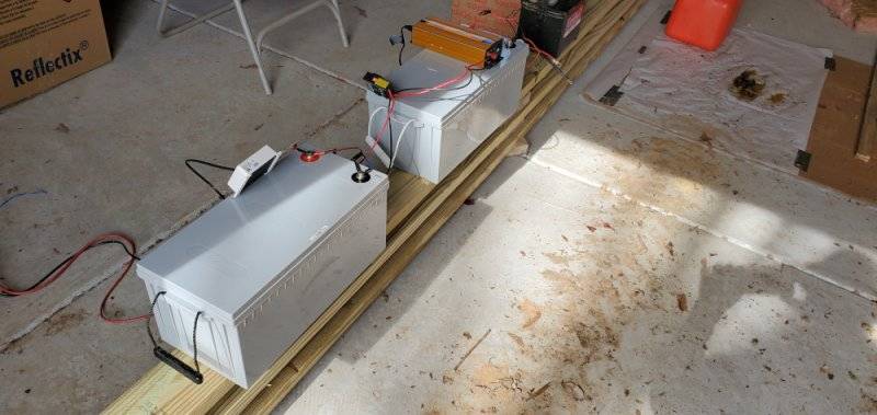

Been wanting to check out solar for quite a while . . . Finally pulled the trigger . . .
Found a solar setup for sale on CL and finally got this to allow me to tinker and figure this thing out . . .
- was told both batteries were fully charged ( wrong )
- one battery would not give a reading
- one battery would only show 11.6 volts ( this is NOT good )
- was told it's fully functional ( wrong )

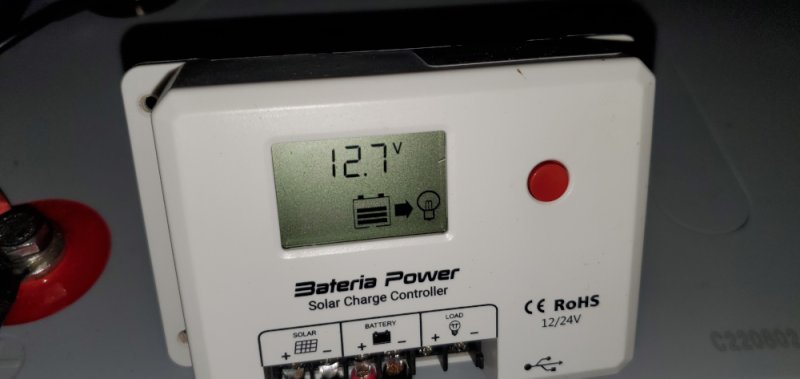

Got it all set up and starting diving into it . . .

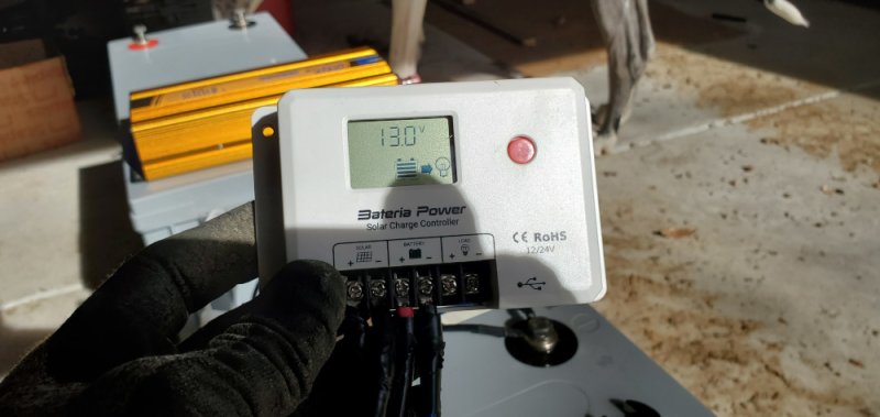

The battery that would not show any charge . . . hooked it up to a smart trickle charger for 3 days . . .
and . . . the battery came back and registered 13 volts . . . ( call that a "win" . . . )
So then what I did next was pretty interesting . . .
Hooked the "good" 13 volt battery up to the panels and it was holding at 13 volts . . .
- then plugged the smart trickle charger into the inverter that was tied to the good battery . . .
- charging the "questionable" battery with the smart charger using the solar collected energy ! ! !
While this was going on the good battery was holding a 12.5 volt charge while charging the other battery
Later in the day I shut down the trickle charger, and the battery charged back to 12.7 volts . . .
- guess I needed to shut it off a little bit sooner - but the sun tomorrow should get it back to 13 volts ( I hope )

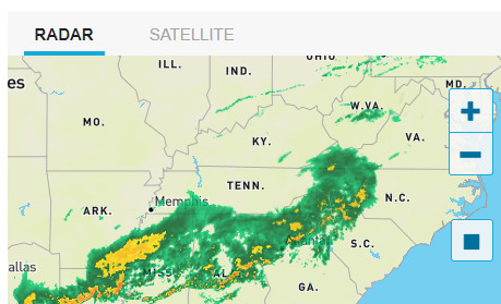

Another forecast with rain Friday, Saturday, Sunday, and Monday . . . UGH ! ! !

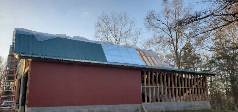

2 weeks ago I got to this point . . . and have been unable to post . . . so time to get caught up . . .

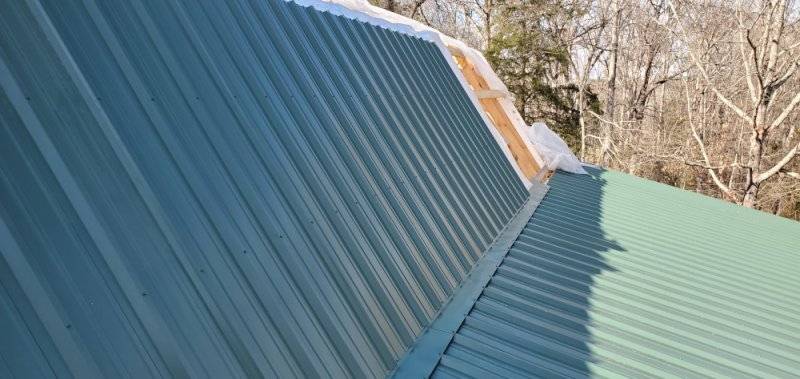

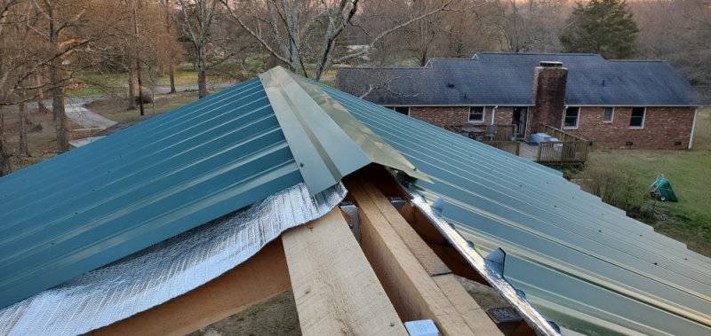

Got started working on the other side metal roofing . . . peeling off the plastic I work so hard to keep ON !
That night, was able to get 12' of radiant barrier and 12' of metal roofing panels installed . . . yup, it's dark !
OSHA approved . . . had to fix up some plastic that did not want to stay put . . . but the 12' ladder didn't reach
So . . . bring in the big guns . . . ( ok a little lift ) . . . and I was able to get the job done . . .

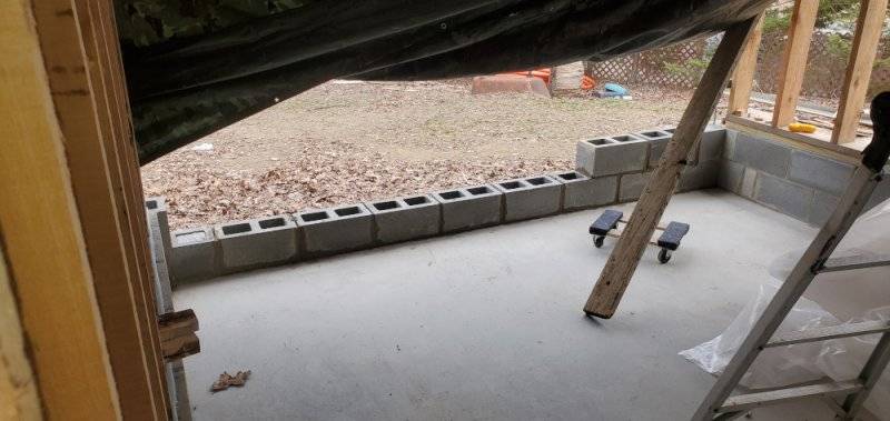

Last weekend, while still getting "better" and not being able to work on the shop for 2 weeks, was going CRAZY !

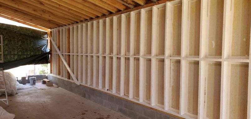

So, busted out the mixer, mixed up some masonry cement an got started on this rear wall . . . it needs to get done.

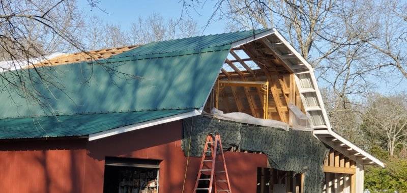

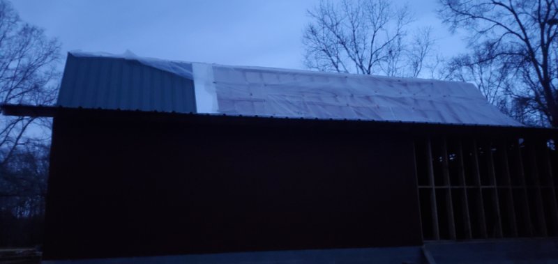

Then, this past Monday, come home to work to find this . . . 1/4 of the building plastic was blown off . . . ARGH !
Then this morning, after the rain finally cleared out . . . guess what . . . was taking all the stuff that was blown off
and reinstalled - back off the roof to get started on it . . . ( GO FIGURE )

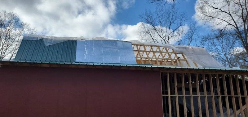

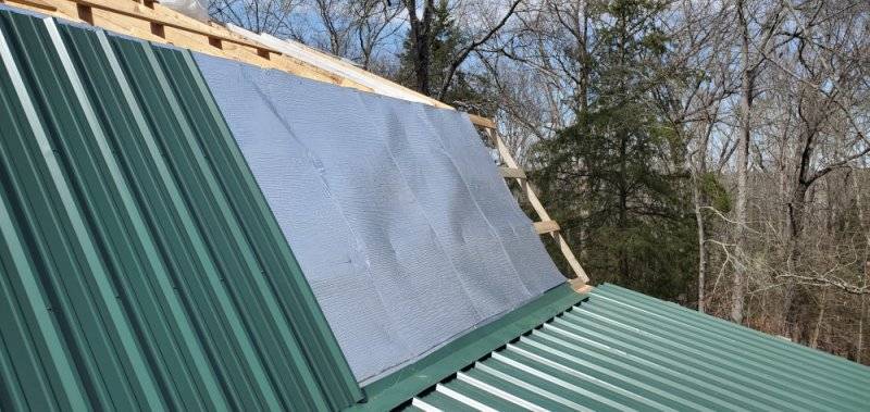

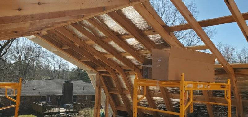

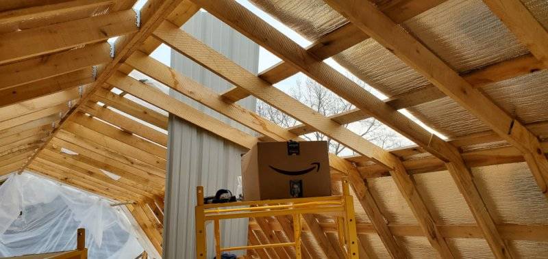

Getting the first 12' section of radiant barrier up and in place . . . after removing the plastic . . .

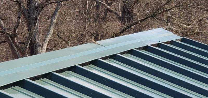

Oh . . . and getting the transitions in place too . . . ( can't forget that step )
Fill in that 12' of radiant barrier with 12' of metal roofing . . . rinse and repeat . . . .
The next 12' section of radiant barrier is now in place . . . for tomorrow . . . That'll be another day . . .

Finally got around to making the LAST truss that is needed for the upstairs - because I messed up and was short.
Getting the truss upstairs . . . not that difficult . . . just climb it up the ladder . . .

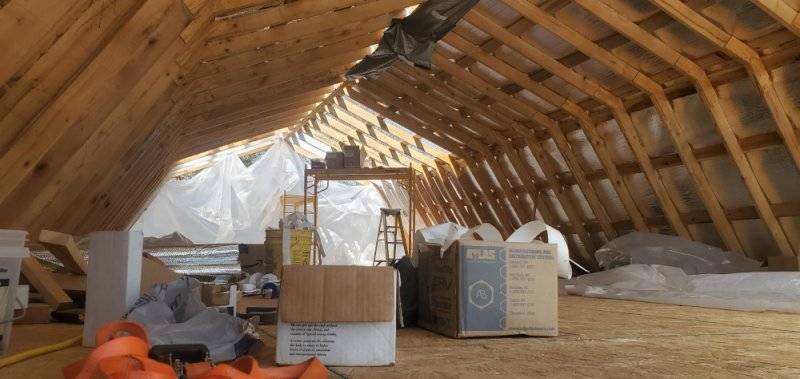

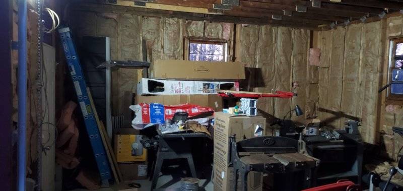

Got a bit of a mess upstairs, and it really needed a bit of cleanup . . . so that got taken care of.

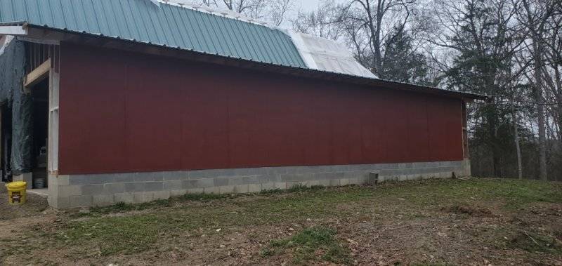

Trying to build up my stamina and get back into the swing of things . . . and with rain the next day, did NOT want

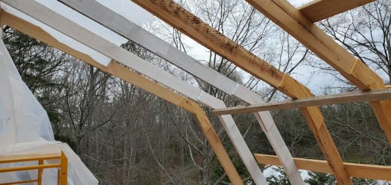

to pull plastic off and have to put it back on . . . so I decided to tackle the end wall . . . all but the last 1/2 sheet
is now done . . . but the yellow is so ugly . . .
There you go . . . so much better . . .

First of all - the priming of the wall . . . got most of it done, the not done ones need some work on the walls.
The edges of the concrete board is right at the edge of the studs ( bad layout on guess who's part ) . . .
Everything can be fixed . . . just takes a little longer this way . . . ( sigh )
The end block wall needs some block added to it . . . yet . . .
Perfect day to work on that and get it completed . . . and filled with concrete - of course I was short ! ! !
Had to get 2 more 80# bags to get it completed . . . on Monday . . .
Here I thought he was hunting lizards . . . he caught this big ole mouse and was "playing" with it . . .
Installation of the hurricane brackets on the top side of this lean-to is getting done . . .
Got the rest of the wall completed and the missing holes filled with concrete ( and anchor bolts if needed )

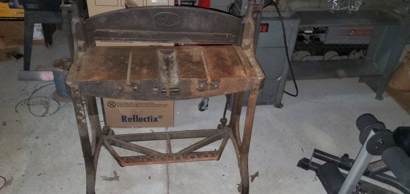

New recent purchase of the shop . . . a stomp shear - been looking for one of these and stumbled on this one
Believe it or not - it was only 10 minutes from my house right here in Concord ! ! ! Can't beat that ! ! !

Added a 12V LED light into the "moved" shop . . . and was amazed at how well just 1 light worked in the shop
Got 8 of these to put in here . . . might not need them all . . . but I've got them just in case . . . work great ! !

Man that bender is robust ! Is that a DiAcro brand ? Any tags on it ? I remember something like that made right here in Cleveland Oh. back in the day ! Nice score and great looking shop !
Yes it is a DiAcro bender . . . problem is that it'll only bend ( so they say ) up to 1 1/4 tube . . .
Anything for a car - Jeep would probably be 1 1/2 - 2 1/2 . . . but it should help in other areas too.

Yes, the DiAcro bender is not really for tubing like for roll cage but for everything else ! That is a great piece of tooling, where did you get it ? They also made a punch & die that looks similar that we had at work.

Big push before the rain - as always, a load of prep work needs to get done first . . .
As always, the amount of prep-work that needs to get done first is always amazing . . . here we go . . .
Really odd . . . to be removing the plastic cover from the shop that I fought so hard to keep it on and dry !
But . . . it's a necessary evil to get to the next part . . .

BUT . . . this is the first time working on the upstairs . . . so this had to be remedied . . .
The 1x6 poplar boards were not too big of a deal . . . got them up to the upstairs pretty quickly . . .
The metal panels were a complete other story . . . but they were gotten upstairs - FINALLY !
This will make the job go a whole lot faster and hopefully save my knees a bit more too !
Next on the agenda, was getting all of the purlins in place . . . well . . . not all of them . . . had to do guesswork
Remove "enough" plastic to get the purlins down, but not too much that would be out of reach . . .
But with 16' boards - it meant having to remove a whole bunch of the plastic anyways . . . but not ALL of it.
As the purlins are installed, it was a pretty cool picture to see it finally moving toward getting a roof ! ! !

This is the radar for Friday . . . Concord is right in the middle of the big yellow dot to the left of the N.C. on the map
( sucks having to cover it all back up - but 3 days of rain . . . didn't want the flooring getting all that water )
Passing the radiant barrier and the metal panel up to the top side were dine similar to the walls - but through the roof
So now is the BIG question . . . How far did I get in this project . . . Guesses ! ! !
seems like every time I thought I was making good time, I hit a little snag . . .
- needed another 10' section of transition installed
- the next panel could not go in because more purlins were needed to be installed ( they were staggered for strength )
- plastic was in the way for the next 16' purlin . . . it needed to be moved . . .

So Thursdays efforts were not pre-work, but actually getting some roof panels up on the building . . .
( and some more pre-work to boot ) . . . This is the first panel going up on one side of the building . . .
Whoooohooo ! ! ! !
A view from the top with the first (2) panels in place . . .
Note the green metal in the lower right, to the right of the wood purlin . . . that is a transition . . .
This appears to be the bottom side view of the shop with probably 3-4 panels in place . . .
Time to move the focus to the other side of the building and attempt to get some of them installed too . . .
Near the end of the day . . . had 6 panels on the first side that was started . . . With 18 total, that's 1/3 of the way . . .
Got as far as possible with the purlins that were in place, and the transitions that were installed . . .
Pretty happy with the 1/3 progress - although I was actually hoping for 1/2 way . . .
The second side was falling a bit behind in the panel installation . . . at the end of the day it only had 3 panels . . .
With the 3 panels in place, it was "close" enough to add the ridge-cap - and it was needed to keep rain out ! ! !
It currently has only 4 screws in it because all of the closures still need to be installed for the ridge cap . . .

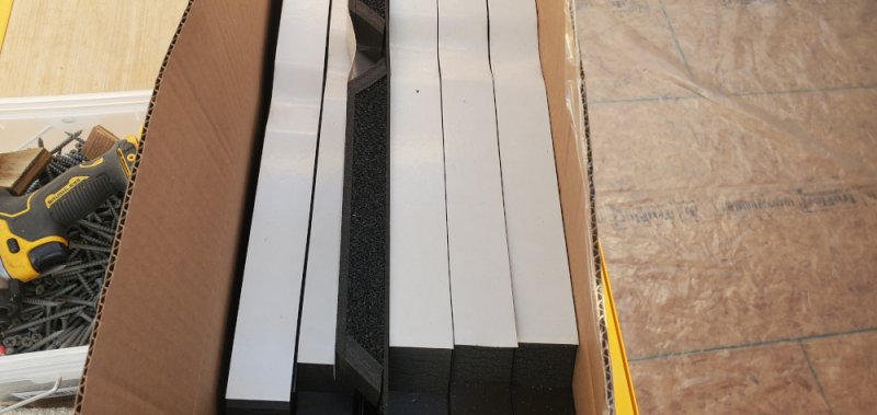

Then a BIG problem was discovered . . . Did not have enough closures to get this project done ! ! Had I not seen
this, would not have been able to get any more roofing done - so a trip to the metal roofing place to get MORE ! ! !

Got the last of the panels up, got the remainder of the top all sealed - and shortly after the rain started . . .
It came down pretty good and steady for most of the day - that's when I went to the metal roof place . . .
( and after the re-cover had a little bit of tweaking for several tiny leaks . . . but it was really very sound )
Both sides - upstairs are now 1/3 completed . . . and the top is covered for the rain . . . Bring it on ! ! !

Needed to add another section of board to the double top beam - so that I could get the "last" truss installed
- got this picture after adding the double 2x6 and getting the last truss installed . . .
Side note - as I got started on this . . . is started to rain, and I had to race to get things covered up. It rained for
about 2-3 hours and then cleared up . . . no rain for Saturday and Sunday . . . ARGH ! ! !
Messed up my WHOLE Sunday morning progress on this roofing . . . back to your original story now . . .
So after that got done - the last truss got installed . . . why was this needed . . .
Because it had to have purlins added to it to add the bottom transition . . . so the side panels could be installed . . .
Keep following along . . . this has not gotten sidetracked yet . . .
Now that the truss is in place, the remainder of the purlins can now be added to the side of the building . . .

So how did the progress fair for this whole weekend . . .
- one side has almost 40' done
- the other side has about 30' done
- the last roof truss is now in place
- the side of the building got more completed - too
All in all - even fighting with the rain - it was a pretty successful weekend . . . I'm wore slam out . . .

Yer gittin it done Larry! What are you using to seal between the transitions and your roof panels?

This was a pretty good week as far as progress goes . . . sure can't complain . . .
Once again . . . removing the plastic was not easy as there was always a possibility of more rain in the next day or two
But, it's the only way to get to the end goal . . . here the end of the shop is mostly stripped . . .
- 4 bays on the left - 8 bays on the right - remaining . . .
At the end of my effort . . . there is only 1 bay left on the left - plus it's overhang . . .
And only 2 bays left on the right - plus it's overhang - finished up 2 sheets Friday morning before the rain hit.
And the top ridge cap was not put in place - but covered with strips of tarps to keep the rain out ( kinda )
During the rain, the primer was pulled out and the process of priming the trusses has begun - to protect the wood.
Today was the first day ( in a very long time ) where I did not climb up in the loft and work on roofing
Every panel that can be put in place is now in place - got to get the back wall done now to get it all completed.
So - time to start on the back wall . . . ( feel s so odd not working on roofing ) . . .
By the end of the day . . . look at the sky outside . . . got the wall lifted into place and bolted down . . .
Got the tarp on the outside put back in place to help with the winds . . . wasn't sure I could get this far
But . . . it's now in place and I've got some work to get this and the overhang above it finished up . . .
Then . . . back on the roof - pull the last 2 metal panels - finish up the trim stuff - and put the panels back in place.
@PRND21 - you asked about what was being used to seal between the transitions and roof panels . . .
The roofing company sells these "closures" to put in the gaps and keep the critters out . . .
These are the "vented" form . . . but they also sell non-vented and they are cheaper . . .
They are stuck in place on the roof panels before you put the transitions in place - about 1" back from the edge
- Hope that answers your question ( they also have them for the small holes too )
Got the roofing all done Friday morning - and the remainder of the roof sealed with plastic . . . again . . .
The ridge vent is covered with strips of tarp to try and keep the water out . . .
The way it was placed up there, it allowed for the tarps to allow the water to pool in the tarp - and leak
( depending on how bad the tarp was in that location ) Had the floor covered with plastic and it helped hold the water.
Had (3) spots where it happened . . . from the bottom pushed up on the pool area and drained the water.
Then stuck a piece of wood on the ridge beam pushing up on the tarp to make it higher in the center - no more pools.
Next step - finish the end wall, the overhang above it, and get this part of the roof DONE.
