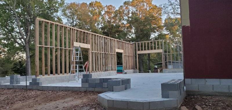

Finally time to pull the trigger . . . starting on the New (much anticipated) SHOP - Build
Busy week and things are getting done . . . and rain in the forecast for tomorrow . . . ARGH ! ! !
Trying to keep on this every day and make progress, but the daylight is getting shorter and shorter . . .
But got a bunch of stuff done this week . . . and today ( tonight . . . )

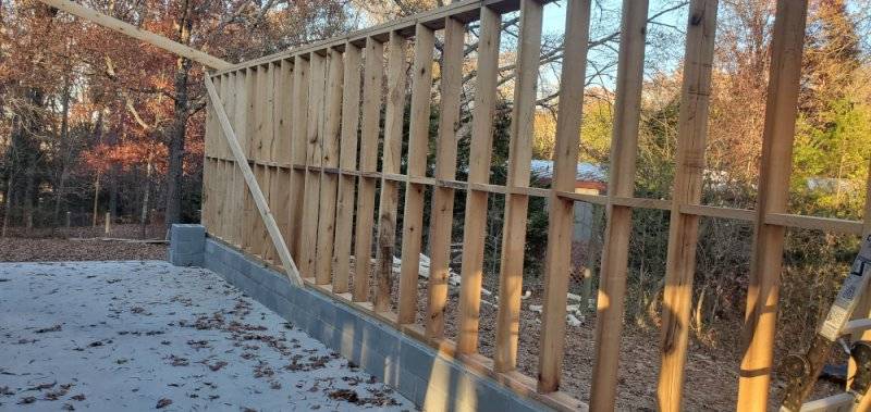

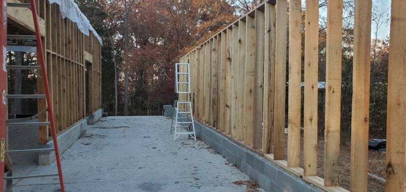

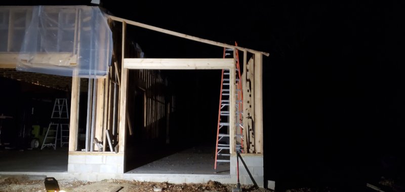

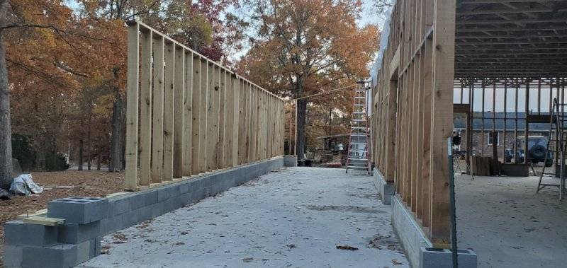

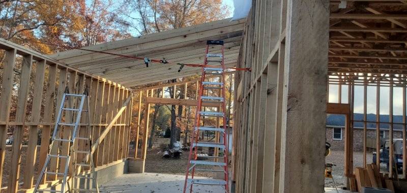

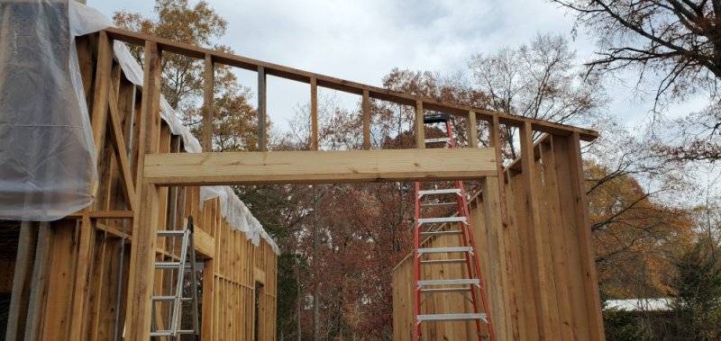

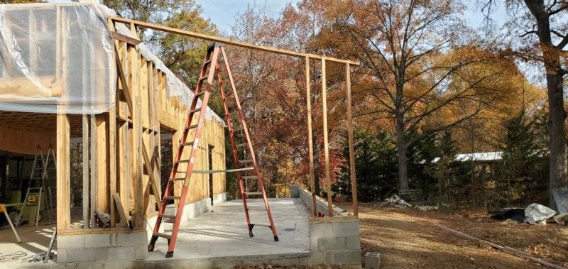

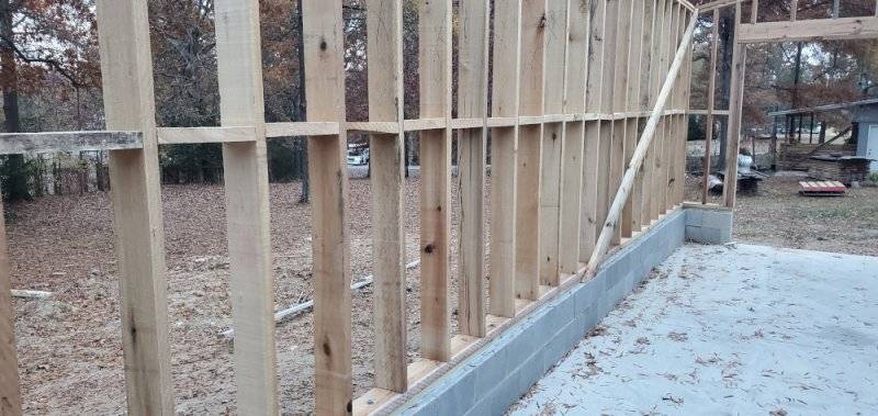

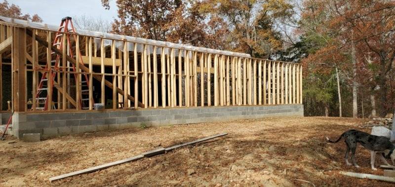

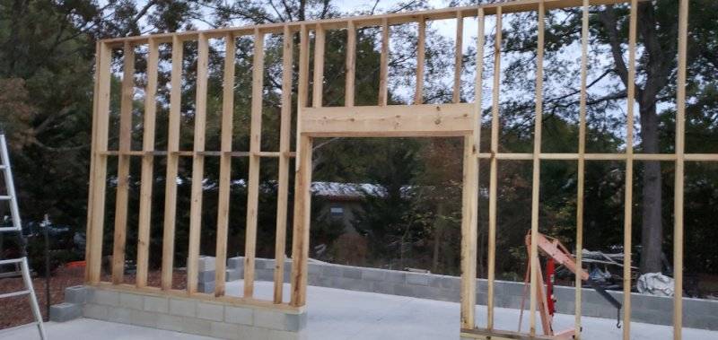

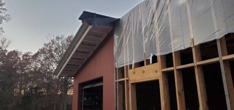

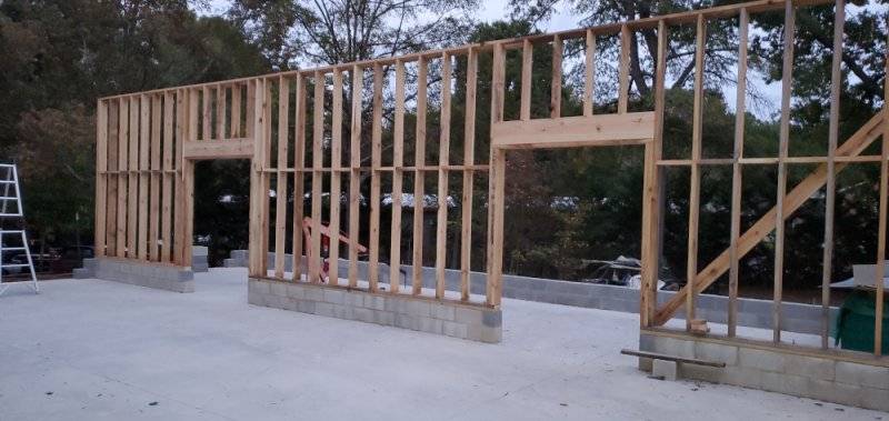

Got the doorway and header all set up and in place . . .
Then got the remainder of the fire stops in the end piece of the wall . . .
All done, with the exception of needing a 2nd header across the top of this whole wall . . .
Tried a different view, but the 2nd header has now been installed . . .

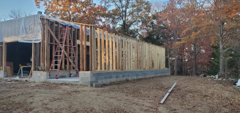

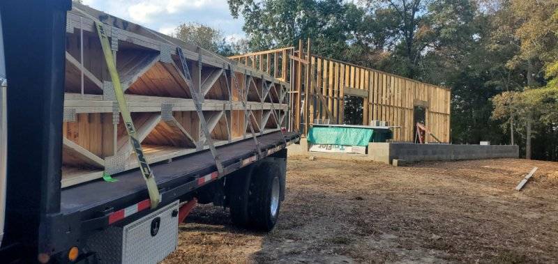

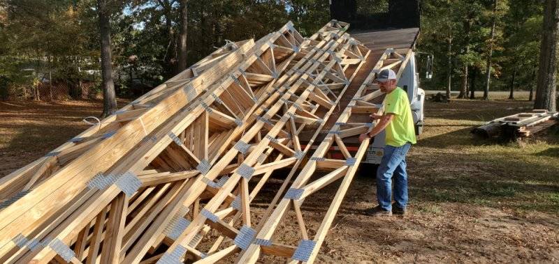

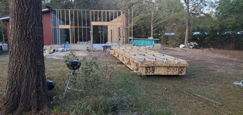

With the rain in the forecast for tomorrow, they delivered the trusses today . . . at my request . . .
Showing up at the build site and ready to drop them off . . .
But in usual "mad scientist" fashion . . . things don't always go as planned ( he was quite pissed )
But we just grabbed them all and restacked them on 6x6 timbers so they're not sitting on the ground . . .

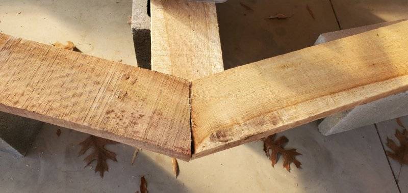

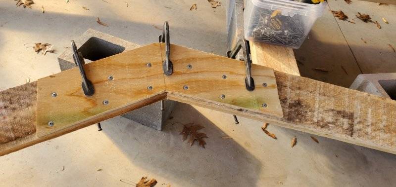

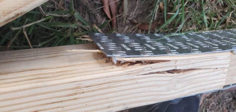

The fall caused a minor mishap and a minor injury to one of the trusses and the metal straps . . .

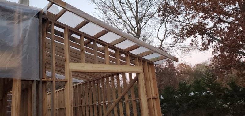

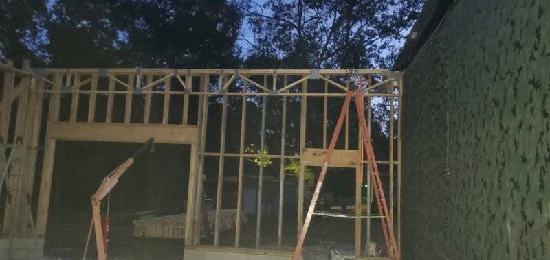

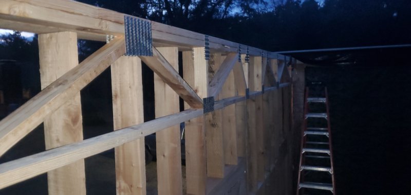

Decided this will be the first one to go up, so it's right next to the wall and I can tie it into the wall for additional support
and as the light is fading in the day . . . the first floor truss has been "muscled" up into place on the walls . . .
And believe it or not . . . it was all done alone ( again ) . . .
One down and only 25 more to go . . . these will be 2' on center . . . Looking forward to some good things this weekend !
Pretty exciting as this project is starting to make some great headway and progress . . . finally . . .

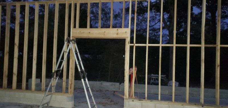

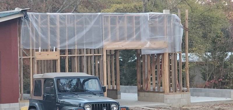

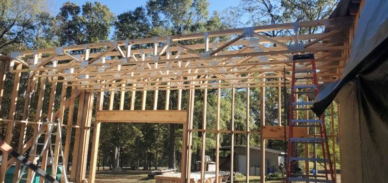

And you're probably all wondering . . . How Many did he get installed this past weekend . . .
And . . . where is our update ! ! ! We're all dying to know . . . POST your progress ! ! !
Welcome to the World of the Mad Scientist . . . and life . . . and what's going on . . .

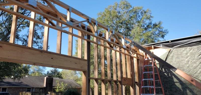

So it was started by "muscling" these 175 pound trusses into place . . . and they're heavy and . . .
NOT very fun to walk up the ladder ( ask my legs how I know this . . . ) . . .
Got # 2 installed . . .
The proceeded to get 4 more . . . or the first 6 in place myself . . . and my neighbor asked if I needed help . . .
So I had another plan with the "red-neck" tow truck . . . and we were able to get 3 more done that day . . .
So the first 9 trusses have been set in place . . .
Then comes Sunday morning . . . and my neighbor heads back over to assist again . . .
And now, with a process and a plan . . . we got 7 more installed in about 2 hours . . .
Could have done more but ran out of concrete . . .

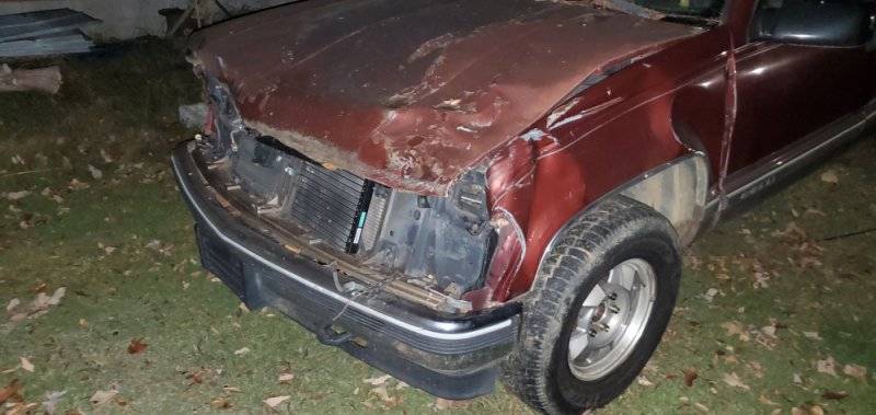

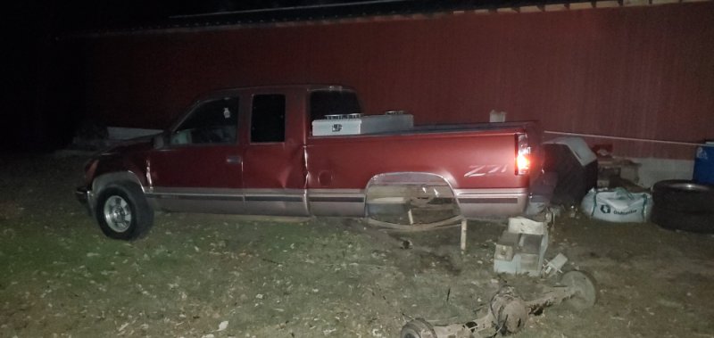

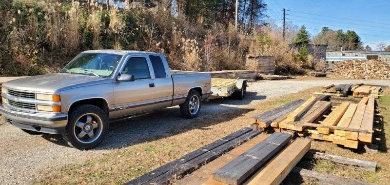

Then comes a wrecked 1998 Chevy Siverado on CL . . . and I've been looking for another rear differential . . .
So for $1000 - this deal could not be passed up . . . so that had to get picked up . . . and this needs to be swapped !
The cows did a bit of damage to the truck - and from what I heard, 2 of them did not make it . . .
And the last 2 days have been spent on getting this out of the truck to get in installed in my truck . . .
The one that was installed in my truck in Florida is a complete P.O.S ! ! ! Throwing oil all over the underside ! ! !
And it's howling like crazy . . . but all I can say is that is got me home . . .

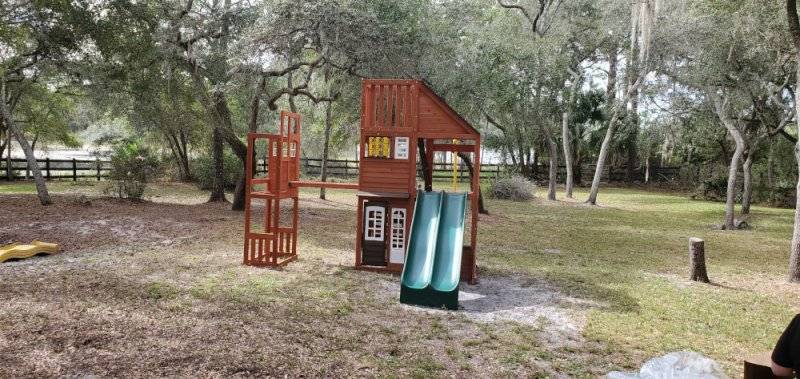

So a good deal also came up on a swing set at Costco . . . and it is now sitting in my daughter's garage . . .
SO . . . I'll be heading down to FL next week to get the swing set build for my grand daughters ! ! !
Can't wait ! ! ! ( even if it takes away from the shop build . . . spoiling them is more important )

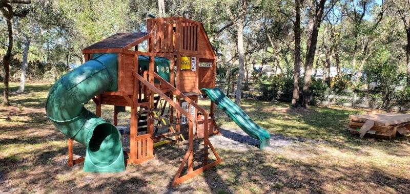

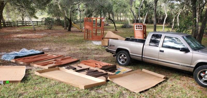

SO . . . I'll be heading down to FL next week to get the swing set build got my grand daughters ! ! !

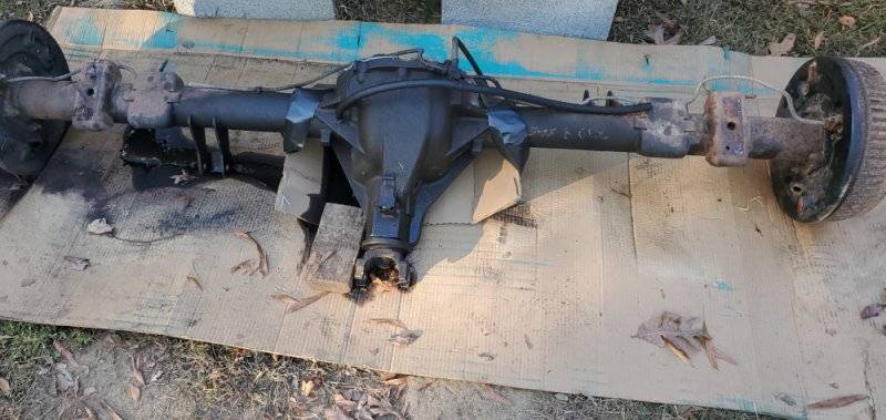

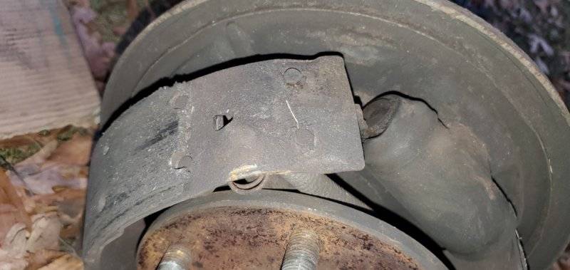

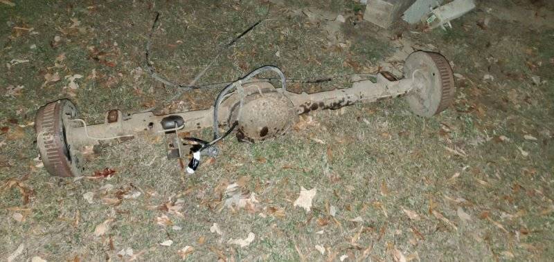

Whoa . . . this is really frustrating - and the reason that I do the work on my cars myself . . .

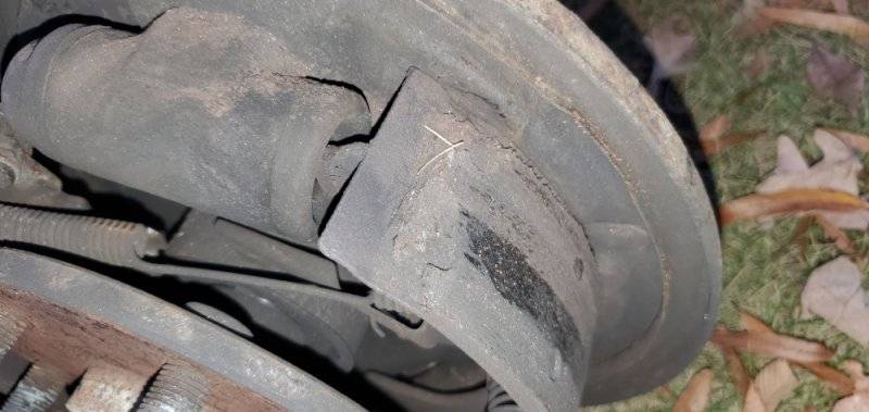

Here's the rear end from FL that was pulled from my truck . . . and the oil under the truck is worse . . .
( I'm pretty sure it's NOT suppose to look like this . . . )
One of the drums fell off the axle . . . and parts starting falling off too . . .
- by the way - none of the rear lugs were tightened to specs ( shame on ME for trusting them . . . )
This brake shoe should probably have a bit more shoe on it too . . .
As should this one too . . .
I can't even believe that anyone ( in their right mind ) could sell this POS and put it on a truck in good conscious . . .

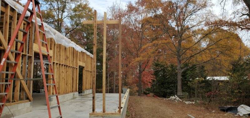

So work on the shop on Friday was a bust . . . spent the day traveling . . .

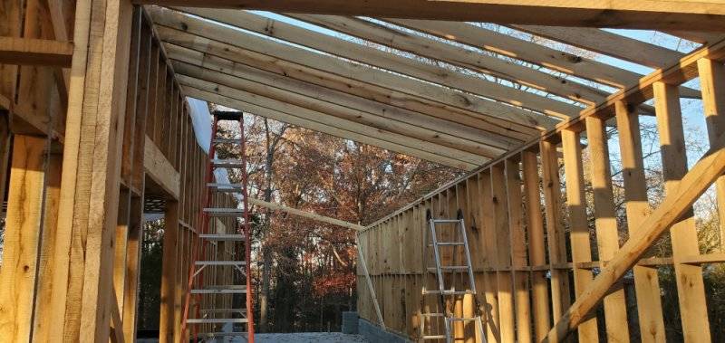

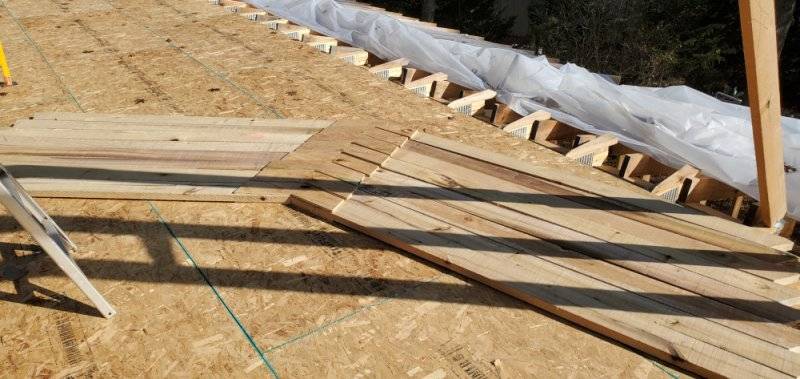

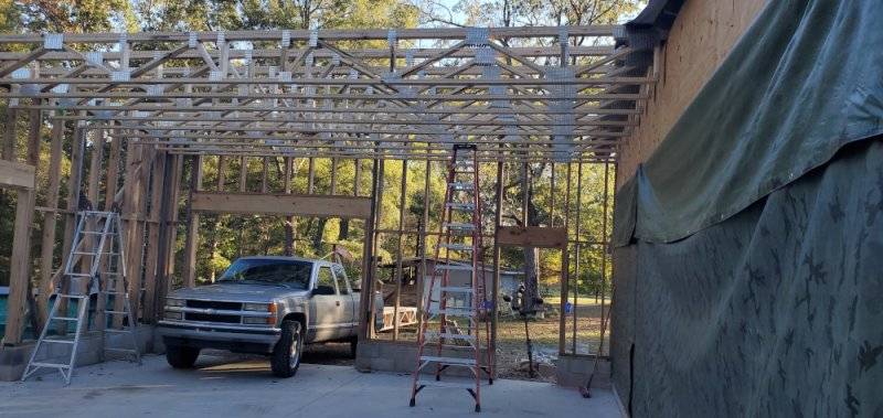

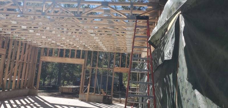

But . . . This morning, the remaining 10 trusses were put in place . . . this looks incredible - Love it ! !
Still got to get all of the secured in place - they were just set there to get them off the ground a fast as possible . . .
And . . . next, the decking will need to be installed . . . that's the plan for tomorrow . . .
Had to lay out a few pieces of the decking to see how it's going to look . . . WOW . . . is all I can say . . .
Got a little more than half that still need to be secured - but it's going much faster now . . . then decking . . .

Yeah . . . only took 400,000 miles, 4 rear ends, 3 transmissions . . . but the original engine ( which is very tired )

If building the shop is not enough, found yet another project that needed to get done . . .
This was basically on sale at Costco . . . and I figured that my granddaughters needed this in their backyard . . .
No big deal . . . but remember that they live in Florida ( only 8 hours away )
This is the ominous beginning of the project . . . 5 boxes full of wood parts and hardware . . .
And . . . a 200 page assembly BOOK . . .
Getting started and laying it all out . . . didn't help the daunting task . . . plans were to have it done on the weekend
( 1st day of the project - mom calls from home - we have NO Water at the house . . . oh great ! ! )
Working my way through the build and now I've got a new "temp" inspector for this project . . .
Spend a whole day building on this thing, and the piles don't seem to be getting much smaller . . .
and the swing set seems to be quickly growing in size ! ! ! What took the longest - FINDING the parts in the boxes !
Keep adding parts . . . keep moving things around to find a good level spot . . .
This thing is really amazing . . . and the girls absolutely LOVE it . . . but give this a thought . . .
Me - 6' 4" and I'm trying to crawl around in this thing as it' needs to be put together - it had to be comical ! !
Obie was chillin' from his usual "inspector" job with the new "inspector" on the job . . .
Got about 90% . . . and just plain ran out of time . . . was not able to get the swings built and attached
( getting dark at 6:00 ) does not help . . . either )
Just another view of the new toy for the girls . . .
My daughter had a good laugh . . . the instructions "stated" that it would take 3 people to build the tube slide at
the end of the set . . .

FOLLOW UP . . . my daughter and son-in-law got the swing built and attached today - it's now completed ! ! !

But now . . . for the build . . . figured get started with a simple step to get back into the swing of things . . .
( after drawing this up on SketchUp . . . I knew what my lengths needed to be . . . )
THIS . . . was the "easiest" wall section that I've EVER installed ! ! !
Then got the header in place - it's too long because I forgot that the other wall header was in the way . . .
After that . . . I could not resist getting this thing turned around the corner . . . boy did that feel good ! ! !
BUT . . . how far down the wall do you think I was able to accomplish today ( yes this was all done TODAY )
Well . . . if you guess "almost" the entire wall . . . then you were right on the mark . . . .
The first 10" section, followed by (2) 16' sections . . . do need to get the header in place for the garage door . . .
And . . . still need to figure out what I'm going to do with the back wall . . .
Actually - for this section, leaning toward the same as the other side . . . just a big blank wall . . .
Guess what that means . . . MORE concrete work . . . Again . . .
As you can see from this view, only a small section left to get this completed . . . and roof rafters go up ! ! !
A full view of the shop as it's starting to take shape . . .

The center section 25 x 50, covered in plastic, means that I've got that section "in the dry" and can work there . . .
Kinda . . .
Had (2) steel plates leaning against the shop side wall . . . 50' of wall to place it on . . . and we had rain . . .
Had only (1) leak from the rain . . . where . . . right on TOP of the steel plates . . .

Monday's task was to get the jack studs and header installed for this garage door . . .
( the night shift did it's duty and got the job done . . . )
Tuesday was a trip to Asheville to pick up some 1x6 purlins for the metal roof . . .
Sorry Devin - this was such a small load and this Mill ( which I finally found ) was only 2 hours away . . .
Wednesday's task was to get the top of this wall framed in and get ready for more weekend building . . .
Friday was a big day . . . got a whole bunch of stuff done . . . .
- finished up the last 7' section of wall and got it installed
- got a bunch of the fire stops installed on the wall
- got all the second headers installed on all the walls . . .
- got the diagonal brace install in this corner of the wall
Saturday's task was to get started on the roof rafters . . . and made a really good dent in them too !
( actually got the first one up Friday . . . had to figure out how the other side had been done - again )
- also got the other diagonal brace installed in the other corner - and (1) roof rafter at the back
( to try and keep this thing somewhat square - in the process )
- also finished up all of the fire stops in this wall
The other side - that is already built - has a 2' overhang on it . . . and this side will need the same thing . . .
So Sunday's task was to work on that and try and get that part done . . . Job completed
- expecting rain this week - so it's covered in plastic to try and keep it dry . . .
Also - got back up top on the flooring and got that last row of sub flooring fully installed to get that off my list . . .
All-in-all it was a pretty good week, and great weather, to allow me to get a bunch of stuff done . . .
Was hoping to get a bit further . . . but really can't complain as it's moving along pretty nicely ( in my opinion )
Just fighting lack of daylight, possible rain, and colder temps . . .

Long Holiday weekend with expectations to get a lot done . . . but . . .

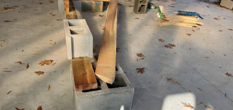

Well, when you don't really know how you're going to get a job done,
you have to take time and figure it out . . . That's what slowed me down . . . greatly this weekend . . .
Got my center beam in place . . . and half of a truss up . . . but the other half ? ? ? how ? ? ?

The the other piece is set into the form and - again - the line should be close to the point of the truss . . . it is !
On this board you can actually see the pencil mark on the board for alignment . . .

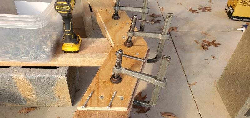

Once everything looked good, glue was applied to both plywood truss webs and put into place . . .
Setting them up on cinder blocks allowed both sides to be set in place at one time ( and not screw into my concrete )
The use of the clamps GREATLY helped this part of the build . . . allowed for final alignment and let the screws
go through INTO the opposing web for better shear force holding . . . Huge speed improvement too . . .
Next, for setting the screws, they were offset a bit from the front and the back . . .
- the front ones are set in the web . . .
- the 2 screws set on the bottom show the location for the back side of the web ( very good coverage )
The screws set into the back side of the truss - yeas leaving the clamps on help this step as well ! !
Here are 8 trusses that were built this morning . . . takes about 10-15 minutes to build one of them . . .
( of course - these are being built on ground . . . and where do they "need" to be . . . upstairs . . . ARGH !
So . . . they all got carried up the ladder and set upstairs for installation . . . when I get a plan . . .
( or has a plan already bee figured out . . . ) Sorry . . . my 10 picture limit has been reached . . .
Was hoping to have a good many of these things installed, but forgot that they also needed to get built too !
Ruh Roh Shaggy . . . Working on getting things figured out on how to "safely" get these thing into place . . .
Little bit intimidating standing on a ladder, on the second floor with a long drop right next to you . . .
My entire stack of 10' boards has been moved to my shop area . . .
- all of the boards have a 17 degree angle on one side - these have ALL been cut into the boards
- then the side board also has a 34 degree angle - ALL of these have been cut into the boards
- lastly the top board also needs a 22 degree angle - ALL of these have been cut into the boards . . .
And . . . all of the plywood webs need to be cut out of 4 x 8 plywood . . . ( oh boy ! ! ! )
Now all I've got . . . is a whole LOT of trusses that need to be built . . .
