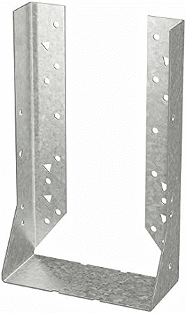

I'm not sure if this is rhetorical. If not, here is what I thought of:
*The face boards could be removed...the ones that would sit below the header. This would allow you to use a hand crank hoist to just lift the header in place....straight up to where it needs to be.
* Two Simpson HUC hangers can sometimes be enough to retain the header depending on size and span. One could be attached to one king stud that is left in place, the other can be attached to the other king stud cut loose at the top and tilted away. This would allow you to raise the header up using the hand crank hoist, slide it into the HUC hanger on the fixed side, then slap the other king stud over and nail everything off.
The HUC term refers to "Hanger with concealed flange"
This allows you to attach a 6x header to a 2x6 wall. The same applies to a 4x hanger and a 2x4 wall.

I would NOT put it together with those brackets - I would not feel comfortable with them
( but what they had in place was not much better )
Will be posting pics and description of what was done . . . soon . . .
Those hangers are designed to hold incredible amounts of weight. We have used them in commercial construction for years.

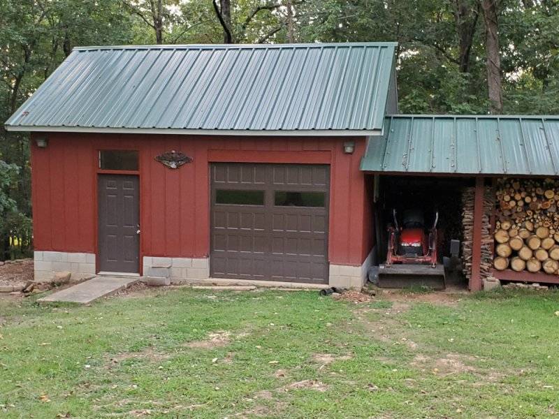

Finishing off the finish work on the "moved" garage . . . finally . . .
It's been a while in the process, but getting back to getting this completed needs to be done . . .
When I stated, "how will the header get into place" . . . the plan was already determined and executed . . .

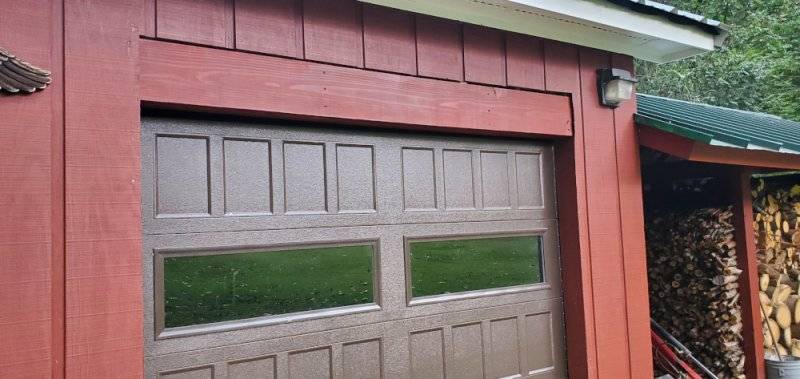

Let's take a look - what made me decide to add in the header . . . in the first place . . .

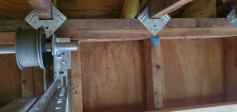

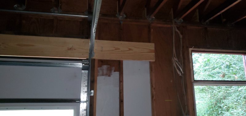

First take a look at what this building had in place for a "header" ( and the term is used very loosely)
- a single 2x4 and vertical studs to frame up the wall - support ability . . . Nearly "minimal" at best . . .

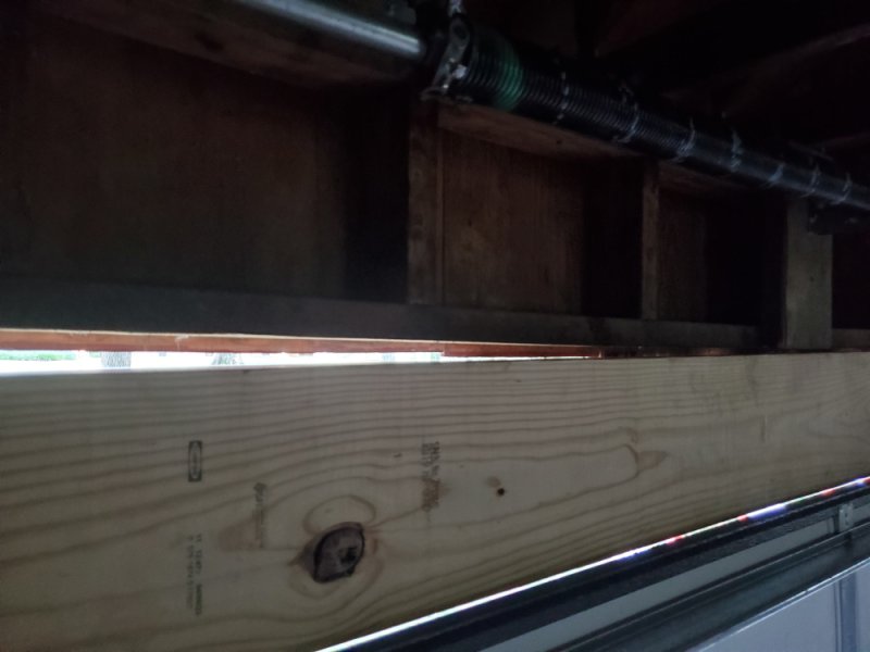

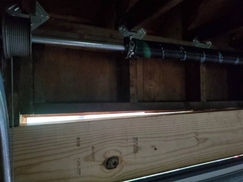

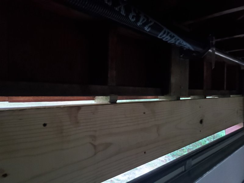

Take a good look at the gap that is above the new header - 1" clearance at the left - touching in the middle . . .
Now it's starting to look like a more completed project . . . be nice to get it all wrapped up and done !
Came back and lifted up the wall, and got some spacers installed ( in line with the 2x4 studs above )
To help hold up the wall . . .
- code calls for a double 2x6 for this 8 foot span . . . my addition is a triple 2x10 . . . BSH style ! ! !

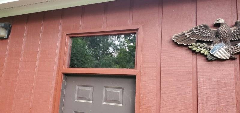

Got the window orders and installed ! ! ! Yay ! ! !
You saw this already, but even got the header painted so it actually looks like it's part of the building . . .
This side of garage door had (3) 2x4's in the wall - 2 of them got removed and the header sits atop the other (2)
- what you see here is the 3rd 2x10 that is sistered to the other two plus spanning 2 additional studs for support.
overkill ? ? ? maybe . . . but BSH style . . .
Now when I asked - how will it get put into place - if both sides were 2 deep 2x4 pockets, it would NOT happen
- just like the rest of this building, this side of the door ONLY had 2 2x4 studs in place ( and my life saver )
- was able to remove the (2) 2x4 studs, the thickness of the header and get it ready for the install . . .
- next - slid the header into the opening far enough to allow it to be moved "back" into the pocket on the other side !
- after that was done, an additional king stud was added ( the very new piece of lumber ) seen on the left
- lastly - the 3rd 2x10x12 was sistered up to the supported header, and screwed into place - Much better than before !
It might seem like overkill, but at least I know that building will not be collapsing on me anytime in the near future.
Or - ever. The weight of the header fully resting on 2 2x4s that are fully resting on the ground . . .
- is so much better ( and in my mind safer ) then the brackets that were proposed ( yeah - they may be OK )
- but I'd prefer to have a nice solid base holding the header ( and the roof ) in place . . .
Now I get to go back and redo the garage door . . . and get it functional again . . . when the center moved up 1",
the bar for the spring had a bow in it - and needed to be moved ( remove all the tension - move it - redo the spring )
Still got to get the spring redone . . .

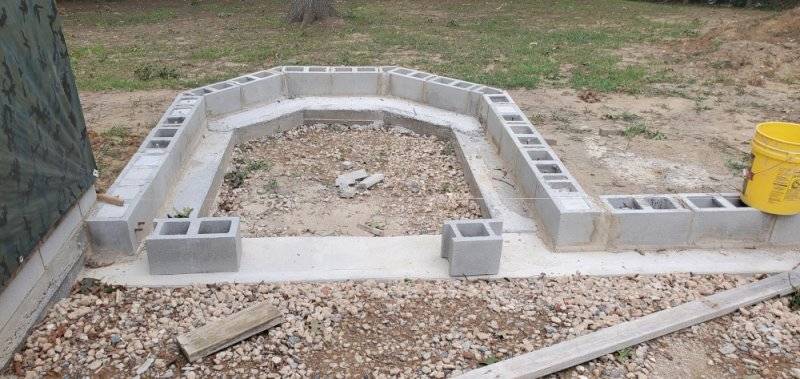

If I EVER decide to make something octagonal with block again . . . hit me up side the head ! ! ! Please ! ! !

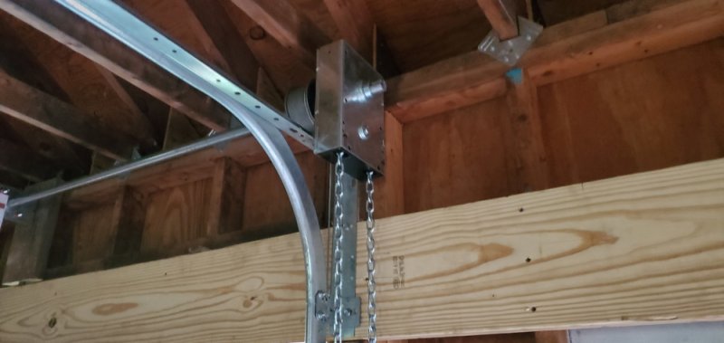

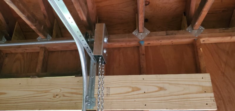

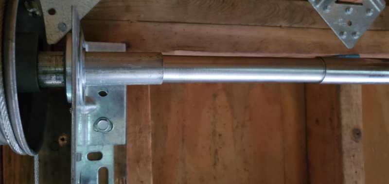

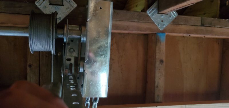

Since this shop does not have power yet - I decided that I'd like to put a chain hoist on the door . . .
Got enough room to make it happen . . .I'm pretty sure . . .
Ordered the unit . . .and - guess what - Looks like it'll work . . . BUT . . .

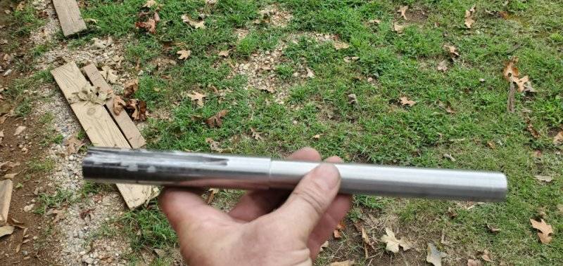

The unit has a keyway in it . . . and the garage door hollow tubing . . . so, I had to think this through . . .
As for fitting - it looks great and fits up there nicely . . . Now for the keyway problem . . .
Took a piece of 1" solid bar stock and cut a grove ( by had - with an angle grinder ) - only option . ..
- Sorry - the bridgeport is in the other garage in storage until this shop is completed
- actually didn't turn out that badly . . . turned down 1/2 the shaft to be a press fit into the tubing . . .
Plan is . . . get this hammered into the tubing, and then have a means to catch the keyway . . . I hope . . .
Actually - could not have worked out any better ( even with the hand cut grove ) - call it a WIN !

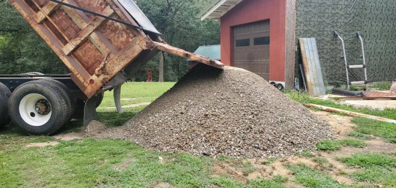

It's getting the time . . . another load of crush-and-run gets delivered . . .

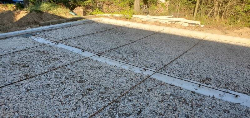

And the foundation has been worked on to get it to a hopefully consistent level for concrete . . .
And . . . the installation of the rebar and wire mesh is beginning . . . we're getting there ! ! ! Slowly, but surely ! !
Got a shipment of more rebar and metal mesh being delivered on Tuesday for the rest of this foundation.
LOT of work left ahead of me, but it's moving along and I'm seeing concrete might be getting poured "soon" . . .

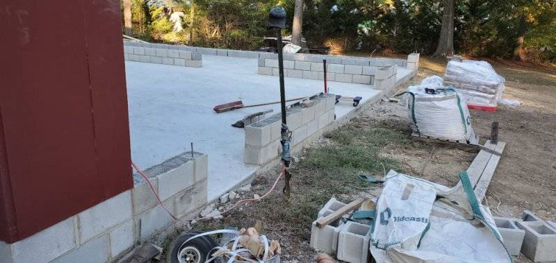

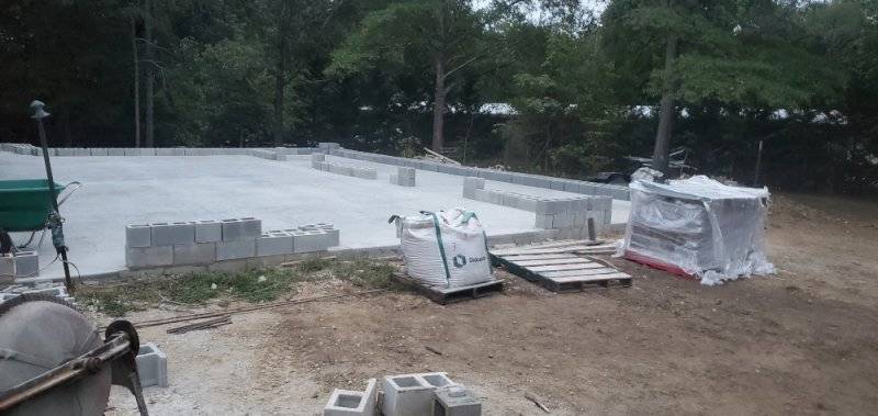

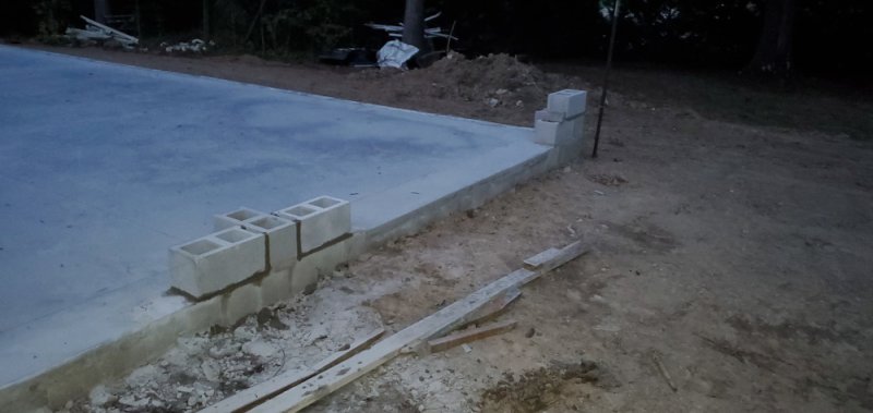

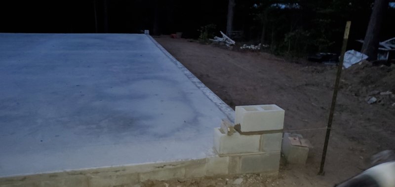

So the materials have been delivered to get the foundation set up ( like this ) for the pour . . .

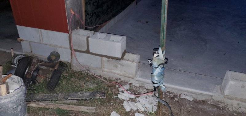

Had a little issue with the back wall - and I'm not quite sure how I managed it . . . but it's resolved now . . .
Also added rebar to the block for a little additional strength . . . . .

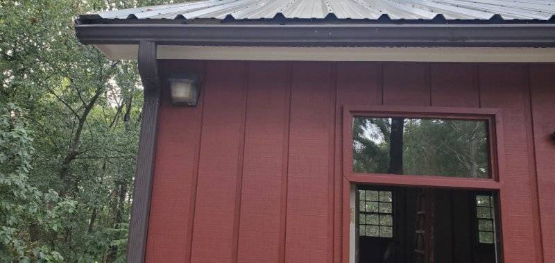

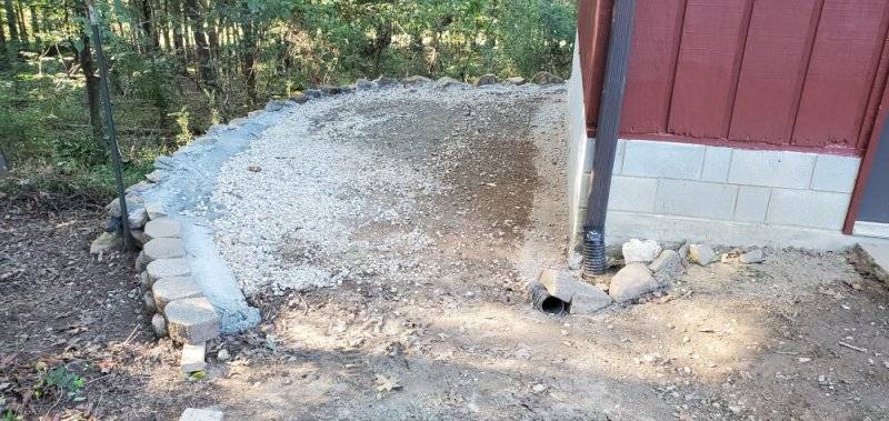

Got the front gutter up an functional on the shop . . . even got the downspout water, set up and running under
ground . . . and dumping out behind the shop . . . I'll get a pic of that . . .

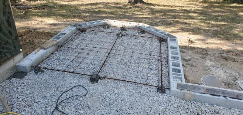

So . . . the next plan of attack is the metal mesh and rebar setup for the concrete pour . . .
That'll keep me busy for a bit . . . but hopefully, no TOO LONG . . .

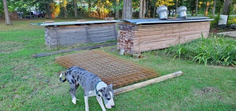

First of all, got my shop supplies delivered this week, to allow me to continue with the foundation . . .
Rebar - between the stacks of lumber and the metal mesh - both for the concrete . . .

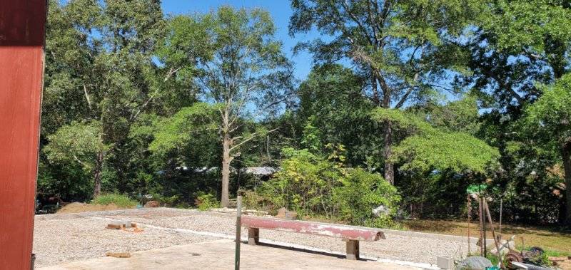

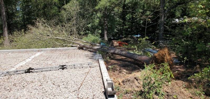

Had (1) tree that was a bit too close to the shop for my liking . . . got to use a new toy for the tractor . . .
This thing is pretty cool . . . the light weight of the tractor doesn't help, but you can pic your way thru the roots
And the final result . . . it "had" to fall on the foundation . . . go figure . . . It's already cut up and no damage

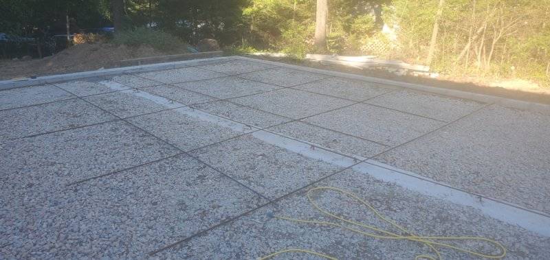

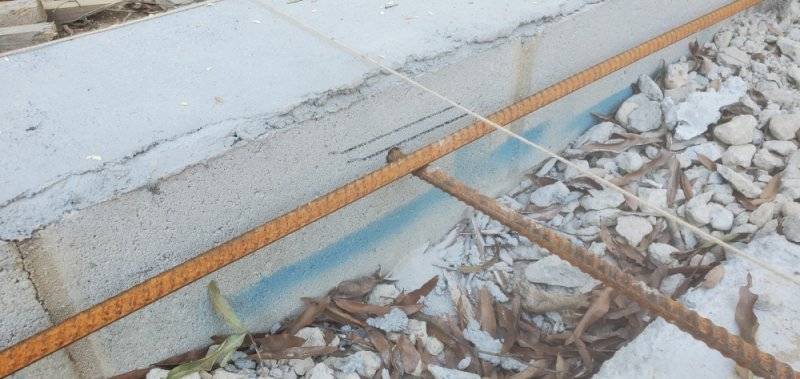

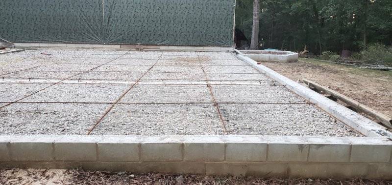

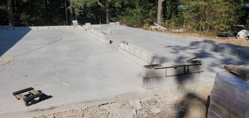

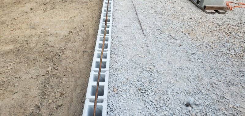

Now - on to the rebar . . . drilling holes in the blocks to add additional strength and tie it ALL together . . .
These are being placed 5' on center for the width of the metal mesh . . . they are 5 x 10 . . .
Then here is where I wish I would have made a very minor change . . . but this should work out alright . . .
Put these - also - on 5' spacings . . . but the 10 foot length included both side with 6" of metal strands extending
Really wish I would have shrunk these up 1" to allow a little more space to tie the mesh to the rebar . . .
And now . . . the first of 40 wire mesh panels has been put into place . . . and the work is moving along . . .
Even got an extra day this weekend - Labor Day Monday . . . Might be calling for Concrete this week . . .
At this point, I've got about 1/3 of the rebar in place, but it's going faster now that I've got a plan . . .
And the missing tree . . . probably have a picture further back in this build with that tree in place . . .

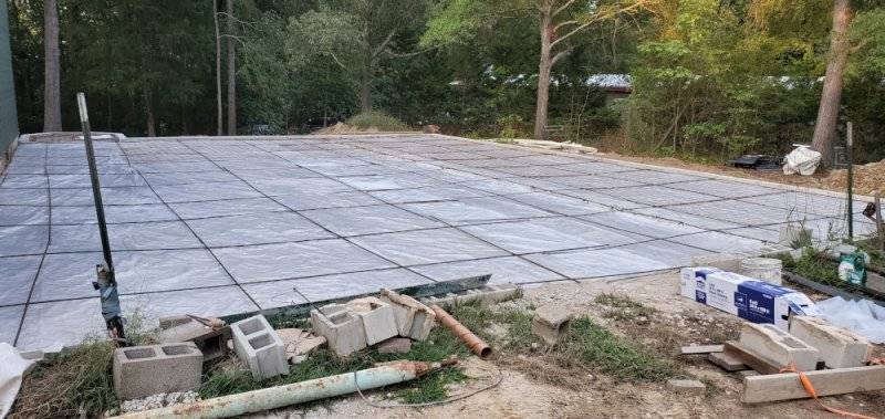

Working on the concrete pour, and had a minor change in plans . . .
The "plan" was to get the foundation for the shop done and ready for the pour . . .
Asked my concrete guy to come and look at the work . . . is is ready . . .
Well . . . he did NOT like the concrete pad in the middle of the foundation,
his words . . . we need to remove it or the concrete will crack . . .
heartbreaking . . . after all that work . . . BUT . . . I have need for concrete elsewhere . . .
So, now we're looking at a 2 phase plane . . . 1 - Moved building, 2 - new shop . . .
And . . . he's coming back in a week to do the pour . . . ( OH SH*T . . . )

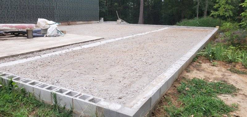

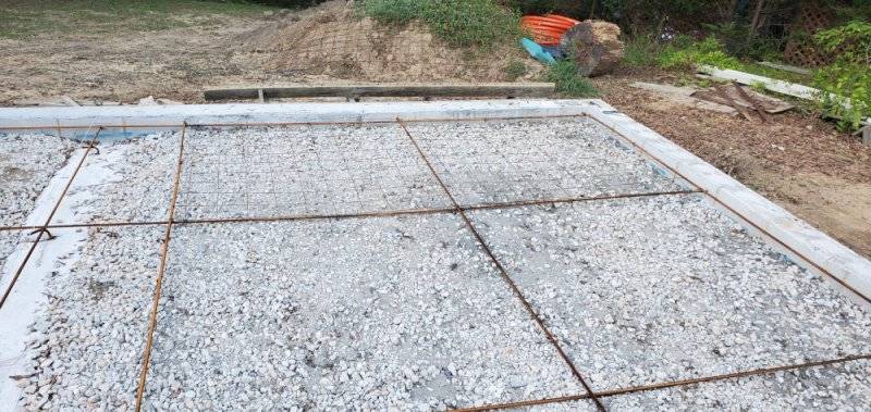

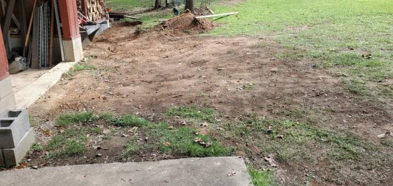

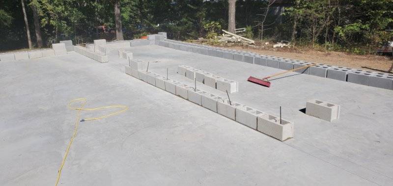

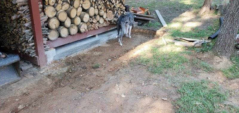

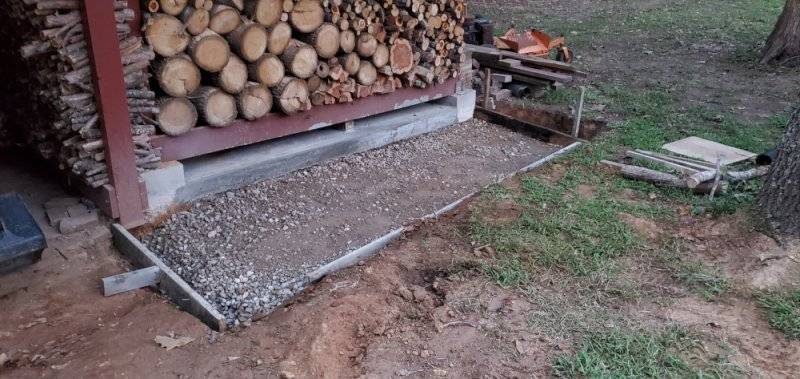

Didn't like the original way that I had this set up for storage . . . so it got re-done . . .
This was slated for a 6' pad out from the building . . . but the ground needs a little work for that to happen
( or ALL the water will end up IN the shop . . . )
Finally got this all wrapped up and ready for the pour . . .

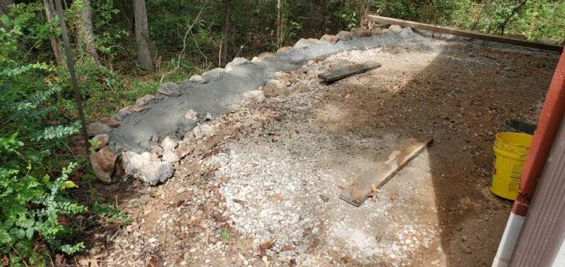

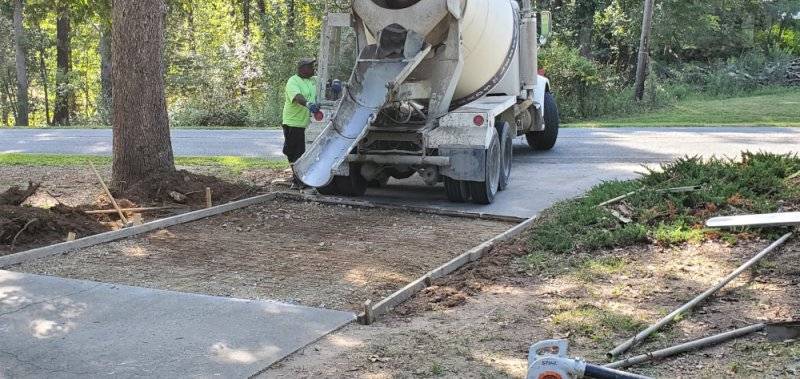

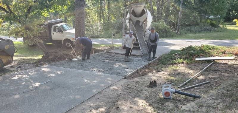

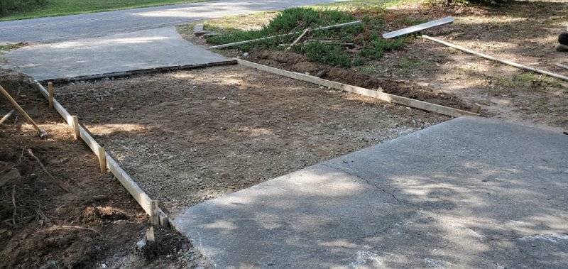

While they're here . . . might as well add a pad here so I'm not waling in mud . . . dig it out . . .
Frame it up, get some gravel in place, pack it down . . . and it's ready ( this was an add on )

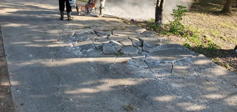

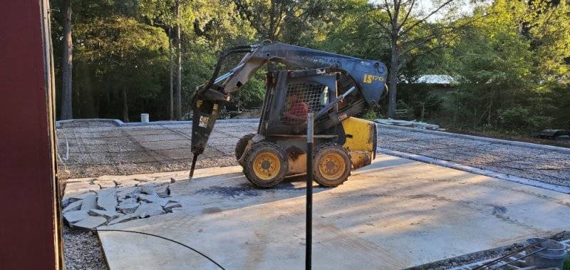

Also, part of phase 1 - removal of the concrete slab . . . I let them handle this ( this is the way to do it )
- this brought up a very concerning item as the pad was removed . . .

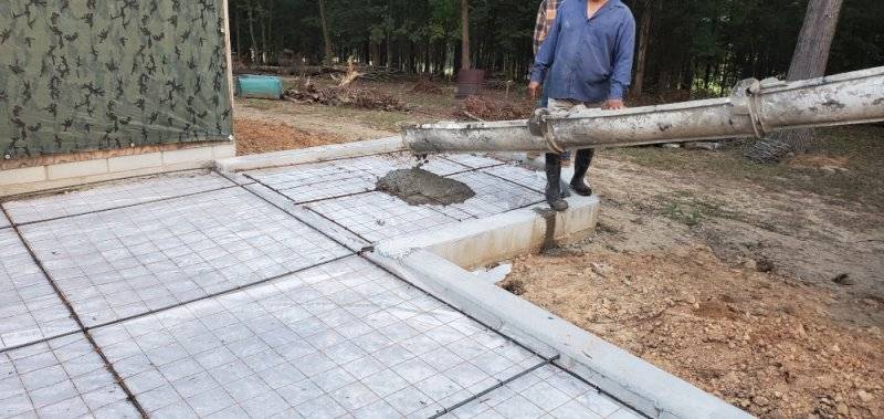

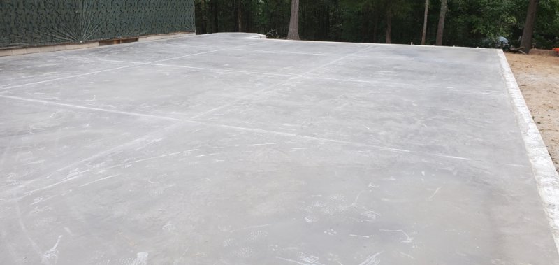

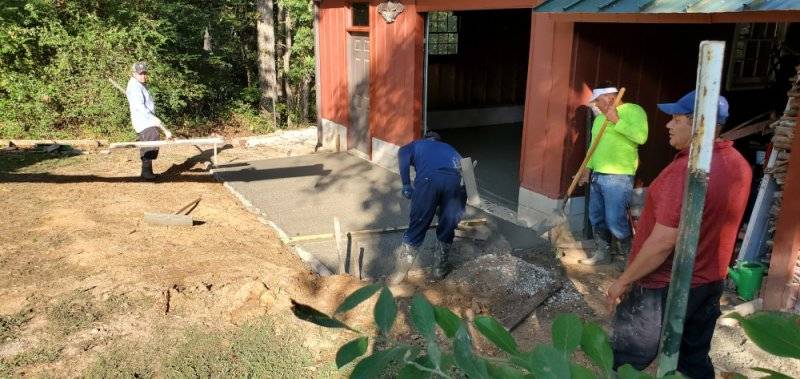

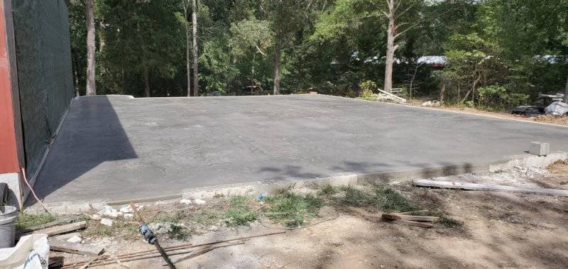

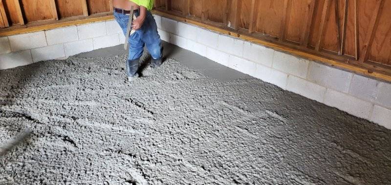

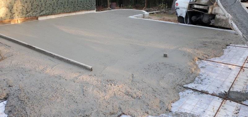

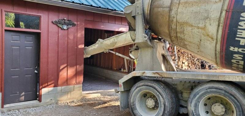

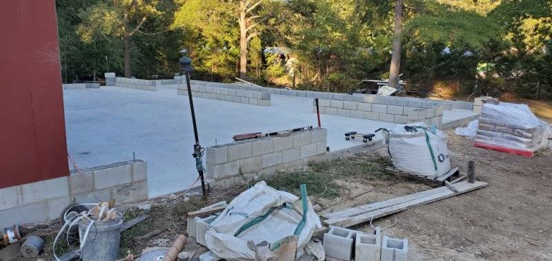

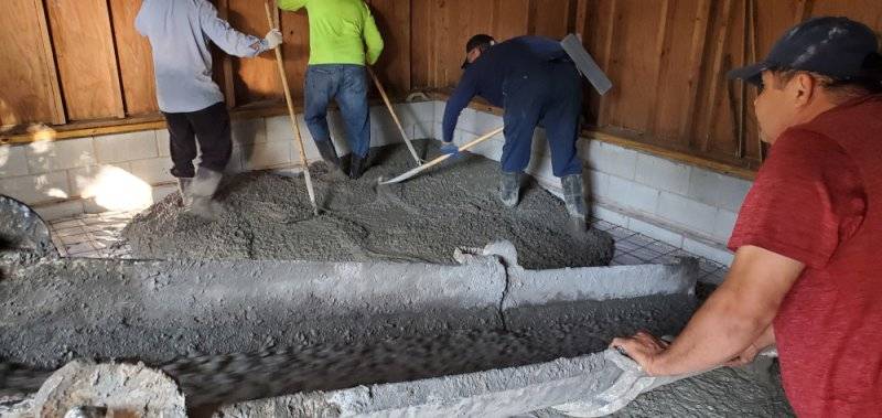

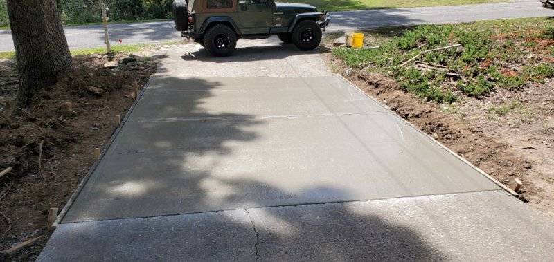

So the time has finally come . . . they just backed the truck into the garage and got started . . .
( not really - but that's what this picture looks like . . . )

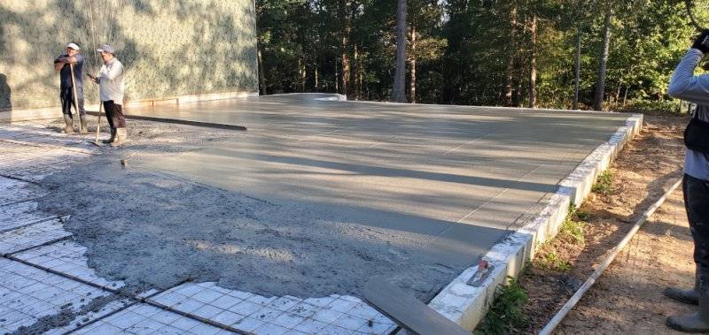

And we're off to the races . . . this is such a pretty site to see . . . after all this work . . . FINALLY ! ! !
And the beginning of the finish work . . . floating in the edges and getting all the concrete level . . .

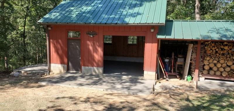

As I said, this was "slated" for 6' . . . but when I laid it out, I was not very happy with it . . . so it's now 8'
And . . . MUCH better . . .
Now for the problem . . . when the pad was busted up and removed, it had a LOT of very wet soil under it.
So removing the pad actually save me from having some bad stuff happen to my shop . . . and MORE work . . .
Phase 2
- remove the wet mud from the foundation
- refill it with crush-and-run and get it compacted
- reset all the rebar that had to be moved to break out the pad
- get all the wire mesh set in place
- be ready - for Next Friday . . . to have the other part of the shop poured ! ! !
More Later . . .
Phase 2
More Later . . .

And the big day . . . is tomorrow . . . the floor of the shop is getting poured . . .
The day that has seemed to go on and take forever is finally going to be here . . .
But first . . . here's the results of last weeks work . . .
So glad to finally have that in concrete . . . and now the shop floor tomorrow . . .
I think I'm actually all ready for the pour . . . unlike last week when I was up at 5 AM trying to wrap stuff up . . .
More later . . .
Concrete has been poured . . . 41 yards total in both pours . . . Looks Great !
Long time in the waiting, and a VERY busy last 2 weeks getting everything ready . . .
BUT . . . it's ALL done now . . .
Here is the site - ready for the concrete pour in the morning . . . I'm tired . . . Long 2 weeks getting ready . . .
This was not in the plan, but needed to get fixed . . . so while they were here, had them get it done too . . .
This buckled really badly after the Duke Power bucket trucks drove up my drive to cut limbs near the power lines.
They cracked the concrete that then allowed the roots to buckle the concrete - not looking too bad here . .
But had one of the 17 Tons of crush-and-run dump trucks back over it a few time to get it a little better . . .
Don't get me wrong . . . it's still really bad and annoying . . .
Got all of the bad concrete out . . . framed up . . . leveled out - wire mesh down . . . and ready for the pour . . .
Bring in the truck . . .
Get this area filled with concrete so that they can get me a level drive way again . . . Can't wait . . .
What an improvement . . . gotta wait 3 days to drive on it, block it with my Jeep . . . so nobody drives up . . .
This was done first, but I wanted to get the driveway repair done and out of the way . . . and focus on this . . .
First, the first 2 trucks showed up and got started dumping the concrete into the forms . . .
These guys work really fast, first truck was emptied, and this is probably only 45 minutes into the pour . . .
Once the second truck was emptied, this is the look of the pad . . . and again, this is probably at 1 3/4 hours
Since I can only post 10 pictures . . . here's the end of the day as the tropical storm is blowing my way tonight . . .
So the long awaited concrete pad is FINALLY done and behind me . . . time to start the building ! ! !
Can't wait ! ! ! But - we're slated for a bit of rain today . . . not sure what I'll be able to do yet . . .
More Later . . .
And now . . . the final product . . . and Let the Build Begin ! ! !
I'm ready . . .
The Pour is completed and the slab is now ready for the build to begin . . .
Wait a minute . . . forgot that they needed to get the grooves cut into the slab . . . Now it's ready . . .
And again . . . this was a great end of the day - and exciting day, with a long time goal realized . . .
Now it is time for the building to begin . . . and I'm more than ready . . . been a very busy 2 weeks ! ! !

Give me a week and some things are going to happen . . . now that I have a pad . . . look out ! ! !
Can I see a light and the end of the tunnel ? ! ?
The other day, when I was walking to the end of the driveway I had a few visitors in the yard . . .
Started the beginning of the week trying to set up the corners of the blocks to help be able to run the blocks . . .
And the location of the middle wall - along with the for corner . . . both courses . . .
And wayyyyy in the back . . . the last corner of the shop . . .
Prepping the site for the blocks, get the blocks all set out where they need to be . . .

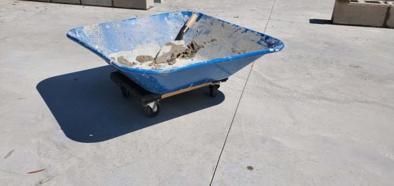

Had this idea for the mortar bin . . . and being able to move it around ( got a great concrete slab to assist )
The middle wall is kinda important as it's probably the next wall to go up and get the center section built . . .
Both course have been set and they're getting poured full of concrete and setting the anchor bolts to hold the walls . . .
Middle wall is completed less the concrete inside of them . . . but it's starting to look like a building . . .
And if you didn't ALSO notice . . . the front wall of the shop is also completed . . . and also filled with concrete . . .
And . . . the anchor bolts are set in the wall too . . .
Got a busy rest of this weekend - got a lot of concrete to be poured into the walls . . .
