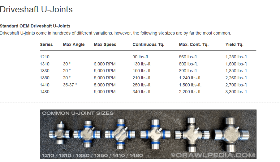

Easily can be wrong, but after some research, 1330 joints are for 'light' setups, 1350 for heavier (BB). Of course, on mine, was starting from nothing.

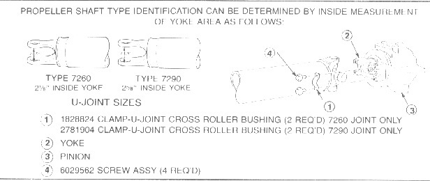

Hard to say what's considered standard, though 7260/1330 are for light duty, 7290/1350 for HD set-up.
I had run into a cobbled mess on mine, since my rear had a 1350 yoke on it. Wound up staying with it, using a combo u-joint there 1350/7290, 7290 the rest of the way.

1330 u-joints came on 66 I know and 67 ( 67 I think) Hemi cars, my 66 Hemi auto came with 1330's. I have a 68 Hemi GTX drive shaft with 7290 u joints. Back in 1986 I made two combo u joint by purchasing a 1330 and a 7290 by switching 2 cups from u joint. I ended up with 2 combo u joints. I was looking for a 1330 yoke also and looked at spec's of u joints. Can't swear to this, if I remember the only difference is cup size between u joints. The cross piece is the same in 7290, 1330 and 1350 u joints.
Fran - that's what I discovered when I cobbled something together for a u-joint at the rear end - bought two u-joints and made one. The cross piece was the same. I think the yoke on my 489 used a 7290 so I ended up with two external clips and two inside clips - works though.
Needed a drive shaft for my 65 Dodge, the Dana 60 has a 1330 yoke. Had a drive shaft made with 1350 front u/j and a 1350 u/j in back on drive shaft with 1330 cups or a combo joint.
Pulled this off a web site. The extra strength in 1350 over must be in the center part of the joint not the pin diameter where needle bearings ride IF they're the same diameter as 1330 joint.

I ordered a 7260 yoke - only one I could find matching the length of my current one at Summit, and a 1330/7260 combo u-joint. So, I guess that will work.
I hear ya...as long as it does what you want it to. I knew there are differences between yokes, and u-joints. For mine, let's say I wanted a little more 'beef ', as if I might put a little HP to it. The 7260 is narrower, and smaller diameter u-joints...but still goes round and round. Just normal to use the bigger stuff, when you add HP to the deal.
