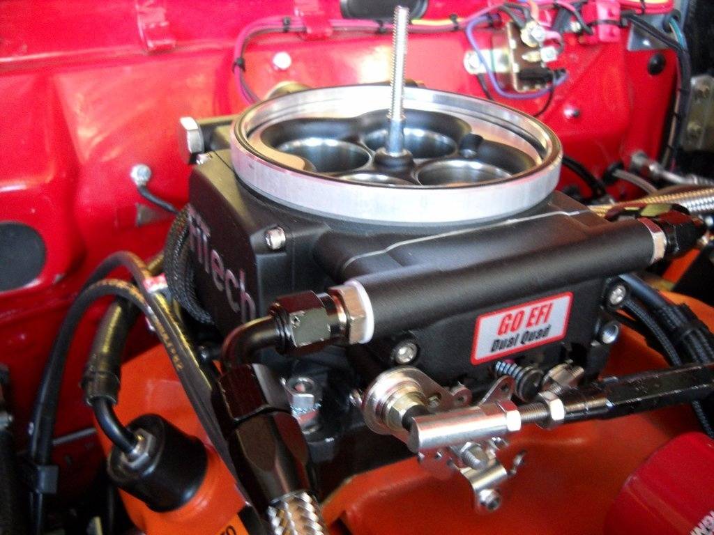

I have to throw this out there, but I can't help notice the throttle takes a considerable amount of pedal force, longer drives is very annoying. Has anybody done something different on their setup so this amount of force is not so extreme?
I assume you removed your stock return springs? If so, a lot of guys have removed the spring on the secondary side of the throttle body. If you try it, take a lot of pictures before disassembling it.
After installing the FITech I swapped to a Lokar cable assembly. I know what you mean though, the accelerator still feels "heavier".

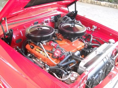

Yatzee: Your experience may be different than others on this subject. If you Google it you'll see that a lot of guys complain about the increase in pedal pressure. I asked if he had REMOVED his stock springs, as they aren't necessary. I have dual throttle bodies with a Lokar cable and a stock crossram bellcrank. I REMOVED the secondary springs from the throttle bodies but didn't like the pedal feel. I then reinstalled the secondary springs and fabricated new linkage arms to attach to the top holes on the throttle body arms, thus increasing the leverage. I'm happy with the feel now and I can get WOT on both throttle bodies.

I definitely have no binding, I'm using the BPE throttle linkage and cable, same as on the carb. The throttle cable is not binding. My stock return springs were removed, I also posted a pic of the setup earlier in this thread.
There is quite a noticeable difference in pedal force required to move the accelerator.
