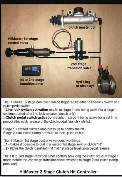

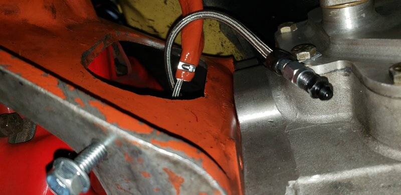

Third, since you are doing a "performance build" you may want to explore the HitMaster launch control system, which requires a hydraulic throwout bearing. I was going to get the ClutchTamer launch control product from the same company, for a regular mechanical clutch setup, but I thought a hydraulic TO bearing may help, a little, to make my 2,950 pound pressure plate a little smoother and a little easier to manage, especially in stop and go traffic, AND allow me to use the advanced features of the HitMaster.
Well I'm happy to say that what used to be a brutal clutch pedal effort is now so easy I can depress the clutch with my hand, without putting my shoulder into it!
Grant is the owner's name, and so far he has been good for tech support and advice. As soon as my car is finished, I'll start a thread on the HitMaster.
http://grannys.tripod.com/hitmaster.html

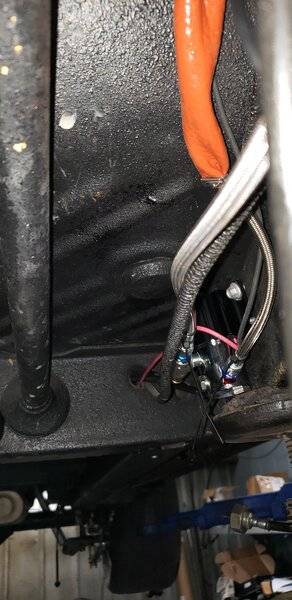

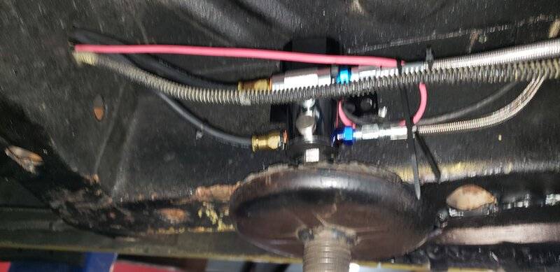

Here's a couple of pictures from the Hydramax installation and the HitMaster solenoid too:
