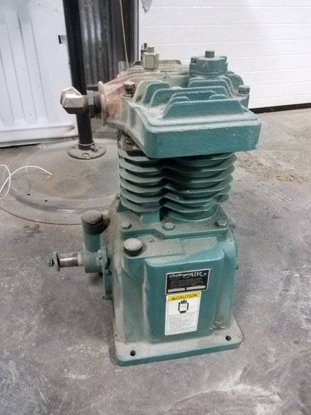

Had this donated by a friend too, I have an 80 gallon compressor from Lowes that works great but has a cheap aluminum 2 stage pump that leaks oil so this is going on. It's a Curtis pump that appears to be very well made and is cast iron so the noise level should drop significantly.

Had this donated by a friend too, I have an 80 gallon compressor from Lowes that works great but has a cheap aluminum 2 stage pump that leaks oil so this is going on. It's a Curtis pump that appears to be very well made and is cast iron so the noise level should drop significantly.View attachment 687190
I need friends like yours....
