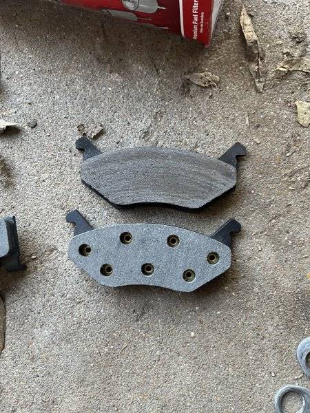

The brake saga continues. New master cylinder is working fine, pedal feels better than ever. However the brake pads appear to be glazed more than an officers donut. It’s getting closer:lol:

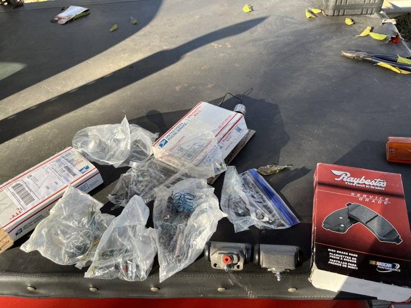

It’s been a while, but time to get back on it. New brake pads, all new rear brake hardware, including self adjusters, and smaller bore wheel cylinders. Hopefully I can solve the brake mystery and move on to other things!

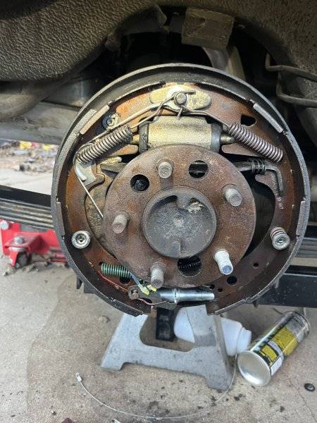

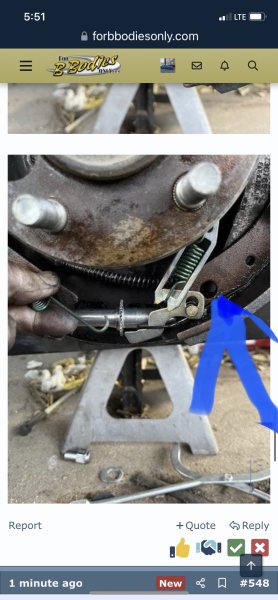

Well I got the parts put on, but something seems wrong. If I hook it this way, the lever doesn’t attach the adjuster, if I flip it, where does the green spring go?
Shoe to shoe, just like the pic is pointing it out.
And the star wheel needs to be contacting that adjuster piece.
It all makes sense now, thanks!
Yeah, that was the other problem, the adjuster not touching, but if I put the spring in the right place it probably will. Unfortunately it’s getting a little too chilly outside so we’ll have to continue working. Yes, for those of you up north laughing, Texas cold is different then northern cold!
