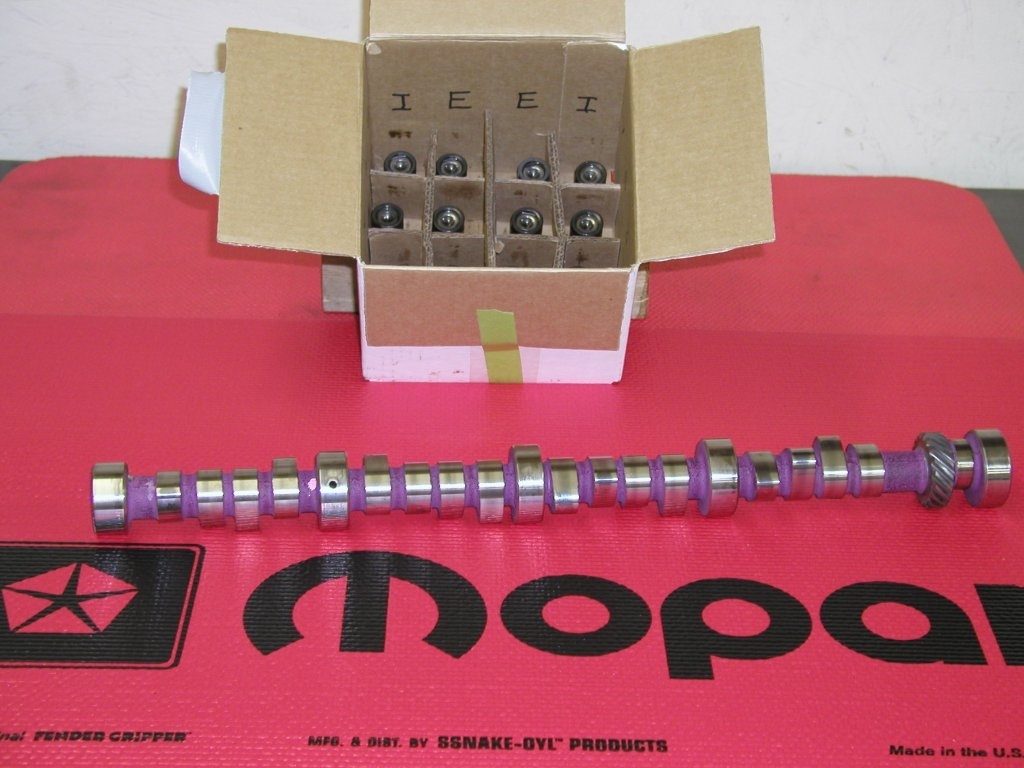

Was looking at another thread here on FBBO about these Purpleshaft Cams and came to realize that these are still produced by someone, maybe Comp Cams?? I had been under the impression that these were out of production for years now. Guess not. Anyway, the one I have in the photo is an original Direct Connection P4120235 purchased in 1979 through Herb McCandless Performance Parts out of North Carolina. It may be an antique now, guess I better hang on to it for awhile longer, even if just for a conversation piece. :drama:

Agreed, probably not a 509.
That is exactly what the P4120235 is, 0.484" lift both intake and exhaust (with stock 1.5 ratio rockers). Duration is 284* and the intake centerline is 108*.
