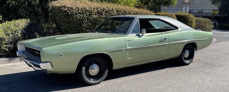

Update: Installed new msd coil no change. Adjusted timing to 18* no change. I did notice that when the motor was cold it didn’t die but once it warmed up it would start to die again. Ordered a new msd distributor so I can ditch the Chinese knock off mp electronic ignition

New distributor and all is good now. I would have never guessed distributor.

Didn’t check the old distributor. I was so annoyed with that thing I just tossed it in the corner. I had planned on changing all the cheap ignition over to msd eventually.
I would think that the car will now run 10x with the correct advance curve. Glad it’s fixed.

68 charger 383 auto idling at 850 drops to 500-600 rpms eventually dies if no throttle is added. Installed a 750 street demon since old carter was leaking from everywhere. Checked for vacuum leaksby spray contact cleaner around intake/carb disconnected all vacuum lines and plugged ports doesn’t seem to have any leaks. Adjusted carb with vacuum gauge best I could get was 12-15. Timing set at 12*. Switched to a Holley dp I had laying around same issue. Not sure if there’s an electrical issue that could be causing it, wore out camshaft, transmission/ torque converter issues? Any help would be appreciated. Thanks
