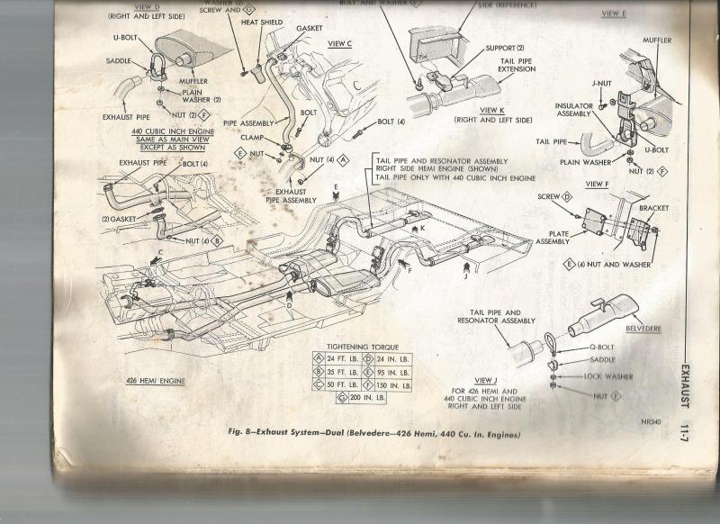

The is out of the 68 Plymouth FSM
That is interesting, I never knew they did that. They did not use any resonator on the 67's according to the FSM, was it just used in 1968?
Do not know about the years between but the 72 Plymouth FSM shows resonator on some 340 setups.
The Mopar name for the mufflers was "Sonoflex". As states, the Walker Super Turbo mufflers are the same critter as the stock Mopar muffler. Great sound!
All this discussion about hemi mufflers and no mention of the resonator in the tailpipe!
You can take the resonator off of a late '90s Chrysler minivan and get that same sound as you would with the Walker Hemi mufflers and the stock resonators. I know of at least two late '60s Mopars in my area that run this, and they sound closest to a stock late '60s Mopar musclecar as you are likely to get!

The Hemi mufflers my Bud did the research on are called: Super Turbo
Currently owned by DYNOMAX
The are identical to the original Hemi mufflers

So, he did find that this muffler was identical to the original Hemi muffler
And the original "body" of the Hemi muffler is longer as evidenced in your first post.
