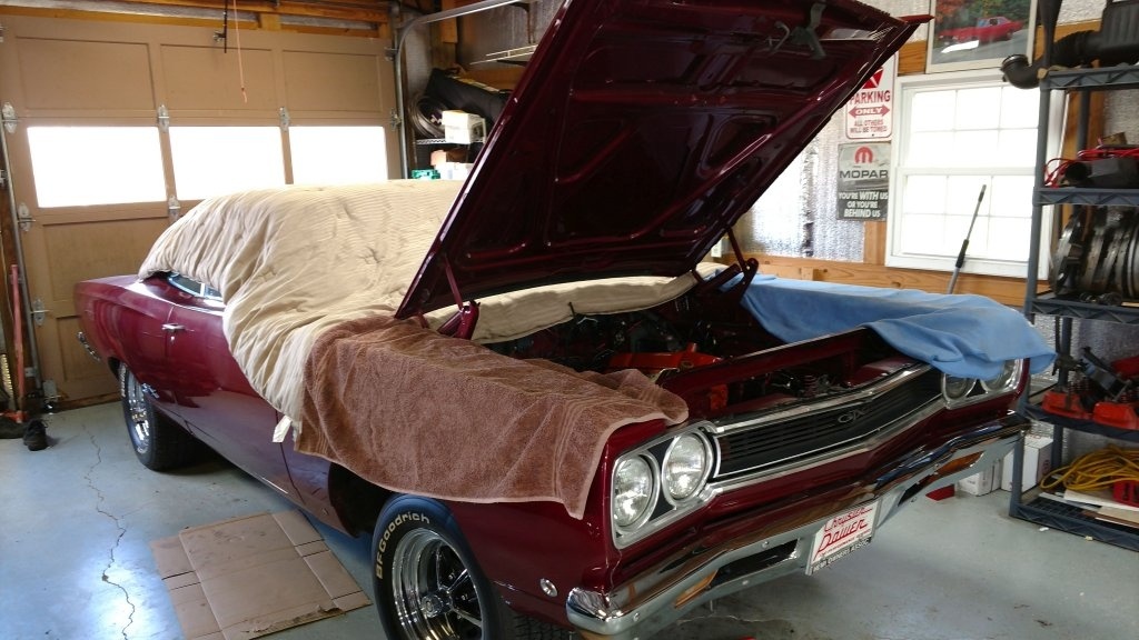

Hood on:
I lowered the hood down to where I could just barely get to the bolts on it, then removed the front bolt on each side as my wife (!) tried to hang onto the hood by the front.
Of course, I had a hand behind the corner on each side of the rear as I then took the rear bolt off each side.
Let's just say the hood hinge springs are
stout on this thing. As I got the first rear bolt out, the hood then tried to wrench itself out of my wife's hands. I immediately pounced on it and forced the hinge/spring back down.
Repeated the process on the other side, this time with a death grip on the rear corner AND forcing it down at the same time.

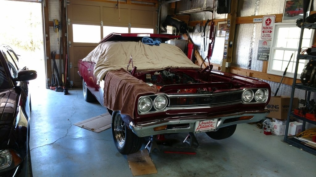

We then grabbed it side and side and hoisted it up on the roof of the car:
It's sitting on a quilted comforter and I stuffed a blanket under the latch part as well. Gave it a good wiggle to test for stability, seems ok.
