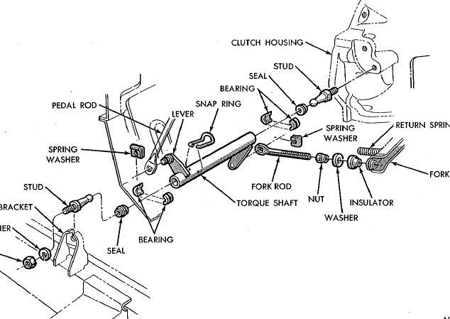

Another probably stupid question:
Removal of z-bar on clutch linkage - I'm at the point of needing to do this before we yank the old motor out. I know last time, I just pulled the motor and the z-bar stuff basically fell out while doing so.
Seems to me that's not the proper way to do it. :)
I don't quite understand how to do it correctly, though. Seems like unscrewing the nut off the back of the pivot in the frame doesn't buy me any clearance/play in the z-bar; further, the ball pivot screwed into the bellhousing doesn't look like it would be allowed to unscrew all the way out with the z-bar on it?
What's the correct way to remove the z-bar? FSM isn't real clear on the subject.

There a little spring clip made out of wire 1/16" dia. on bell housing side of b- crank. It chips to B-crank it holds the nylon piece that go on the ball of the ball stud. 1 pic = 1000 words.

There a little spring clip made out of wire 1/16" dia. on bell housing side of b- crank. It chips to B-crank it holds the nylon piece that go on the ball of the ball stud. 1 pic = 1000 words.View attachment 398546
Thanks!
The FSM has that pic, but doesn't really explain what exactly one does to collapse the whole thing enough to get it out of there. :)
