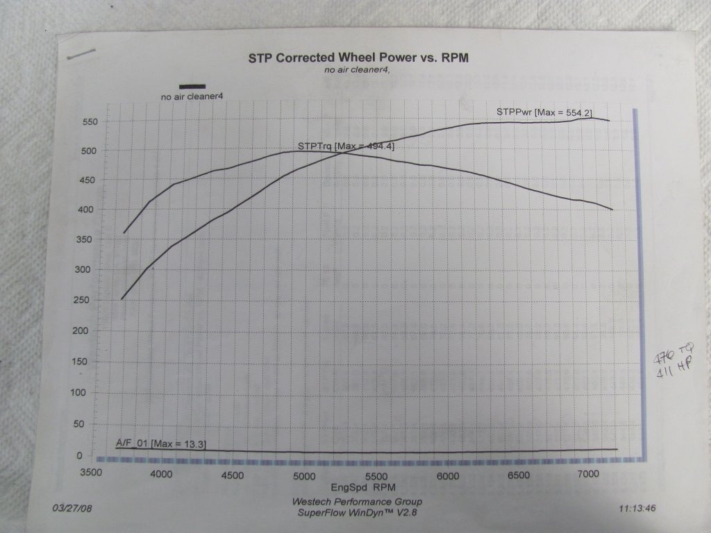

It just depends upon what you want. 500/500 flywheel horsepower/torque is pretty wild on the street but it really depends upon the driver. Here is a rear wheel horsepower chart from a '71 Road Runner with a McLeod twin disc street clutch, 8-3/4 rear, super stock springs, a pinion snubber and a manual disc brake conversion like yours. It was a 451 stroker, 9.7:1 compression, ported 906 heads and a hot street solid roller. Drove around nice on the interstate and in town but could get sideways real easy even with DOT slicks.
I don't even remember what the hand written horsepower and torque numbers are for in the lower right hand of the chart, but they don't pertain to this engine.

View attachment 330708 It just depends upon what you want. 500/500 flywheel horsepower/torque is pretty wild on the street but it really depends upon the driver. Here is a rear wheel horsepower chart from a '71 Road Runner with a McLeod twin disc street clutch, 8-3/4 rear, super stock springs, a pinion snubber and a manual disc brake conversion like yours. It was a 451 stroker, 9.7:1 compression, ported 906 heads and a hot street solid roller. Drove around nice on the interstate and in town but could get sideways real easy even with DOT slicks.
Wow, that's a lot of RWHP... I take it your point is not the combination/power but the driver in that scenario?
