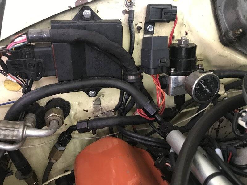

Firewall wiring, plumbing, and hardware got a little busy with the Pro Flo. FYI.

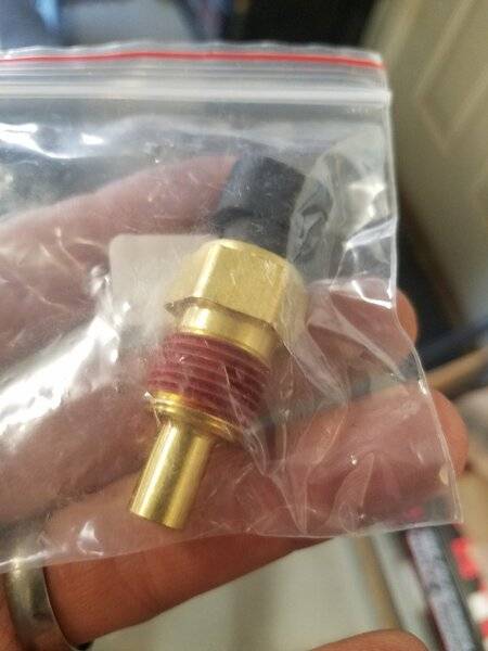

Pulled it out of the box and started messing with it. I have 2 ports in my water pump, stock and a larger one to fit the sensor included. I'll have to remove the stock sensor though so it won't be operational. I have an Autometer gauge below the dash.

Finally, the wiring for the fuel pump relay had me scratching my head. I have a fuel pump relay already, hooked up correctly. Their relay has the 87 and 30 wires switched. I'll wire it up as mine is currently.
Oh, the fitting for fuel are -6 AN. I added on fuel barbs for 3/8"
Honestly 87 & 30 are often reversed, in some applications power is connected to 87 & ground is connected to 87A so when the circuit isn't powered it acts as a ground....
