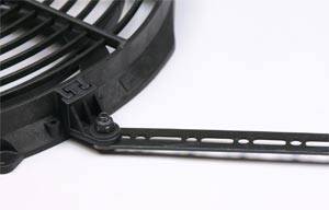

Actually I will mount them directly to the radiator with these kinds of straps from SPAL. SPAL's website says the pin type hardware will damage the radiator in time gauraunteed. Why would Flex a lite not recommend having an electric fan as the vehicles only cooling fan? All new cars have nothing but electric fans. That doesn't sound like it makes since. If changing where these fans sit does not keep my car at 190 degrees (and it won't), I will have to go electric all the way around.

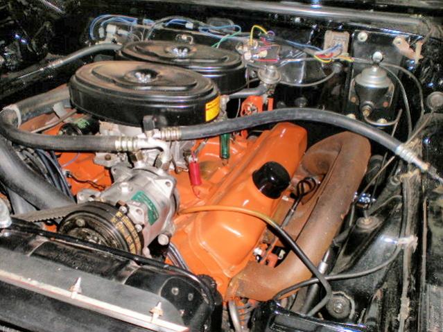

Have you ever thought of using all the origional components that worked when new ? This motor runs at 175* no matter what,on the road and idle as long as you want,never goes above 180 and temp is checked with infrared gun.Radiator is factory 22" three core,factory shroud and 7 blade fixed fan ( not flex ) and factory 6 blade a/c water pump,and it has A/C.

That is what I need. Never goes over 180 degrees. I think if I put my motor in your car you would be running hot as hell. There is nothing wrong with the cooling parts I have selected. When I end up going with a puller fan, I can use the fan I selected earlier and mount it to another one of the universal fan shroud kits like the one I have now. I will just use the box, cut a hole in it, and bolt the fan to it. Then I'll probably still have the same problem and sell the car.

So why does BigMan get to run up to 220 in traffic and not have any hot starter issues? I just don't get this. I am not worried about the car running at 220 degrees at all. In fact, I read a post here somewhere where an engine will not even be damaged until it hits 250 degrees. I just want it to be able to turn over and start like it does when it is cool. Regardless, I will be undoing the 14 hours of work I put into my custom fan mounts and placing those two fans right on the radiator using some of those straps I discovered. I wish I had seen this coming before I spent all of that time and money. It looks like I will have to keep my car from ever going over 190 degrees if I ever wish to restart my car. There has to be something going on besides just heat soak. It has got to do something with the way the battery is wired up. I just realized that I am supposed to have my timing set to 20 degrees initial by setting the timing to 34 degrees at 3200 rpm. I am currently running only 14 degrees initial. This is according to the card that came back with my distributor after having the distributor re-curved. I was thinking about setting the timing according to this card and seeing what affect it has on starting before I put the car in the garage for a couple weekends to fix the fan problem.
