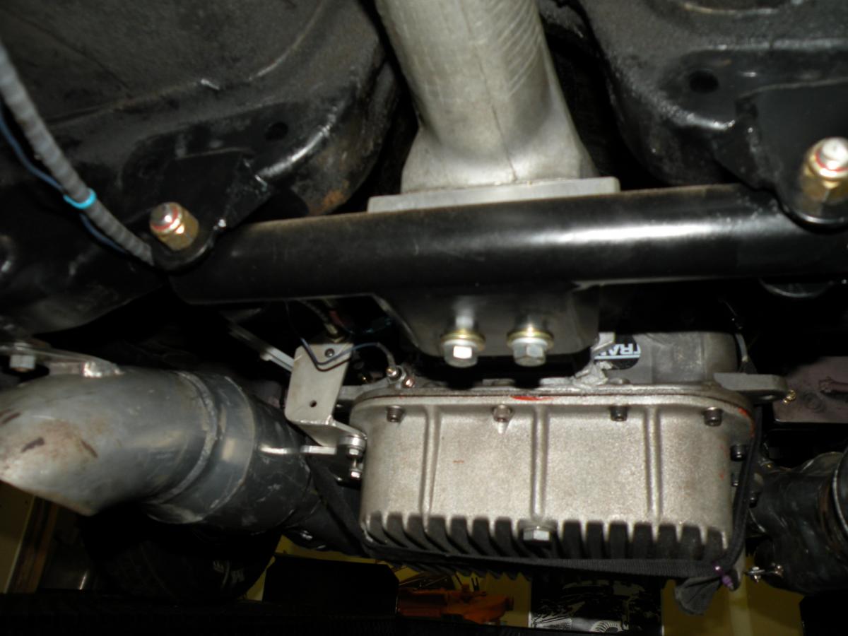

I have the opportunity today to put in the new Neal Chance Torqueflite Converter. I went with a 9" 6700 stall.
Never so easy to put in a converter and trans. before. C & F chassis made me a nice 25.5 trans. crossmember and installation was a breeze. Just need 3 more converter bolts to put in and it's finished.

I can't wait to see what she runs.I would like to see some pics of the crossmember.
i'LL HAVE THOSE PICTURES TOMORROW of the trans. crossmember.. RAN OUT OF TIME BUT I'M PRETTY MUCH DONE RETIGHTEN the header bolts add fuel and charging up the battery.
all converter bolts and linkage done.
No hurry,getting it done and on the track is more important.I am just always looking for new ideas.
MOPARPOOR heres a shot for ya.
spent the afternoon fine tuning the black dodge. it's testing time. its all done.
Thanx for the pics.The trans member is nice and simple,the way it should be.Who's front end stuff are you running.The two bolt set up is nice,no more four inch bolts that start to turn into u bolts to fish out.That and its small and opens up space.
