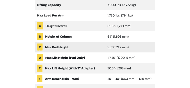

What about MaxJack? With 3” extensions the max lift is 50.50”. The top package includes this chair creeper.

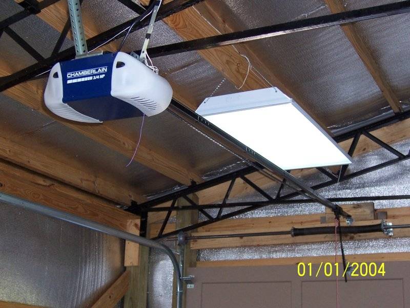

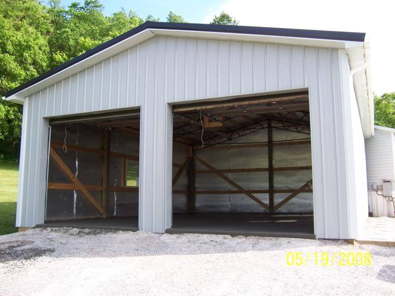

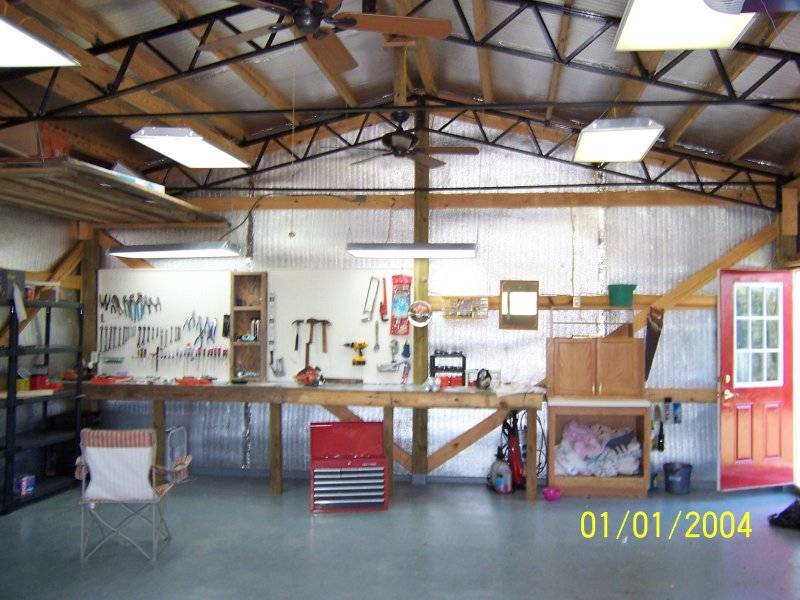

Ed , what direction do your trusses run ?
Just thinking out loud.
The horizontal stringer ell-beam that goes across at each column is the killer height-wise....
The door opener would be yet another casualty to buy some height as well...

Sorry Ed I have no experience with MaxJack except reading about them, years ago, while spinning wrenches on the concrete floor on my back in my old garage. But I did just read they have a new unit capable of 7000lbs. I would take that as more stable and safe for our vehicles.

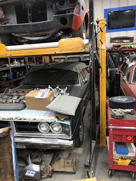

My dream garage luckily and maybe just in the nick of time came to be recently with a full size 2-post lift.
Looks to me like you have more than enough height with the way it's designed and built....just those roll up doors are what is going to limit you I think.
How deep is your garage? Any chance you can shift the lift deeper into the stall so Fred's roof winds up past the roof truss?
As far as the garage door opener, I've seen double garage doors tied together with a steel bar & a single opener winds up mounted centered between them
